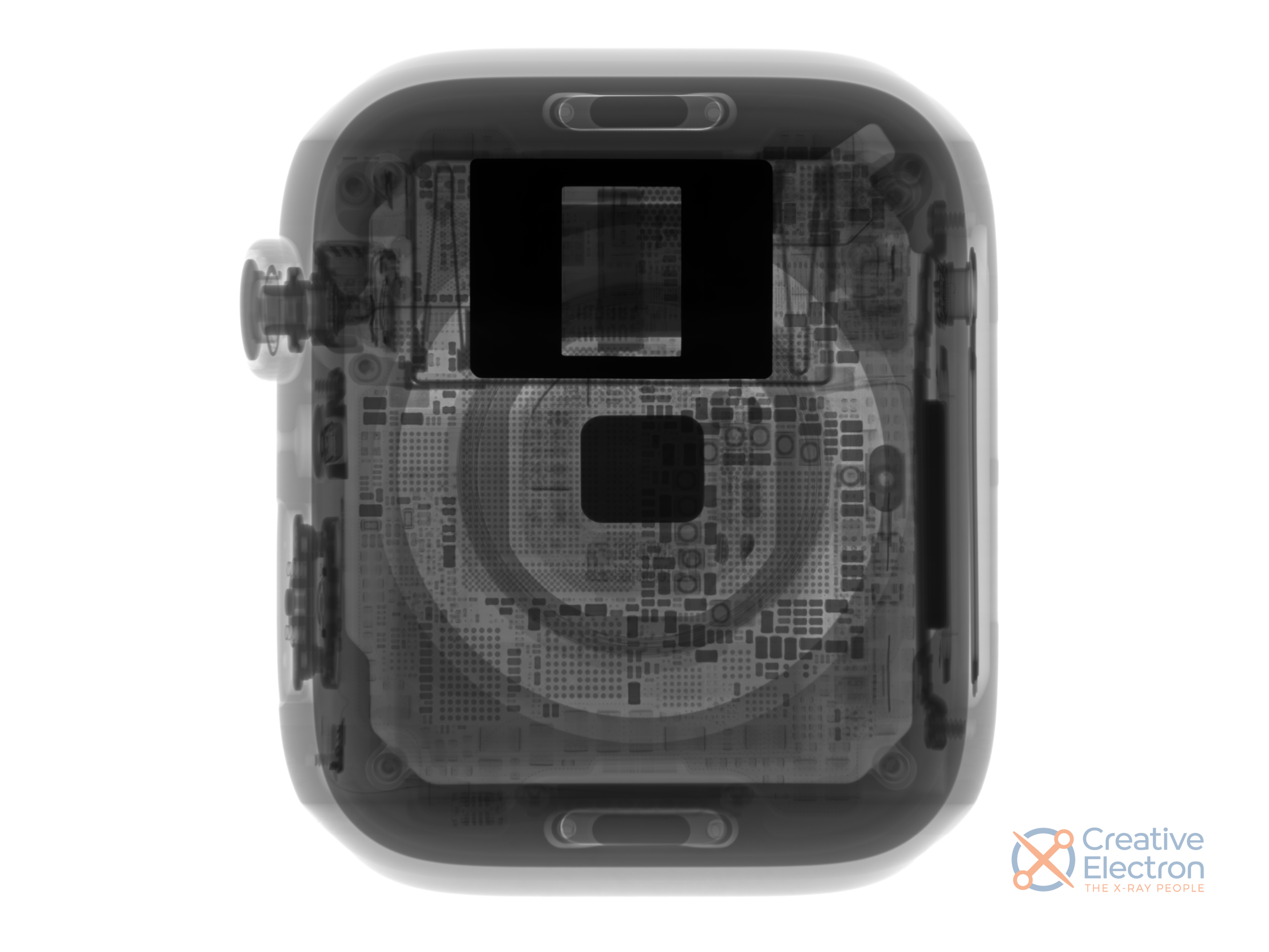

While they simmered, we huddled with Creative Electron for the usual X-ray treatment. (Compare last year’s X-ray from our Series 6 teardown.)
An X-ray view of the 45 mm Apple Watch Series 7, cellular model—courtesy of Creative Electron
