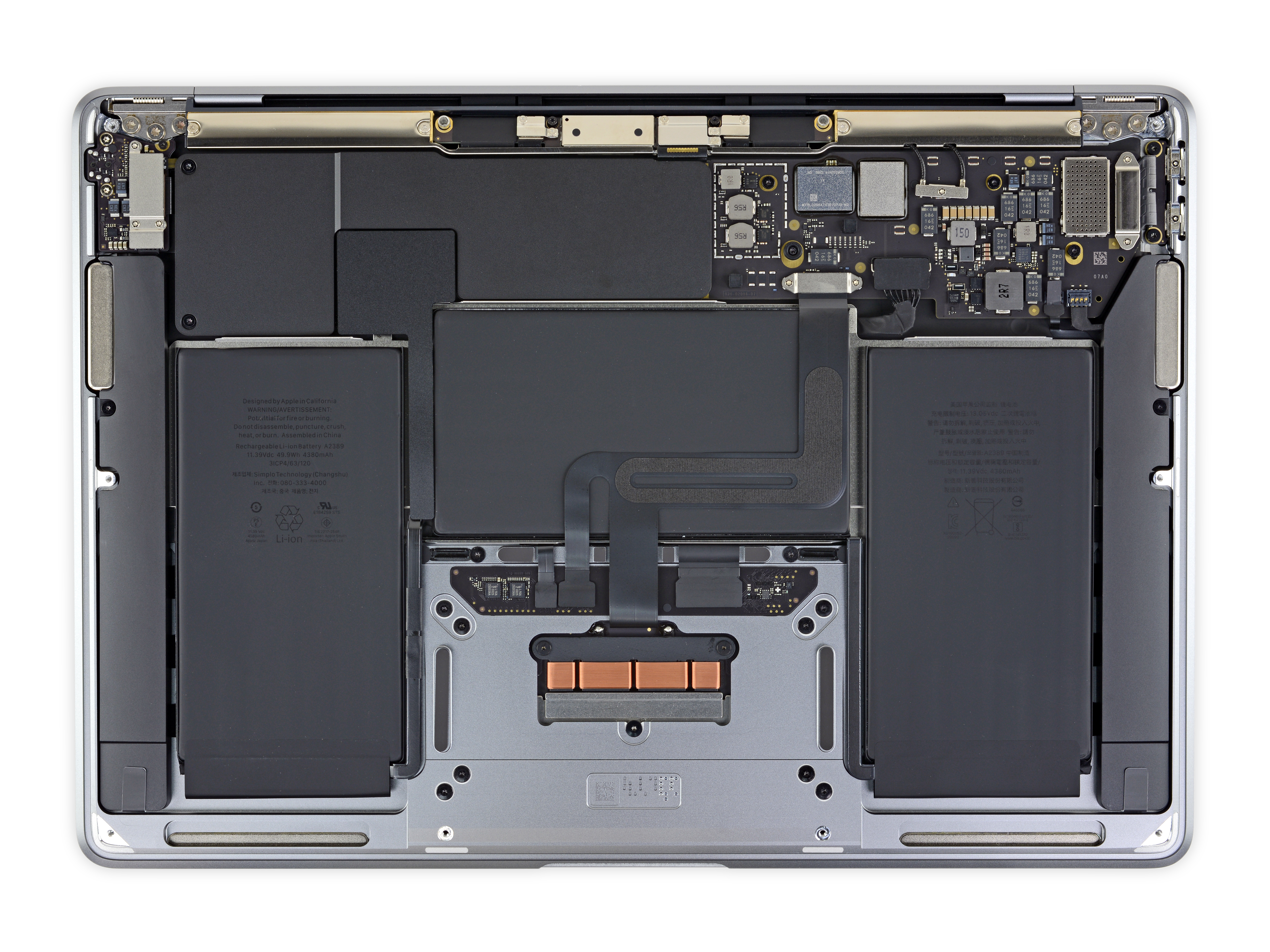

The biggest physical change to either of these machines is also the punniest: The Air no longer actively moves air. In what a pessimist might describe as pulling a Microsoft, Apple nixed the fan in favor of a simple aluminum heat spreader hanging off the left edge of the logic board.
If that move has you groaning slightly, we understand. Recent history arguably warrants a little pessimism here. The Air hasn’t had the best track record with thermals—it was starting to gain a reputation—and the cooling solutions in some other Apple notebooks are famously anemic. So you might worry that the fan is the new headphone jack, an inevitable victim of designers obsessed with slim, light slabs and minimaluminiumalism.
But there’s something to be said for the fanless simplicity of the iPad (Apple’s other computer). If this new thermal arrangement is truly enough to meet the M1’s needs—and early reviews indicate that for most workloads, it is—it means less maintenance and one less point of mechanical failure. Will anyone actually miss having to open their laptop to de-gunk or replace a dusty old fan? Maybe somebody will. Maybe even us. But let’s be real: the best repair is the one you never have to make in the first place.
There’s just not much to go wrong here. A thick cold plate over the M1 processor draws heat via conduction to its flatter, cooler end, where it can safely radiate away. Without a fan, this solution may take longer to cool off, and may cap out sooner, but by foregoing heatpipes or a vapor chamber, the sink also has more mass to saturate with thermal energy. There are no moving parts, and nothing to break. You’ll want new thermal paste occasionally, and that’s about it.
Apart from the new board and cooler, the rest of the Air remains all but identical to its predecessor. There’s a new battery model, with minimally different specs. The repair procedures will likely remain almost totally unchanged. As for the board and the M1 itself, more on that below.

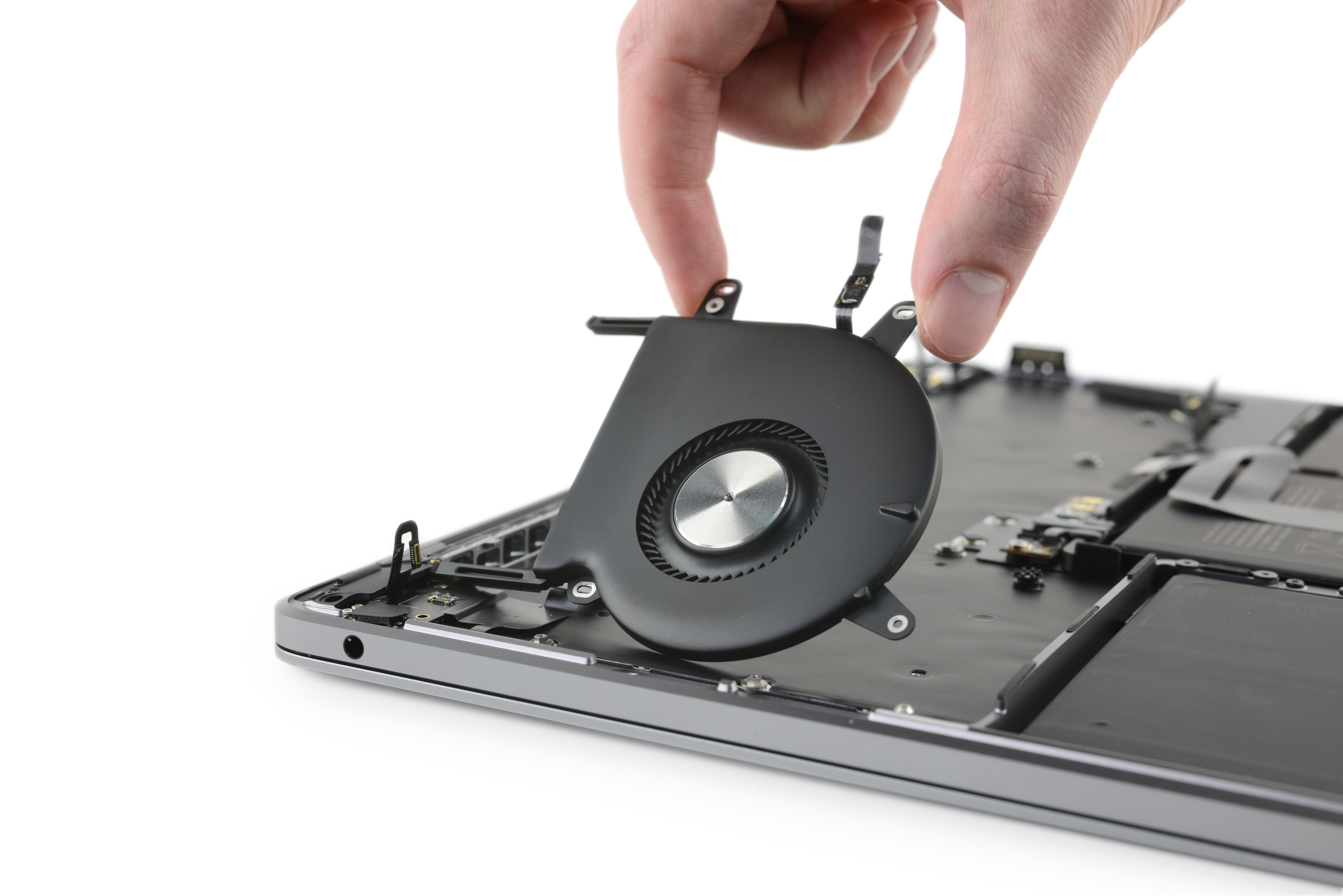

But the two-port MacBook Pro and the new MacBook Air still hail from completely different evolutionary lines. Nowhere is that more apparent than in the Pro’s familiar thermal design. The M1 MacBook Pro’s cooling setup is very similar to that of its Intel-based ancestors: nothing fancy, just a copper heat pipe carrying heat away from the processor toward a small heatsink, where the hot air is promptly shown the door grille by the fan.

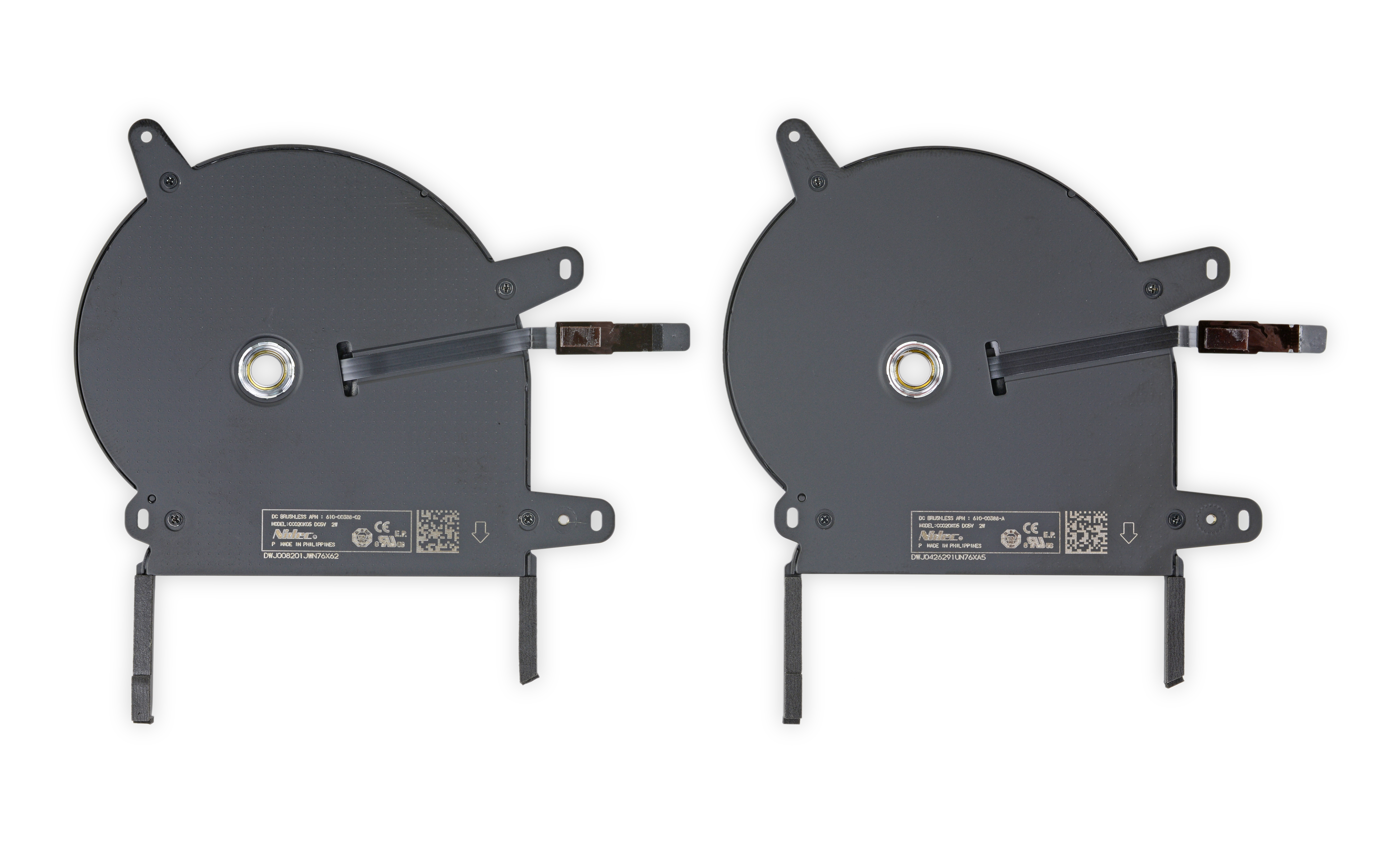

Speaking of the fan, there has been some light speculation that these new machines run so impossibly quiet even under heavy load, they might be concealing some nigh-magical new cooling tech. It turns out, not so much: our M1 MacBook Pro’s single fan is identical to the fan in the two-port Intel MacBook Pro 2020 we picked up earlier this year. Not similar—identical.
In other words, what you’re not hearing there is the sound of an aggressive fan curve. This thing likely never spins at more than a fraction of its upper limit. Remember, this same M1 chip performs well in the fanless MacBook Air, so this fan likely doesn’t have all that much to do even under extended load. The M1 is, apparently, just that good.

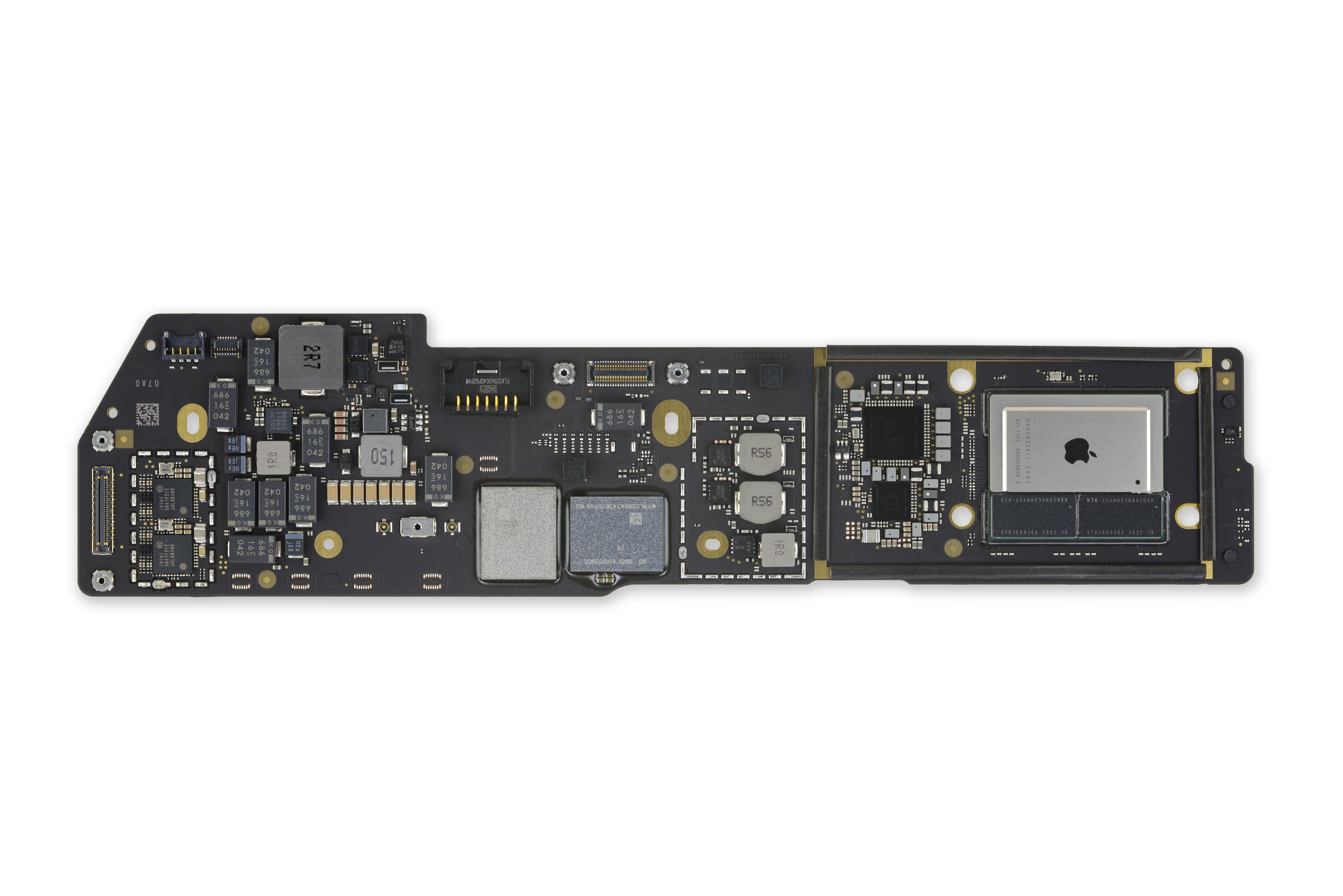

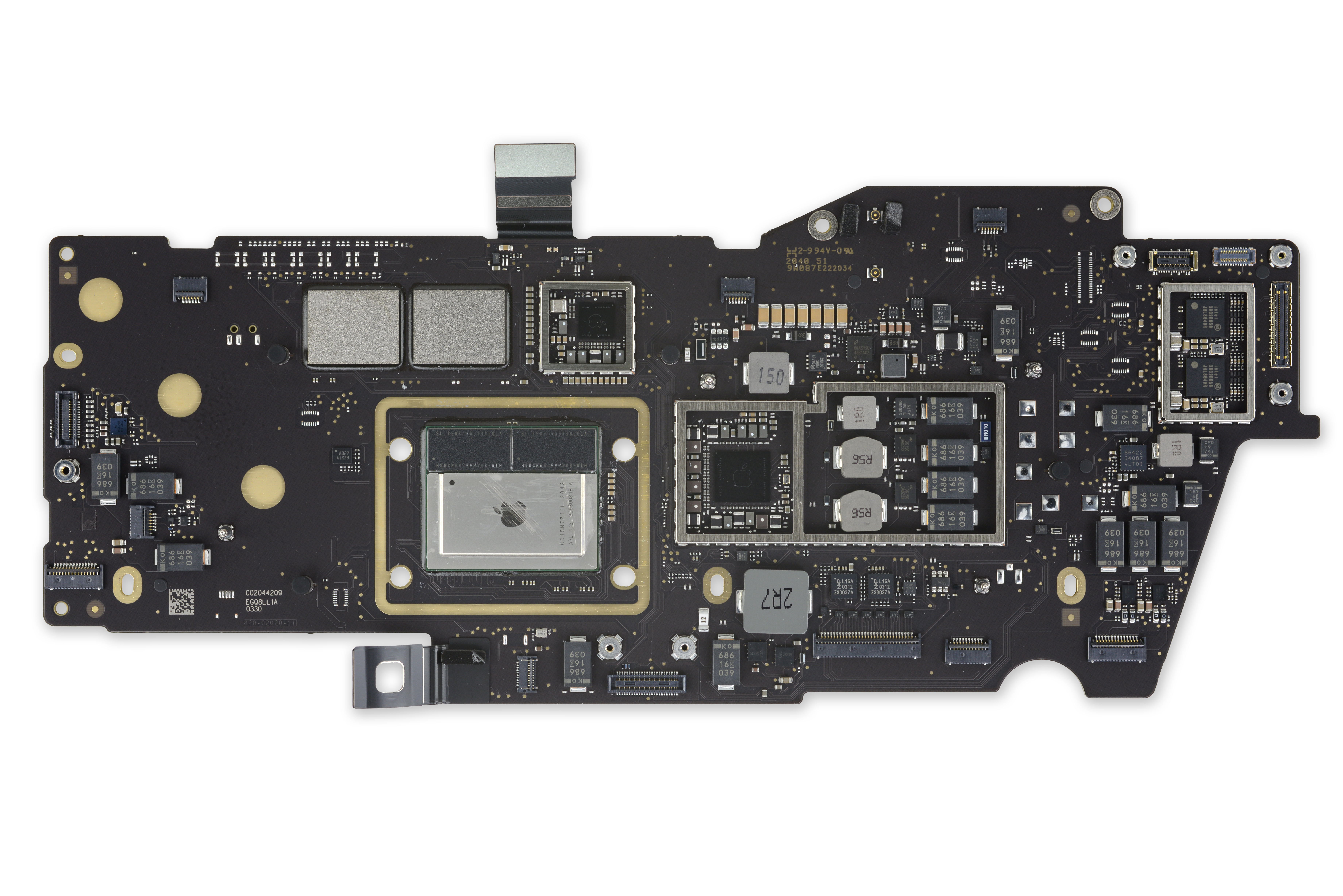

Speaking of which, here’s the thing you came here to see: the brand-new M1 package at the heart of both these notebooks.
Apple gave its M1 SoC a very thorough introduction during their keynote on the 10th. Here’s the short version: The M1 is built on a cutting-edge 5-nanometer process (5 nm = smaller transistors for more performance with less energy), like the A14 Bionic in the new iPhones. It packs eight CPU cores (four optimized for performance, and four more for efficiency), and an integrated GPU with either 7 cores or 8, depending on which config you order. (Both use the same M1 chip off the exact same production line, but Apple sorts them in a process known as “binning” where slightly lower-quality silicon results in one GPU core being disabled.)
Next to the shiny silver M1 chip on each board you’ll notice two small black rectangles. Those are the new “integrated” memory chips: 8 GB (2x 4 GB) of SK hynix LPDDR4X memory. Apple calls this UMA, or Unified Memory Architecture. If it looks familiar, it might be because you’ve seen one of our recent iPad teardowns. It’s no surprise that Apple copied some of its own homework here. By baking RAM into the M1 package, each part of M1 (CPU, GPU, Neural Engine, etc) can access the same memory pool without having to copy or cache the data in more than one place.

Here’s the complete roster of chips we found in both these machines:
- Apple M1 SoC (Main die + 2x Hynix 4GB LPDDR4X 4266 MHz ICs)
- Intel JHL8040R Thunderbolt 4 Retimer (x2) (basically a Thunderbolt 4 extender/repeater)
- (Western Digital/SanDisk?) SDRGJHI4 – 128GB Flash storage (x2)
- Apple 1096 & 1097 – Likely PMICs
- Texas Instruments CD3217B12 – USB and power delivery IC
- Apple USI 339S00758 – Wi-Fi 6/Bluetooth 5.0 module
- Winbond Q64JWUU10 – 64 Mb serial flash memory
- Renesas 501CR0B
- Intersil 9240H1 (also seen in 2019 MBP 13”)
- National Semiconductor 4881A07
- Siliconix 7655 – 40A battery MOSFET
In terms of differences between the two boards, we noted the Pro comes with a beefier power phase design and a couple extra I/O expander chips, as well as storage chips from Kioxia (formerly Toshiba):
- NXP PCAL6416AHF (marked L16A) – I2C/SMB I/O expander (x2)
- Kioxia KICM232 VD6303 CHNA1 2029 flash storage
