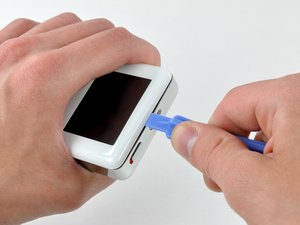

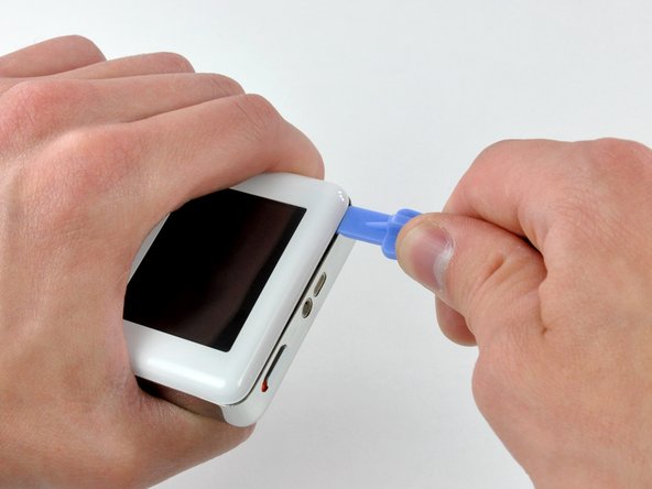

Image 1/2: Insert a large iPod opening tool into the seam between the plastic front and metal rear panel of the iPod, near the headphone jack. The tool's edge should point towards the metal rear panel to prevent any accidental scratching of the plastic front.
  • Opening the iPod can be challenging. Don't get discouraged if it takes you a few tries before the iPod is opened.
  • Insert a large iPod opening tool into the seam between the plastic front and metal rear panel of the iPod, near the headphone jack. The tool's edge should point towards the metal rear panel to prevent any accidental scratching of the plastic front.
  • Run the tool along the top seam toward the upper left corner of the iPod. Press the tool into the corner, creating a small gap on the side of the case.
The plastic prying tools are pretty useless, but a 9/64-inch jewellers' screwdriver will pop the case very easily.
Human - Reply
Hardest part is step 2. The tools supplied in the kit don't seem to be able to pry the edge of the case. Like others I used a short blade knife, be very careful, to get the case opening started and used the iFixit tools to wedge the case open. Managed to scratch the silver case a bit near the top RH corner but that's the only damage. The rest of the process went smoothly and it went back together and I now have a working iPod for music in my garage. :-)
mmelocco - Reply

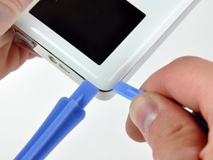

  • Push the large iPod opening tool into the upper left corner of the iPod, creating a small gap along the side seam.
Image 1/2: With the large iPod opening tool still inserted in the top seam, press a small iPod opening tool into the gap you just created.
  • There are five retaining tabs on each side of the iPod.
  • With the large iPod opening tool still inserted in the top seam, press a small iPod opening tool into the gap you just created.
  • Run the iPod opening tool down the side seam, releasing all five tabs.
  • It may be necessary to wiggle the tool while working your way down the seam to free all the tabs.

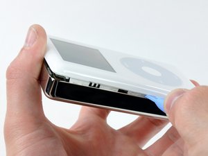

  • Run the iPod opening tool around the lower right corner and slide it down the right side seam to free the five tabs holding the iPod together. You may be able to free the tabs by gently wiggling the front panel of the iPod.
Image 1/1: Open the case like a book with the dock connector edge at the top, and lay the rear panel next to the front half of the iPod.
  • The iPod case is now open, but don't separate the two halves just yet. There is still an orange ribbon cable connecting the headphone jack to the logic board.
  • Open the case like a book with the dock connector edge at the top, and lay the rear panel next to the front half of the iPod.

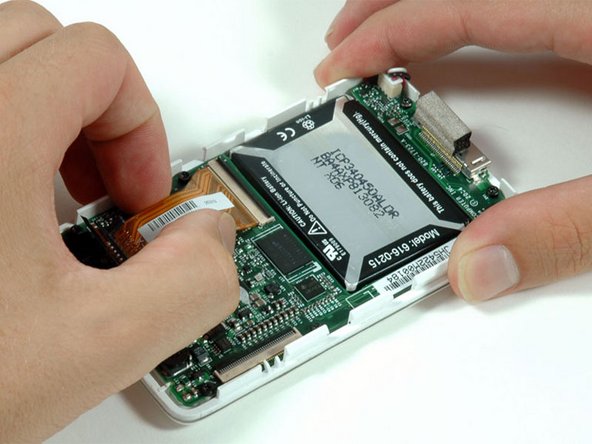

Image 1/1: If the cable doesn't come free easily, it may be helpful to gently wiggle the cable from side to side.
  • Grasp the hard drive with one hand and carefully disconnect the orange ribbon cable from the hard drive using your other hand.
  • If the cable doesn't come free easily, it may be helpful to gently wiggle the cable from side to side.
Note carefully how the orange ribbon cable is connected, as there are more holes than pins (at least on my hard drive) which makes it a little tricky to put it back correctly. Not that difficult, but I had to do it twice...
osset - Reply

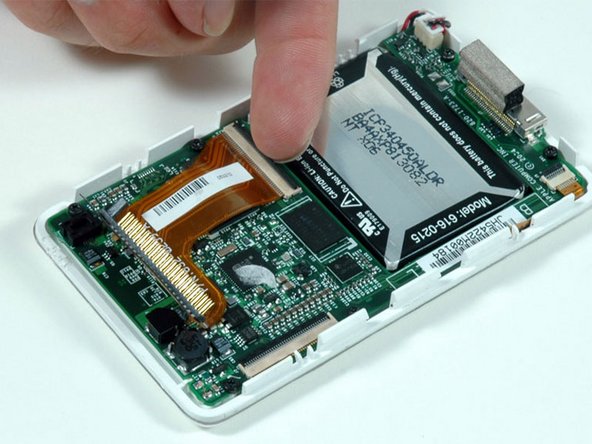

  • Peel up the black adhesive strip covering the hard drive ribbon cable.
Image 1/1:
  • Use the tip of your finger or a spudger to carefully flip up the black connector securing the hard drive cable to the logic board. Note that the black retaining clip flips 90 degrees toward vertical, in the direction of the cable.
Hi. My ipod doesn't have a clip retaining the ribbon. How is mine held in place? I can't see how it would have been held in place. Your help is required.
Spencer - Reply
Image 1/1:
  • Pull the orange hard drive cable directly out of its connector.
8 other people completed this guide.
One Comment
My ipod 4th gen does not have the little flap on the cable/logic board. Any ideas how to re-attach?
nick - Reply
