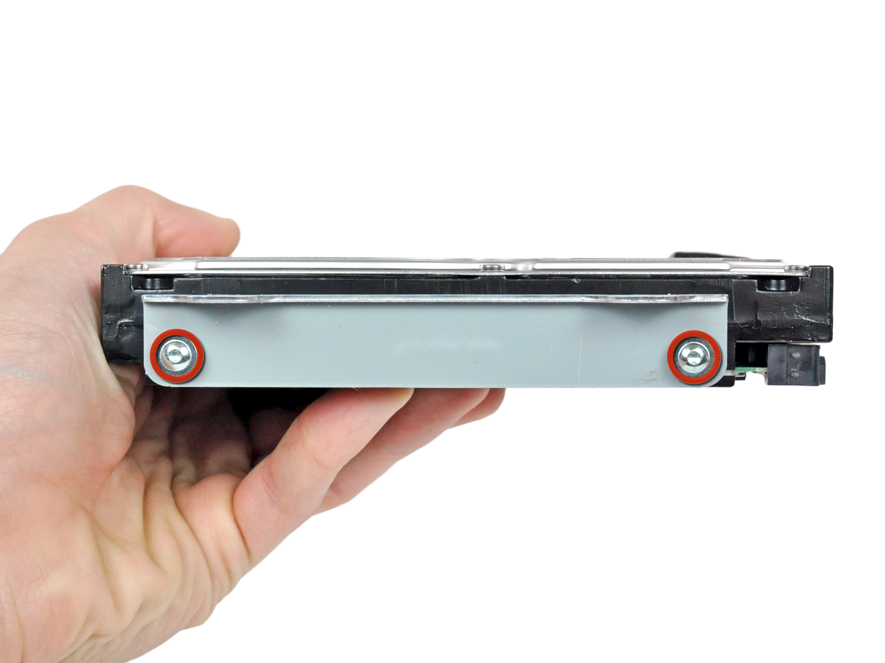

Remove the two 12 mm shouldered T8 Torx screws holding the hard drive bracket to the connector side of the hard drive. After removing these two screws, the bracket will fall away from the hard drive.
  • Remove the two 12 mm shouldered T8 Torx screws holding the hard drive bracket to the connector side of the hard drive.
  • After removing these two screws, the bracket will fall away from the hard drive.
