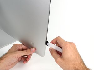

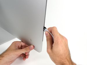

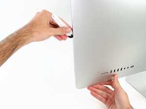

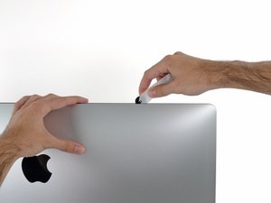

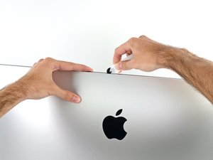

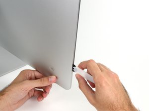

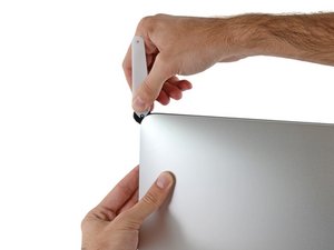

  2. iMac Intel 27" EMC 2639 Hard Drive Replacement: step 2, image 1 of 3 iMac Intel 27" EMC 2639 Hard Drive Replacement: step 2, image 2 of 3 iMac Intel 27" EMC 2639 Hard Drive Replacement: step 2, image 3 of 3

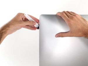

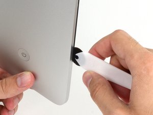

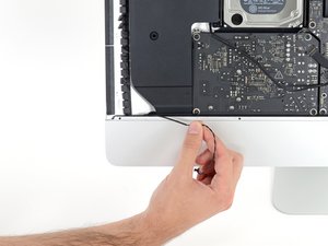

    • Starting on the left of the display, near the power button, insert the iMac Opening Tool into the gap between the glass panel and the rear case.
    • The hub on the iMac Opening Tool will keep you from pushing the wheel in too far. If using a different tool, insert no more than 3/8" (9.5 mm) into the display. You risk severing antenna cables and causing serious damage.
  3. iMac Intel 27" EMC 2639 Hard Drive Replacement: step 3, image 1 of 3 iMac Intel 27" EMC 2639 Hard Drive Replacement: step 3, image 2 of 3 iMac Intel 27" EMC 2639 Hard Drive Replacement: step 3, image 3 of 3
    • Use the tool like a pizza cutter—roll it along through the gap, and it will cut the foam adhesive through the center.
    • Be sure to always push with the handle behind the cutting wheel. If you pull, the wheel might get pulled out of the handle.
    • Run the tool up along the left side of the display.

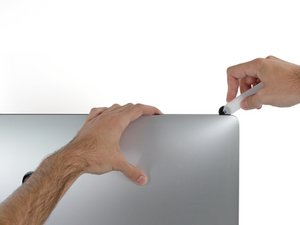

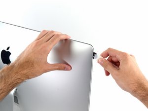

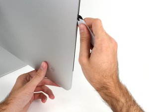

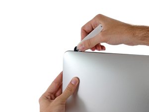

  4. iMac Intel 27" EMC 2639 Hard Drive Replacement: step 4, image 1 of 3 iMac Intel 27" EMC 2639 Hard Drive Replacement: step 4, image 2 of 3 iMac Intel 27" EMC 2639 Hard Drive Replacement: step 4, image 3 of 3
    • Continue wheeling the tool up around the top left corner.

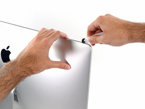

  5. iMac Intel 27" EMC 2639 Hard Drive Replacement: step 5, image 1 of 2 iMac Intel 27" EMC 2639 Hard Drive Replacement: step 5, image 2 of 2
    • Cut the adhesive along the top left of the display.

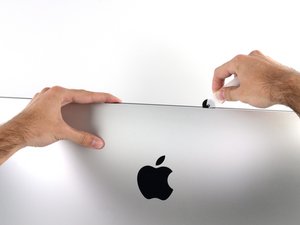

  6. iMac Intel 27" EMC 2639 Hard Drive Replacement: step 6, image 1 of 2 iMac Intel 27" EMC 2639 Hard Drive Replacement: step 6, image 2 of 2
    • Continue along the top of the display.
    • You may want to run the tool back and forth through what you've already cut a few times, to ensure you get as much of the adhesive separated as possible.

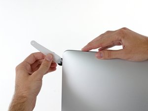

  7. iMac Intel 27" EMC 2639 Hard Drive Replacement: step 7, image 1 of 3 iMac Intel 27" EMC 2639 Hard Drive Replacement: step 7, image 2 of 3 iMac Intel 27" EMC 2639 Hard Drive Replacement: step 7, image 3 of 3
    • Push the tool around the top right corner of the display.

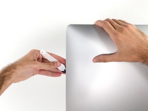

  8. iMac Intel 27" EMC 2639 Hard Drive Replacement: step 8, image 1 of 2 iMac Intel 27" EMC 2639 Hard Drive Replacement: step 8, image 2 of 2

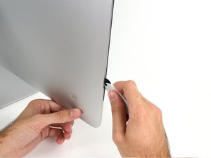

    • Wheel the tool down along the right side of the display.
  9. iMac Intel 27" EMC 2639 Hard Drive Replacement: step 9, image 1 of 2 iMac Intel 27" EMC 2639 Hard Drive Replacement: step 9, image 2 of 2
    • Finish pushing the opening tool to the bottom of the right side of the display.
    • At this point, you'll want to run the tool back around the entire display, to ensure you cut as much adhesive as possible.

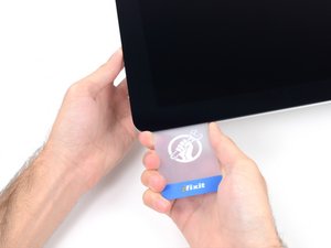

    • While the opening tool did the lion's share of the work, the display will still be slightly adhered to the case. A plastic card will be necessary to free up the last of this adhesive.

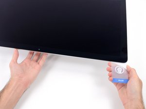

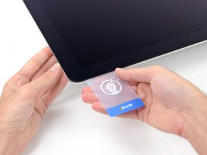

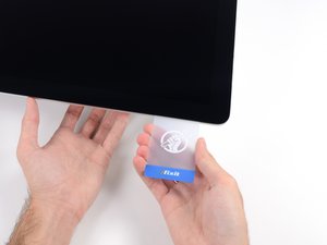

    • Set the iMac face-up on a table.
    • Starting from the top right corner of the iMac, insert a plastic card between the display and frame.
    • Be careful not to insert it more than 3/8" (9.5 mm), or you may damage internal components.

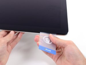

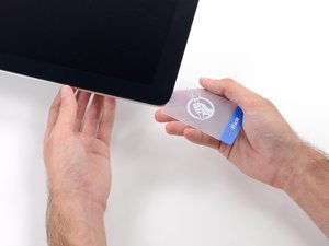

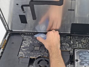

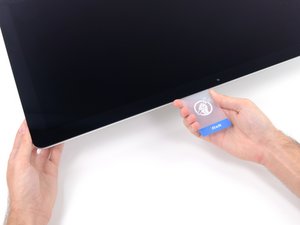

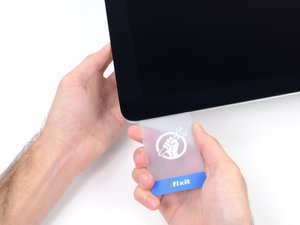

  11. iMac Intel 27" EMC 2639 Hard Drive Replacement: step 11, image 1 of 2 iMac Intel 27" EMC 2639 Hard Drive Replacement: step 11, image 2 of 2
    • Gently twist the plastic card to open the space between the display and frame, and cut any remaining adhesive near the corner.
    • Using too much force will crack the glass. Work carefully, and don't try to create a gap any larger than about 1/4" (6 mm).
  12. iMac Intel 27" EMC 2639 Hard Drive Replacement: step 12, image 1 of 3 iMac Intel 27" EMC 2639 Hard Drive Replacement: step 12, image 2 of 3 iMac Intel 27" EMC 2639 Hard Drive Replacement: step 12, image 3 of 3
    • Be sure to stop cutting before the iSight camera in this step, or you may damage it.
    • Slide the card toward the center of the display, to cut any remaining adhesive.

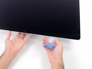

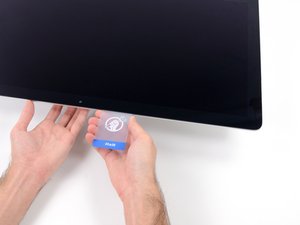

  13. iMac Intel 27" EMC 2639 Hard Drive Replacement: step 13, image 1 of 2 iMac Intel 27" EMC 2639 Hard Drive Replacement: step 13, image 2 of 2
    • Put the card into the corner again and let it stay there to keep the adhesive from resettling.

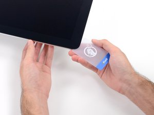

  14. iMac Intel 27" EMC 2639 Hard Drive Replacement: step 14, image 1 of 3 iMac Intel 27" EMC 2639 Hard Drive Replacement: step 14, image 2 of 3 iMac Intel 27" EMC 2639 Hard Drive Replacement: step 14, image 3 of 3
    • Insert a second card into the gap between the display and frame in the top left corner.
  15. iMac Intel 27" EMC 2639 Hard Drive Replacement: step 15, image 1 of 2 iMac Intel 27" EMC 2639 Hard Drive Replacement: step 15, image 2 of 2
    • Gently twist the card, slightly increasing the space between the display and frame.
    • As with the other side, move slowly to allow the adhesive to break, and be careful not to over-stress the display glass.

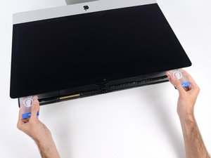

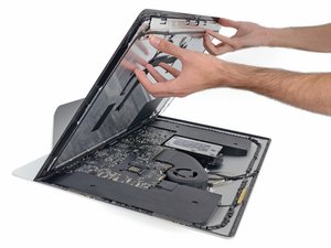

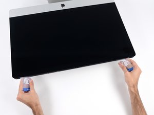

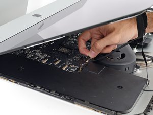

    • Only lift the display a few inches—it is still attached to the iMac by data and power cables.
    • With the cards inserted as shown near the corners, gently twist the cards to increase the gap between display and case.
    • If there are any sections that seem to stick and won't separate, stop twisting and use one of the cards to cut the adhesive in the problem area.
    • Begin to lift the top of the display up from the frame.

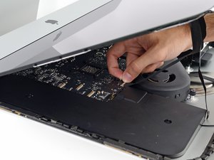

  19. iMac Intel 27" EMC 2639 Hard Drive Replacement: step 19, image 1 of 2 iMac Intel 27" EMC 2639 Hard Drive Replacement: step 19, image 2 of 2

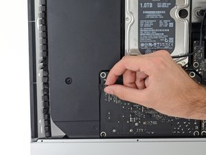

    • While holding the display up with one hand, use the other to unplug the display power cable.
    • Lift the display up enough to have easy access to the connections, but not so much that you stretch the cables and stress their connections (about 8").

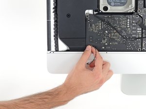

  20. iMac Intel 27" EMC 2639 Hard Drive Replacement: step 20, image 1 of 3 iMac Intel 27" EMC 2639 Hard Drive Replacement: step 20, image 2 of 3 iMac Intel 27" EMC 2639 Hard Drive Replacement: step 20, image 3 of 3
    • Flip up the metal retaining bracket on the display data cable.
    • Disconnect the display data cable.
    • This is a delicate connection that can easily be broken. Be sure to pull the display data cable connector straight out of its socket, toward the top of the iMac.

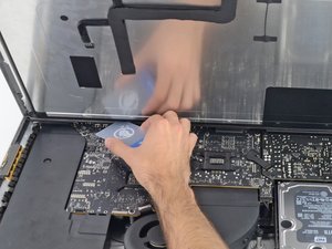

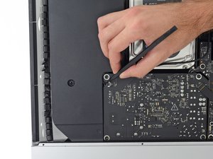

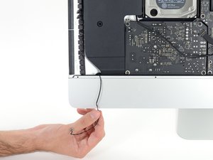

  22. iMac Intel 27" EMC 2639 Hard Drive Replacement: step 22, image 1 of 3 iMac Intel 27" EMC 2639 Hard Drive Replacement: step 22, image 2 of 3 iMac Intel 27" EMC 2639 Hard Drive Replacement: step 22, image 3 of 3

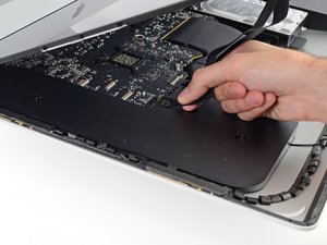

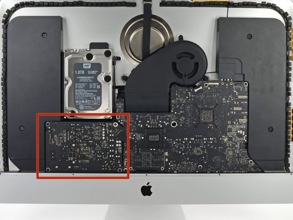

    • Be very careful not to touch the capacitor leads or any exposed solder joints on the back of the power supply (boxed in red).
    • If necessary, a plastic card can be used to cut any remaining sections of the bottom adhesive strip.

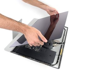

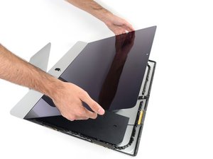

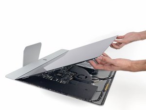

  23. iMac Intel 27" EMC 2639 Hard Drive Replacement: step 23, image 1 of 3 iMac Intel 27" EMC 2639 Hard Drive Replacement: step 23, image 2 of 3 iMac Intel 27" EMC 2639 Hard Drive Replacement: step 23, image 3 of 3
    • Be very careful handling the display—it's big, heavy, and made of glass. The display has fragile edges. Avoid lifting the display by the corners.
    • Lift the display up from the frame and remove it from the iMac. Lay the display face down on a flat, soft surface.
    • It may be necessary to slowly lift from one side, to peel against the remaining adhesive.
    • After the adhesive is cut, it cannot be used to re-seal the display in place. Follow this guide when your repair is complete to replace the adhesive strips that secure the display to the rear enclosure.

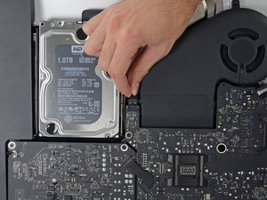

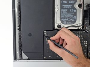

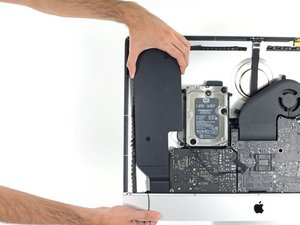

  25. iMac Intel 27" EMC 2639 Hard Drive Replacement, iMac Intel Speaker Displacement for HDD Guides: step 25, image 1 of 1

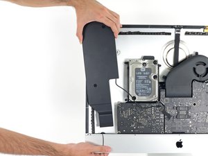

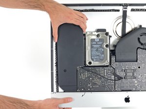

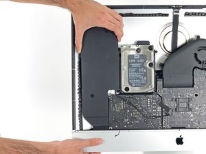

    • Use a T10 driver to remove the two 10 mm screws securing the left speaker.

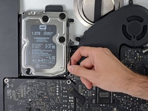

  26. iMac Intel 27" EMC 2639 Hard Drive Replacement: step 26, image 1 of 2 iMac Intel 27" EMC 2639 Hard Drive Replacement: step 26, image 2 of 2
    • Shift the loosened left speaker to the left—enough to uncover the hard drive bracket screws.
  27. iMac Intel 27" EMC 2639 Hard Drive Replacement: step 27, image 1 of 2 iMac Intel 27" EMC 2639 Hard Drive Replacement: step 27, image 2 of 2

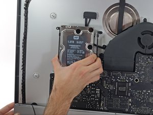

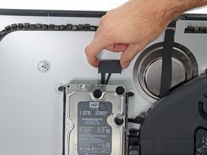

    • Pull straight up on the SATA combo cable to disconnect it from the drive.
  28. iMac Intel 27" EMC 2639 Hard Drive Replacement: step 28, image 1 of 1
    • Use a T8 driver to remove the two 7.3 mm screws securing the left hard drive bracket to the rear case.

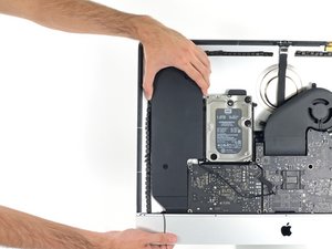

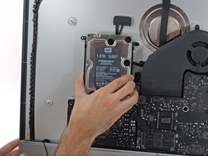

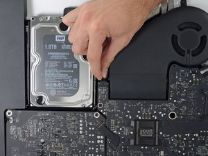

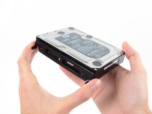

  29. iMac Intel 27" EMC 2639 Hard Drive Replacement: step 29, image 1 of 3 iMac Intel 27" EMC 2639 Hard Drive Replacement: step 29, image 2 of 3 iMac Intel 27" EMC 2639 Hard Drive Replacement: step 29, image 3 of 3
    • Grab the hard drive and left hard drive bracket together.
    • Tilt the left side away from the rear case, and slide the assembly to the left.
    • Remove the hard drive and left hard drive bracket from the iMac.
  30. iMac Intel 27" EMC 2639 Hard Drive Replacement: step 30, image 1 of 2 iMac Intel 27" EMC 2639 Hard Drive Replacement: step 30, image 2 of 2

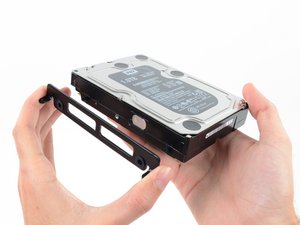

    • Remove the left hard drive bracket.

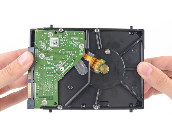

  31. iMac Intel 27" EMC 2639 Hard Drive Replacement, Hard Drive: step 31, image 1 of 1
    • Remove the four 8.1 mm T8 screw posts from the hard drive, and transfer them to the replacement drive enclosure.
