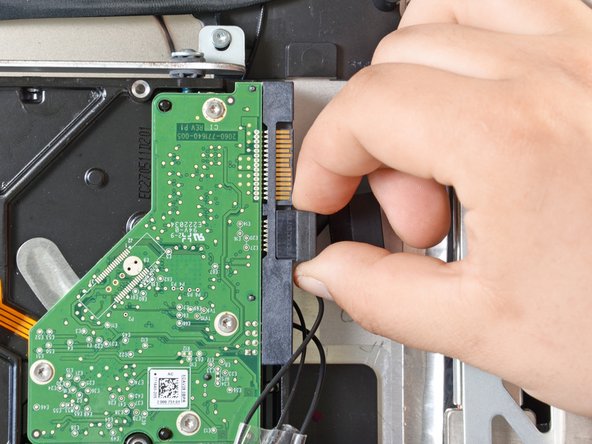

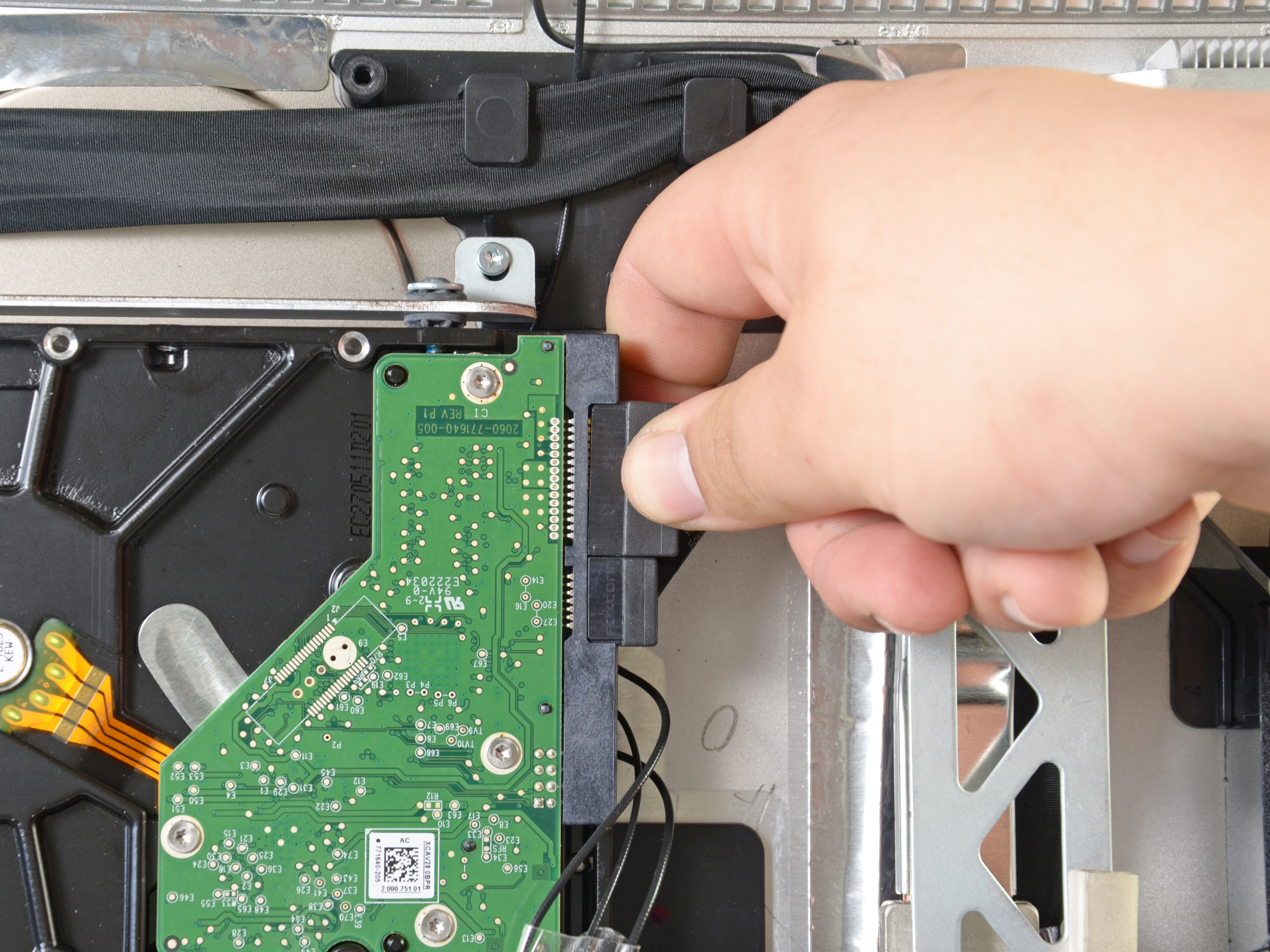

    • Disconnect the SATA power and data cables from the hard drive by pulling them straight away from the hard drive.

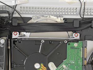

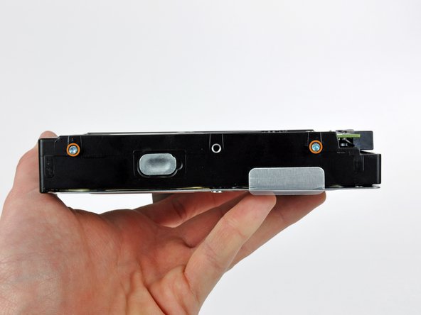

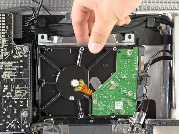

    • Remove the two T10 Torx screws securing the hard drive to the iMac frame.
    • Slightly rotate the top edge of the hard drive away from the outer case.
    • Lift the hard drive off its two lower positioning pins and remove it from the outer case.

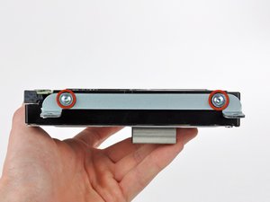

    • Remove the two T8 Torx screws securing the upper bracket to the hard drive.
    • Remove the upper bracket from the hard drive.
    • Remove the two T8 Torx pins from the other side of the hard drive.
