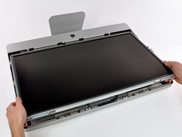

6 Edit Step 2  ¶
Image 1/3: Pull the glass panel away from the lower edge of the iMac and carefully set it aside.
6 Edit Step 2  ¶
  • Gently lift the glass panel perpendicular to the face of the LCD enough to clear the steel mounting pins attached along the underside of the top edge of the glass panel.
  • Pull the glass panel away from the lower edge of the iMac and carefully set it aside.
    • Don't use the suction cups to carry the glass panel—if either one loses its grip, the panel could fall and break.
    • After setting the glass panel down safely, be sure to release the suction cups, as the suction force over time, can crack the glass.
  • During reinstallation, be sure to meticulously clean the inside of the glass panel and the face of the LCD as any dust or fingerprints trapped inside will be annoyingly visible when the machine is turned on.

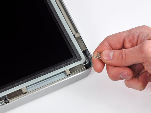

Edit Step 3 Display  ¶
Image 1/1: Be careful not to touch the display as the oil from your fingers may leave a residue that can be difficult to remove.
  • Remove the eight T10 Torx screws securing the LCD to the outer case.
  • Be careful not to touch the display as the oil from your fingers may leave a residue that can be difficult to remove.
  • If necessary, peel the EMI gaskets located near the top center edge of the display assembly.

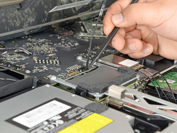

Edit Step 4  ¶

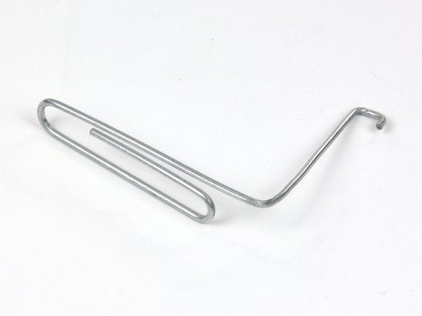

Image 1/3: Due to tight tolerances, you will have to use a thin hooked tool to lift the display out of the outer case. As seen in the first picture, we made one out of a bent paperclip.
Edit Step 4  ¶
  • Carefully lay the iMac stand-side down on a flat surface.
  • Due to tight tolerances, you will have to use a thin hooked tool to lift the display out of the outer case. As seen in the first picture, we made one out of a bent paperclip.
    • Alternatively, our Dual Hard Drive Kit includes a pair of tweezers with an angled tip that are great for this task.
  • Use a thin hooked tool to lift one side of the top edge of the display by its steel outer frame.
  • After lifting the top edge of the display on one side, hold it out of the outer case while you use a hooked tool to lift the other side.
  • Raise and hold the display high enough to access the cables.
  • Do not lift the top edge of the display out of the outer case too far, as several short ribbon cables still connect the two components.

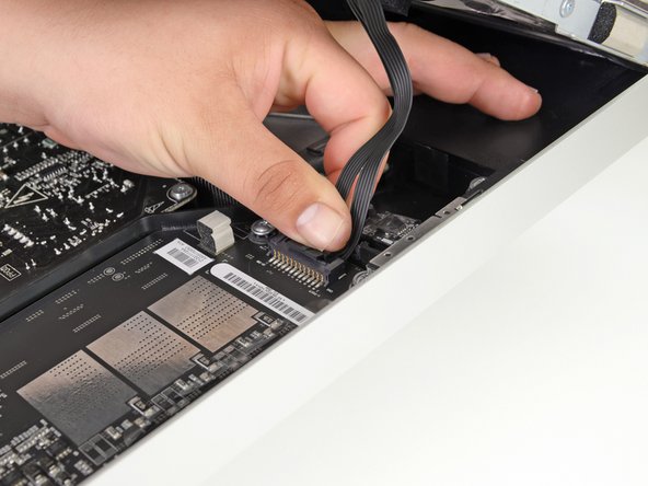

6 Edit Step 7  ¶
Image 1/2: Do not pull up too hard or you will damage the connector and socket.
6 Edit Step 7  ¶
  • Pull the black tab straight up to disconnect the latch on the display data cable ZIF connector.
  • Do not pull up too hard or you will damage the connector and socket.
  • Continue to pull the black tab up toward the top of the device, to detach the display data cable.

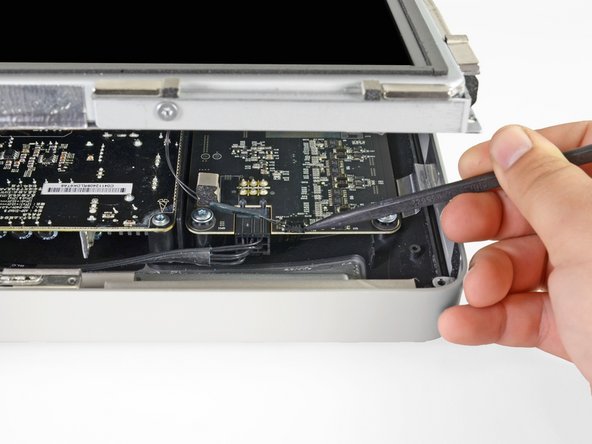

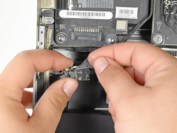

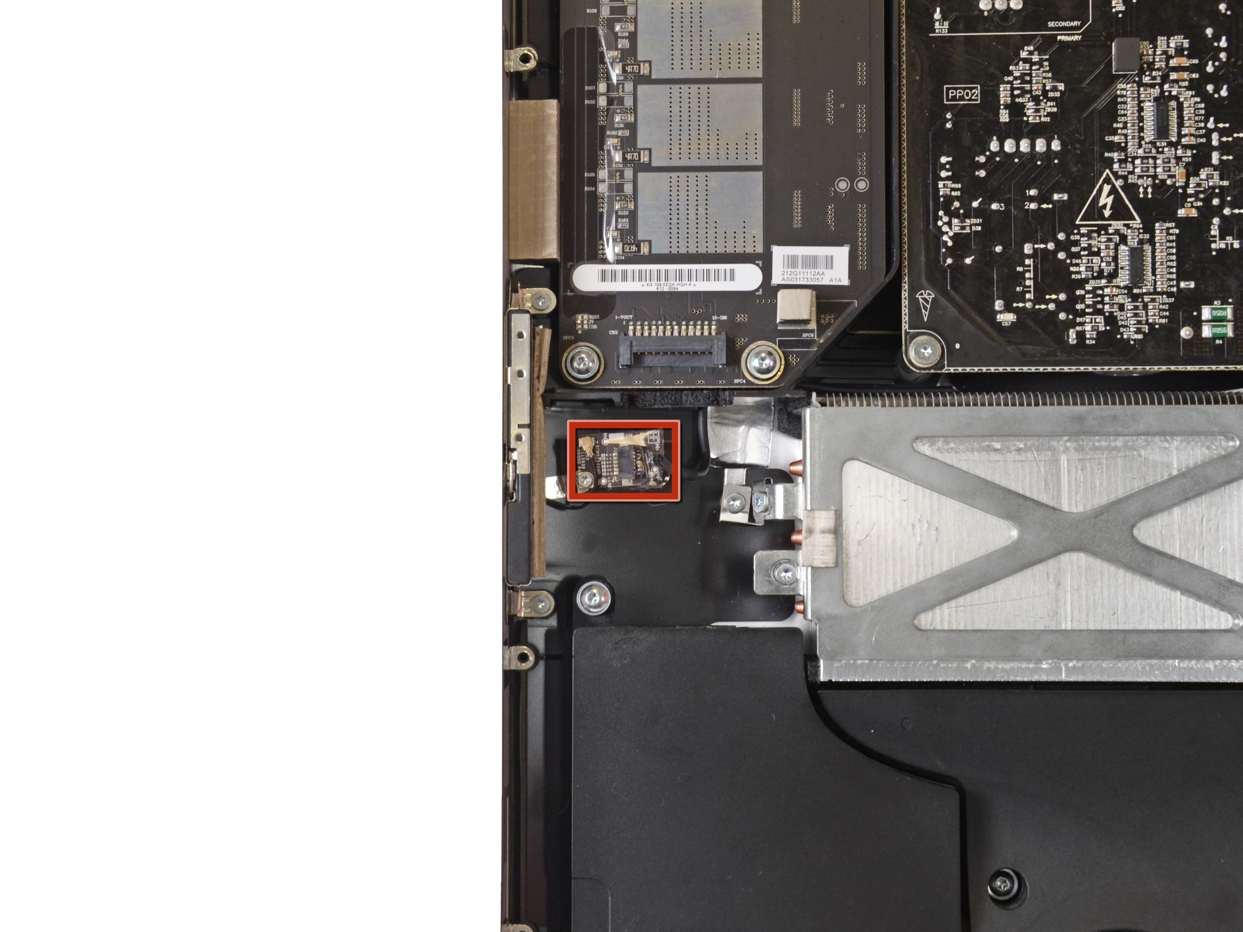

Edit Step 10 Bluetooth Board  ¶
Image 1/2: Use the flat end of a spudger to gently pry the antenna cable off of its socket.
  • The Bluetooth board is located along the left edge of the iMac's case and just below the LED back light driver.
  • Use the flat end of a spudger to gently pry the antenna cable off of its socket.
    • Do not disconnect the antenna by pulling on its cable, as this may damage the antenna or its socket.

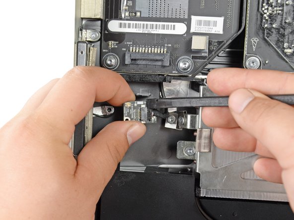

2 Edit Step 11  ¶
Image 1/3: Do not attempt to completely remove the board yet, as it is still attached by a cable.
2 Edit Step 11  ¶
  • Remove the T9 Torx screw securing the Bluetooth board to the case.
    • Do not attempt to completely remove the board yet, as it is still attached by a cable.
  • Remove the tape wrapped around the Bluetooth board, being careful not to put to much tension on the still connected cable.
  • Use the flat end of a spudger to pull the Bluetooth data cable out of its connector and remove the Bluetooth board.

I've managed to break off the fitting in step 6 trying to remove the screen, would anyone know the part to buy or how to fix this?
jonostainsby - Reply
Do step 7 first. The cable is much shorter and more fragile, you'll have more space to remove the other cables if that one is removed first. On my mac, the cable in step 7 was glued down and had to be freed up before I could pull the connecter out of its socket.
