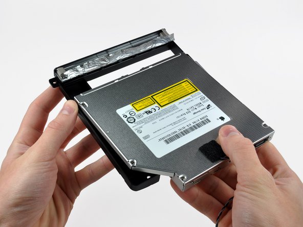

Image 1/2: It is not necessary to peel all of the EMI tape off the optical drive bracket.
  • Peel back the portion of aluminum tape highlighted in red, leaving the rest attached to the black plastic optical drive bracket.
    • It is not necessary to peel all of the EMI tape off the optical drive bracket.
Image 1/2:
  • Remove the two T10 Torx screws from each side of the optical drive (four screws total).
Image 1/3: Rotate the optical drive bracket slightly away from the optical drive.
  • Use the tip of a spudger to press each of the optical drive bracket tabs out of their slots on the bottom of the optical drive.
  • Rotate the optical drive bracket slightly away from the optical drive.
  • Pull the optical drive bracket away from the open end of the optical drive, minding any tabs that may get caught.
Image 1/2: Use the flat end of a spudger to carefully pry the thermal sensor up off the adhesive securing it to the optical drive.
  • Use the tip of a spudger to peel back the piece of foam tape covering the optical drive thermal sensor.
  • Use the flat end of a spudger to carefully pry the thermal sensor up off the adhesive securing it to the optical drive.
  • If you have a disc or anything else stuck inside your optical drive, we have a guide to fix it.
Do I have to reattach the optical drive thermal sensor to the SSD?
Ignatius Lee - Reply
Yes, just stick it onto the SSD and cover it with the buffer. Better than leaving it loose in the computer, or worse omitting it altogether.
