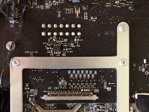

Image 1/1: Pull the display data cable connector away from its socket on the logic board.
  • Squeeze the two display data cable connector arms together to unlock it from its socket on the logic board.
  • Pull the display data cable connector away from its socket on the logic board.
This connection is very fragile, and many people have broken the display connector on the logic board. You need to carefully pull the connector out, and when putting it back together, you need to carefully push the connector back in.
pmah - Reply
i did break mine. do you know where to buy that component?
Cris - Reply

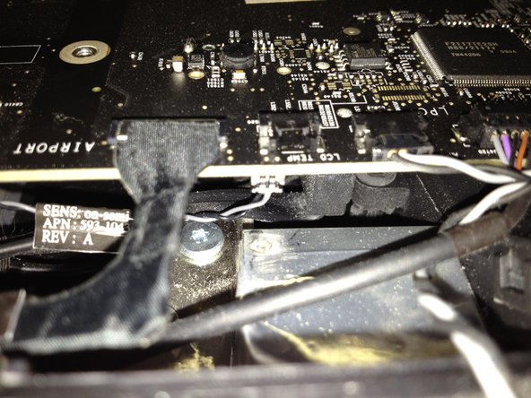

Image 1/1: If your fan is spinning full speed after completion, check this connection or the hard drive's thermal sensor cable.
  • Lift the display for enough clearance to disconnect the LCD thermal sensor cable connector from its socket on the logic board.
  • If your fan is spinning full speed after completion, check this connection or the hard drive's thermal sensor cable.
Before you take/remove the LCD thermal sensor cable connector from its socket, make a note of which color cable is on the left, and which is on the right. When I removed the cable, the black cable was leftmost, and the grey cable was rightmost.
markcerv - Reply
I replaced hard drive and added a second SSD on a 2010 27" iMac. Everything seemed fine for about a year, and now the fans run continuously. I think it's this cable in Step 8; I'll get around to opening it up to check.
pigeonf16 - Reply

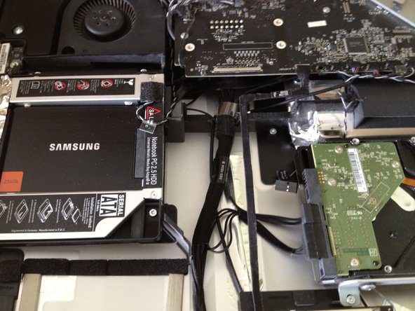

Image 1/1: Be extra careful with the display cables, I broke mine
  • Remove the display as described on ifixit
  • Be extra careful with the display cables, I broke mine
  • You need to remove the temperature sensor cable from the HDD to remove the card
  • Remember the position of this cable! ifixit tip: it must later be reinstalled closest to the SATA connector and the black cable need to point up, towards the LCD
In my case, the cable was originally installed the other way round. The black cable was at the lower end, followed by the white, followed by two empty slots. The empty slots sit next to the SATA Connector.
EDIT: which is, btw, idiot proof because the connector only goes in one way...
Ben Beckers - Reply

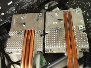

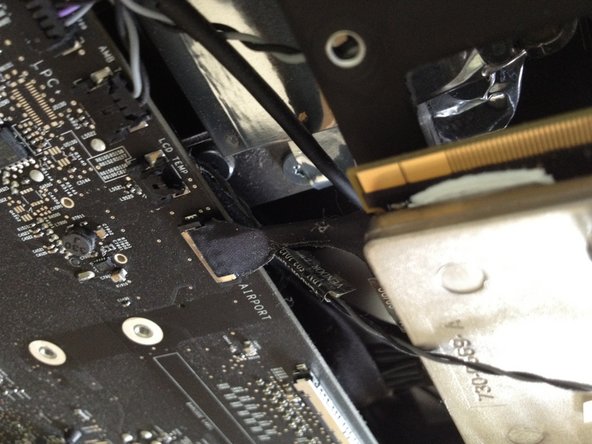

Image 1/2: Locate the large heatsink from the graphics card, which should be right above your DvD drive Image 2/2: Remove the single screw there holding it in place
  • Now remove these 3 screws from the graphics card brezel seen in the left image
  • Locate the large heatsink from the graphics card, which should be right above your DvD drive
  • Remove the single screw there holding it in place
  • Carefully remove the graphics card temperature sensor cable from underneath the motherboard
  • Remember the position as you need to plugin the new one here as well
*Use Hemostats or tweezers when it comes time to remove the graphics card temperature sensor cable from underneath the motherboard make sure you grab it by the top and bottom of the plug and not from the sides. For example if your pinching at the plug make sure your thumb is on top and other finger is on the bottom, not from the sides! Look at your imac like your using it and either hold the unattached heat heat sink/GPU in your left hand while you reach around the back and behind the mother board to find the temp sensor. I used a pair of hemostats and pulled the plug by the top and bottom and it pulled right out.
mattier303 - Reply

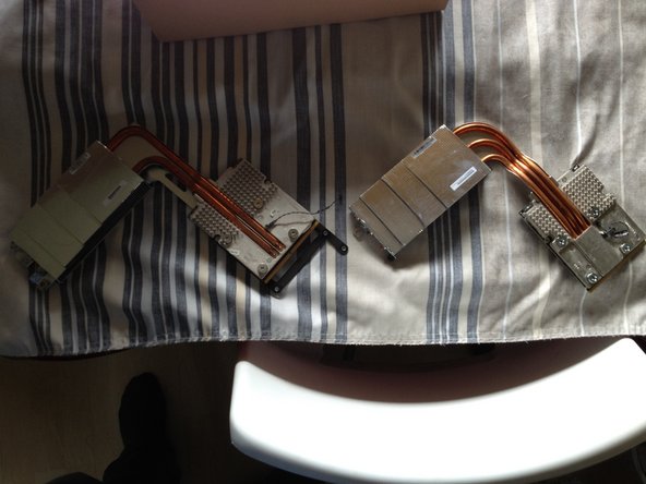

Image 1/2: Store away your graphics card safely in case you need it again or want to reinsert it Image 2/2: The second image shows both the 4 and 6 series side by side. A little difference in height makes some extra work necessary (see next step)
  • Remove the metal brezel from the graphics card. Only a couple of screws hold it in place
  • Store away your graphics card safely in case you need it again or want to reinsert it
  • The second image shows both the 4 and 6 series side by side. A little difference in height makes some extra work necessary (see next step)
the increase in heat emission is 85W -> 250W! use Macs Fan Control to speed up your fans and while you're at it, replace thermal compound on the card.
jes ta - Reply

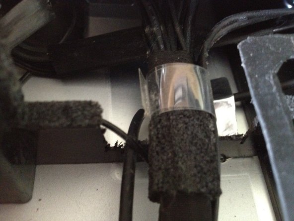

  • You will need to remove the DVD drive in order to remove the plastic piece mentioned in the next step. The drive is held in by 4 Torx screws, once those are removed, the drive can be lifted and swung out of the way without removing any cables.
where is te image???
Luis Manrique - Reply
Sorry to be so bland, but +1: Where is the image?
socklint - Reply

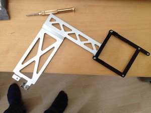

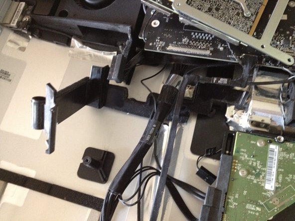

Image 1/3: Remove the plastic part which is shown on the 2nd picture by removing one screw and carefully pull it from the aluminium case Image 2/3: Its fastended with tape, so don't worry, you can't break anything Image 3/3: Some wiggling and navigating it from the cables and you should have it in your hands
  • As the 6 series is slightly higher we need to make a little space on the plastic holder which is beneath the card
  • Remove the plastic part which is shown on the 2nd picture by removing one screw and carefully pull it from the aluminium case
  • Its fastended with tape, so don't worry, you can't break anything
  • Some wiggling and navigating it from the cables and you should have it in your hands
  • You see the rectangular space where the large cable goes through. Use a saw or other tool to make it about 5mm wider and 2-3mm deeper
  • The third image shows the final result we want to achieve
  • The primary reason for thi step is the heatpipe of the 6 series which takes more space
  • Note: this is ONLY necessary on the late 2009 model, 2010 models already got enough room!
Had to do this on a 2010 i5, not enough room otherwise!
- removed 2x3mm piece on the left corner of the gap
- made the gap 4-5mm deeper
jes ta - Reply

Does the 2010 5750 heatsink fits on the 6970? On ebay there are many 6970 card without heatsink at good price, and if the heatsink fits it would be nice.
mchigioni - Reply
I was wondering the same thing. I would like to use the heatsink from my 2009 4850-512 card. Does anyone know if the 4850 heatsink fit the 5670, 6770 and the 6970? They look very similar, the only difference I see is that the 6970 has a third heat pipe which might only be for the 2gb version
Jose Rodriguez -
Hi, did you get an answer?
I've ordered a 6970m card but I think it doesn't have the heatsink... :/
http://fr.aliexpress.com/item/for-AMD-Mo...
Or should I buy this too?
http://fr.aliexpress.com/item/New-Best-G...
Thanks a yon for your help
Mathieu

  • Reinsert the temperatur sensor cable. You need fine hands or a good tool to do so. Be patient with this step
connecting the temperature sensor cable was quite challenging. It helped to stand the computer up right, use tweezers, prebend the wires so the tip was in approximately the right position to be reinserted. I realized after having someone hold a flash light for me that I had been attempting to insert the cable facing the wrong direction. I shouldn't take to much force or effort to get the cable to plug in. Best of luck.
Lucas Scott - Reply

Done on a 2010 i5 2.8. I also did the following improvements while in there:
- i5 2.8 -> i7 2.93
- installed extra SSD
- RAM 4Gb -> 16Gb
What i found:
The 6970 2Gb emits 250W of heat compared to 85W of the original 5750 (in my machine).
Since the ODD fan cooles the GPU heat sink but the sensor used to control the fan is the ODD temp sensor, the card will get REALLY HOT (97.5°C tops) and fall back into power safe mode to conserve energy and cool down.
What i did:
I put the SSD in between the original HDD and the Optical Drive so it doesnt block air flow from the ODD fan to the GPU heat sink.
I applied new thermal compound to the card. Old one was really thick and not well spread.
I installed, and HIGHLY RECOMMEND this programm (both in windows 7 and OS X): Macs Fan Control
It lets you set the sensor, the base temp and the top temp for all three fans individually. Set the ODD fan to use the GPU heat sink as temp source and set temps to min:35 max:70. I'm getting a max of 78° which is fine for the card.
Bam, problem solved.
jes ta - Reply

The hardest step is reinstalling the temp sensor connection under the main processor board. Almost impossible but got it with extreme patience.
Nick Martello - Reply

Connecting the heat sensor of the video card is a pain. And after the install in iStat the GPU die temp does not show up. however since i am controlling the fans manually I am not to worried (i still have GPU heatsink info and all the other temped indicators)

Was wondering if Heatsinks are interchangeable? The cards are cheaper without the heatsinks. Would like to use the heatsink from my 2009 4850-512 card. Does anyone know if the 4850 heatsink fit the 5670, 6770 and the 6970? They look very similar, the only difference I see is that the 6970 has a third heat pipe which might only be for the 2gb version
Jose Rodriguez - Reply
I'm in the exact same situation, except I already bought the card not realizing it didn't come with a heatsink. I don't know the answer, but I'm pretty sure that third thermal pipe IS important for keeping the card cool. Otherwise it'll just shutdown your computer every time it gets close to overheating (the issue I'm currently having).
Did you ever get this resolved?
Josh -

- the cable for the temp sensor was actually easy; i got a little lucky. With tweezers i just got it up close so it rested with the pressure of the wire; then used the back(flat side) of the teasers and gently pushed up.

The 6970M I ordered didn't come with a heatsink, JUST the card. My friend helped me install it yesterday and every time I try to run a game in Windows 10 (boot camp) the computer shuts off instantly.
Based on this, does it sound like I need to get the heatsink that comes with the 2011 iMac's GPU? Or could it be something like not enough thermal paste, or a software issue?
Josh - Reply
Try that Macs Fan Control utility. In addition to being able to set the fans to come on earlier, you can also see all of the temperature readings. You could monitor the GPU heatsink temp and see if it seems to spike before the machine shuts down.
Matt G -
