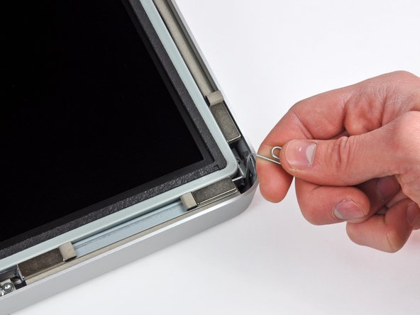

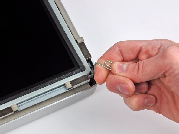

Image 1/3: Pull the glass panel away from the lower edge of the iMac and carefully set it aside. Image 2/3: Don't use the suction cups to carry the glass panel—if either one loses its grip, the panel could fall and break. Image 3/3: After setting the glass panel down safely, be sure to release the suction cups, as the suction force over time, can crack the glass.
  • Gently lift the glass panel perpendicular to the face of the LCD enough to clear the steel mounting pins attached along the underside of the top edge of the glass panel.
  • Pull the glass panel away from the lower edge of the iMac and carefully set it aside.
    • Don't use the suction cups to carry the glass panel—if either one loses its grip, the panel could fall and break.
    • After setting the glass panel down safely, be sure to release the suction cups, as the suction force over time, can crack the glass.
  • During reinstallation, be sure to meticulously clean the inside of the glass panel and the face of the LCD as any dust or fingerprints trapped inside will be annoyingly visible when the machine is turned on.
you should do this mac up, because, for me, one of the suction cup failed, and the glass fall into the lcd screen. Now there is a big hole in it...
Lau - Reply
do you still have this panel?
Alpha Dimension -

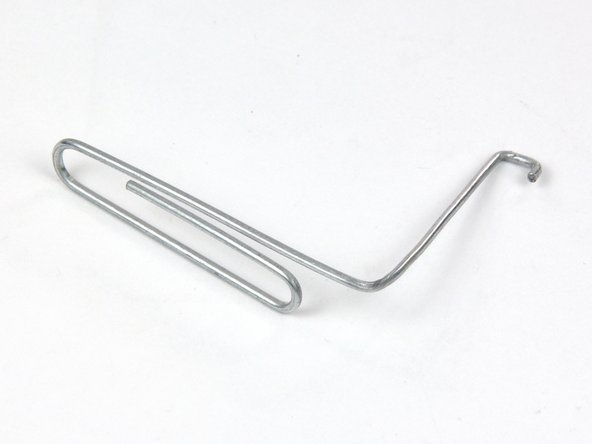

Image 1/3: Due to tight tolerances, you will have to use a thin hooked tool to lift the display out of the outer case. As seen in the third picture, we made one out of a bent paperclip. Image 2/3: Use a thin hooked tool to lift one side of the top edge of the display by its steel outer frame. Image 3/3: After lifting the top edge of the display on one side, hold it out of the outer case while you use a hooked tool to lift the other side. A pencil or pen can be placed under the top edge of the display, parallel to the top edge and extending past the edge of the computer, to keep the first side propped up while lifting the second.
  • Carefully lay the iMac stand-side down on a flat surface.
  • Due to tight tolerances, you will have to use a thin hooked tool to lift the display out of the outer case. As seen in the third picture, we made one out of a bent paperclip.
  • Use a thin hooked tool to lift one side of the top edge of the display by its steel outer frame.
  • After lifting the top edge of the display on one side, hold it out of the outer case while you use a hooked tool to lift the other side. A pencil or pen can be placed under the top edge of the display, parallel to the top edge and extending past the edge of the computer, to keep the first side propped up while lifting the second.
  • Do not lift the top edge of the display out of the outer case too far, as several short ribbon cables still connect the two components.
Be very careful not to hook the Bluetooth antenna cable while you're lifting the display out. It's hiding under the top left corner of the iMac. I managed to snag mine with the paperclip and ended up pulling the antenna cable clean out of the tiny gold connector. Some very precise reconstruction work was required to get the cable seated in the connector again and back up to full signal strength.

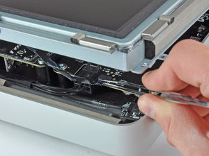

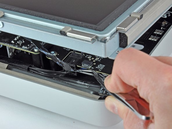

Image 1/2: On some iMacs this may not be a ribbon cable but four separate, very fine and very fragile wires. Be very careful, if the tweezers slip off the plug, you will very likely pull a wire out of the assembly. Image 2/2: On some iMacs this may not be a ribbon cable but four separate, very fine and very fragile wires. Be very careful, if the tweezers slip off the plug, you will very likely pull a wire out of the assembly.
  • Use a pair of tweezers to pull the vertical sync ribbon cable out of its socket on the LED driver board near the top left corner of your iMac.
  • On some iMacs this may not be a ribbon cable but four separate, very fine and very fragile wires. Be very careful, if the tweezers slip off the plug, you will very likely pull a wire out of the assembly.
I had a friend with me so all I did was disconnect the vertical sync ribbon cable, and I had my friend hold up the LCD for a couple of minutes as I swapped out my HDD with an SSD, thus avoiding steps 6-9 and going straight to step 10.
Gabe - Reply

After removing the display, I noticed a high pitched whine coming from the machine, different loudness for different levels of display brightness. Reading up on it, it seems that the problem is with the vertical sync cable (and this is a well-known issue with Apple with new machines, too). So be careful when reinserting this cable!
Adam Hintz - Reply
I noticed that the vertical sync cable seems to have been updated since the guide was produced. It now has a more normal plug and socket and 'regular' wires instead of the flat ribbon cable shown here. I used narrow nosed pliers instead of tweezers to unclip it as I was afraid that just pulling on the wires could have broken them.
Eoin - Reply
WARNING: Take extreme care when removing these wires as mine were not a ribbon cable but individual tiny wires. I removed them cautiously with tweezers OK but when re-inserting, one of the wires came off. Obviously someone had been in here before.
Peter Sinclair - Reply
be sure to keep this cable, because it does not come with a new display!

My vertical sync ribbon cable had two of the four contacts bent back, it may even have been like this originally. I straightened them out as best I could under a magnifying glass, and after reinserting, everything is working OK. Seems this cable is not particularly critical. Also, I used needle nose pliers for this and the other connectors, I can't get enough grip with tweezers.
Andrew Crabb - Reply
Tweezers didn't work for me due to the angle and lack of grip (they kept slipping and I was concerned about squeezing any harder). I just used my fingers to grab the connector as close to the connection as possible for both removal and insertion and it worked just fine. I have big hands and meaty fingers, so this method should work fine for anyone.
David - Reply
I have a late 2009 27" Mac and did something similar to Gabe, but being alone, after unplugging the vertical sync cable, I used two wooden chopsticks to hold the screen at about 45° and without disconnecting any more cables I could quite easily access the Superdrive to remove and replace with a 240GB SSD with help from a caddy from TheNatural2020, which required a tiny modification.

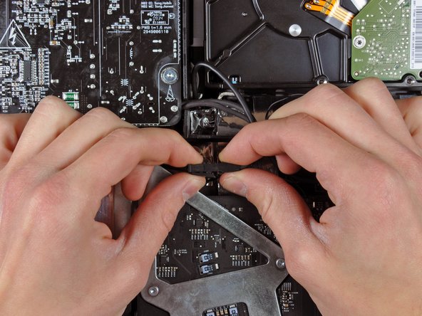

Image 1/1: If your fan is spinning full speed after completion, check this connection or the hard drive's thermal sensor cable. The thermal sensor connector socket is very fragile, so be very careful when you connect back the sensor cable.
  • Lift the display for enough clearance to disconnect the LCD thermal sensor cable connector from its socket on the logic board.
  • If your fan is spinning full speed after completion, check this connection or the hard drive's thermal sensor cable. The thermal sensor connector socket is very fragile, so be very careful when you connect back the sensor cable.
Be very very careful when you pull out this plug as it is extremely fragile and also reattaching the LCD thermal sensor plug and very very gently ensure that the pins are actually going into the connector before you push the plug in. i damaged the top part of the plastic housing which then made it difficult to insert the plug into the connector. I can't believe how easy it was to damage this connector!! If you don't attach the LCD thermal sensor plug correctly the Mac fans will go crazy at full speed. It took a good 15 minutes to get the pins to finally go into the plug and they can bend easily.
j74656 - Reply

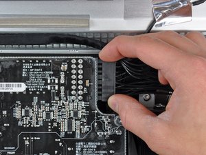

Image 1/2: Disconnect the DC power cable by using your index finger to depress the locking mechanism on the back of the connector while you pull the connector away from its socket on the power supply. Image 2/2: Once the locking mechanism has cleared the socket, pull the DC power connector away from the power supply.
  • The next few steps bring your hands close to the exposed face of the power supply. To avoid a high voltage shock from the many large capacitors attached to the board, do not touch the face of the power supply.
  • Disconnect the DC power cable by using your index finger to depress the locking mechanism on the back of the connector while you pull the connector away from its socket on the power supply.
  • Once the locking mechanism has cleared the socket, pull the DC power connector away from the power supply.
I found it tricky to get a grip on this connector with the PSU still in place so I left this step until I had removed the torx screws holding the PSU in place. By lifting the PSU and rotating it toward the top of the iMac I was able to disconnect the DC cable easily.

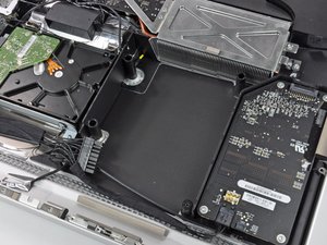

Image 1/1:
  • Disconnect the AC power inlet cable by depressing the locking mechanism while pulling the connector away from its socket.

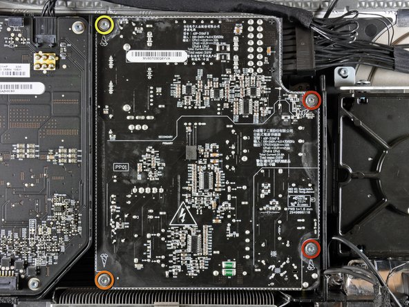

Image 1/1: Two fine-thread shouldered T10 Torx
  • Remove the following screws securing the power supply to the outer case:
    • Two fine-thread shouldered T10 Torx
    • One coarse-thread shouldered T10 Torx
    • One short coarse-thread T10 Torx
Image 1/2: Two plastic brackets may lift out with the power supply. Their correct orientation is shown in the second picture. Image 2/2: Two plastic brackets may lift out with the power supply. Their correct orientation is shown in the second picture.
  • Lift the power supply out of the outer case while gently de-routing it from any wires that may get caught.
  • Two plastic brackets may lift out with the power supply. Their correct orientation is shown in the second picture.
