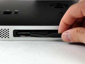

  2. iMac Intel 24" EMC 2134 and 2211 RAM Replacement, RAM: step 2, image 1 of 2 iMac Intel 24" EMC 2134 and 2211 RAM Replacement, RAM: step 2, image 2 of 2
    • Use the tip of a spudger to pull the black plastic RAM tabs out of the memory bay.
    • Pull the black plastic RAM tab away from your iMac to eject the RAM module.
  3. iMac Intel 24" EMC 2134 and 2211 RAM Replacement: step 3, image 1 of 1
    • Grab the RAM module by its edges and pull it straight out of its slot.
    • If two RAM modules are installed, repeat this process for the other chip.
