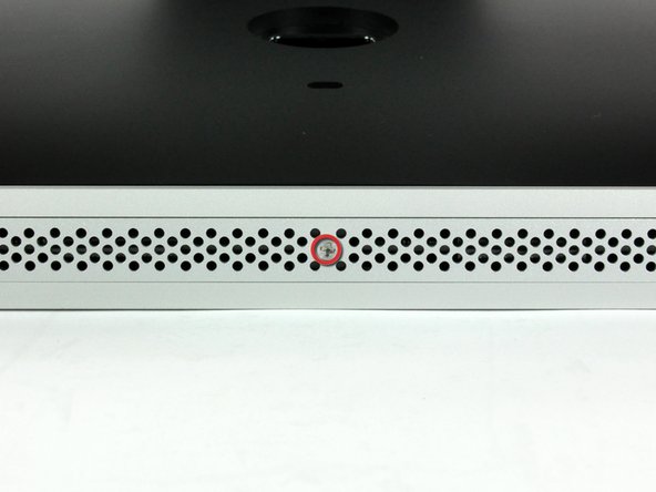

Loosen the single Phillips screw in the center of the access door.
Remove the access door from your iMac.

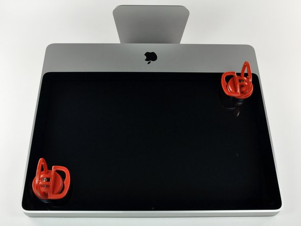

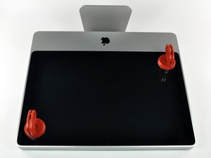

Stick two suction cups to opposing corners of the glass panel.
Save $15 dollars and use a plunger. Works perfectly.
Perhaps not so elegant but equally effective without any adverse effects to either... try a vacuum cleaner.
Gently pull the glass panel straight up off the iMac.
The glass panel is somewhat thin and should come away quite easily without much force so be gentle.
To reinstall the glass, I lined up the bottom edge first, then pivoted the top in. The magnets pulled it quickly into place.

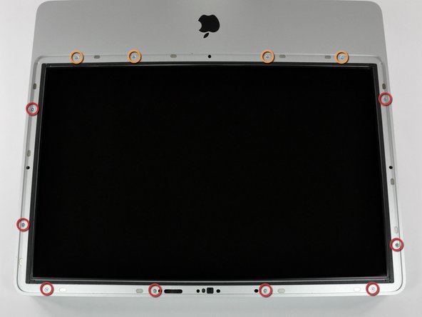

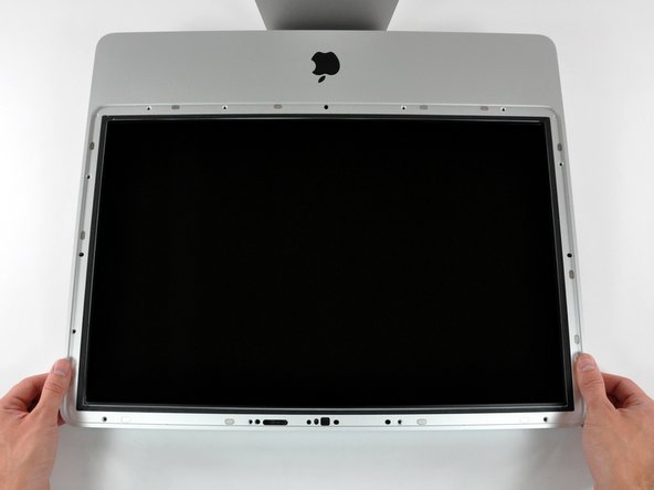

Remove the following 12 screws securing the front bezel to the rear case:
Eight 13 mm T8 Torx screws
Four 25 mm T8 Torx screws
I only had two 25 mm T8 Torx on my model. (The two inner orange circles as shown in the diagram.)
I don't know if this is different but i am in the process of disassembling a 24' imac emc: 2134. i have only: (2) 25 mm T8 screws the inner two on the bottom of the screen. I have (4) 13 mm t8 screws the outer most holes on the bottom and the 2 holes on the right side of the monitor above the drive entrance and the remaining holes are (6) 11 mm t8 screws
I have the same screws as ccarter on a 2211 except on the bottom row there are only 4 screws total, the longer ones go in the middle two.
I have the same screws as Christian. The key is to make sure all screws are flush to the surface, so that the glass can be held up by the magnets.
On mine, for the red circles, I had the six 13mm Torx plus two 25mm Torx. It's not indicated in the picture here, but the 25mm Torx went on either side of the optical drive.
I marked next to each hole with a pencil "S, M or L" to indicate which length screw goes where. No guess work on reassembly.

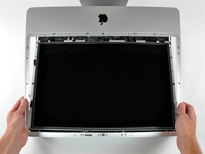

Gently lift the front bezel from its top edge off the rear case. It helps to use your thumbs to push down very gently on the corners of the display.
Once the top edge of the front bezel has cleared the rear case, rotate the front bezel toward the stand and lift it off the rear case.

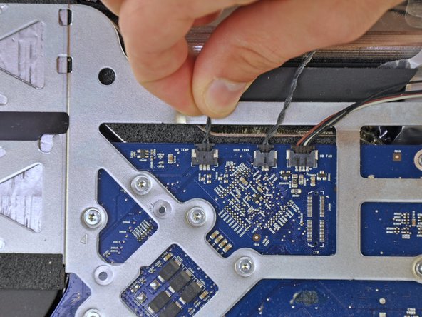

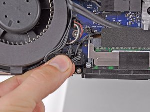

Disconnect the LCD temperature sensor by pulling the connector straight out of its socket on the logic board.
The temp sensor on my EMC2134 is located underneath the LCD and the cable is not very long. I propped up the LCD to facilitate removal.
You have to be extremely careful when pulling out the LCD Temp connection as it doesn't want to come easy. I almost pulled the entire connection off the logic board using too much force. I therefore, used a pair of hemostats to grab the male end (the very top of the connector) and used a small screwdriver to hold the base of the connection in-place (female end attached to the logic board) in order to pull the connector apart.

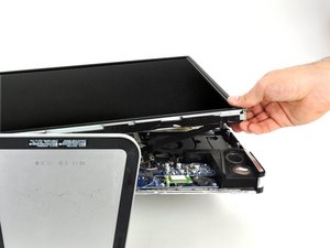

Remove the eight 12 mm T8 Torx screws securing the display panel to the rear case.

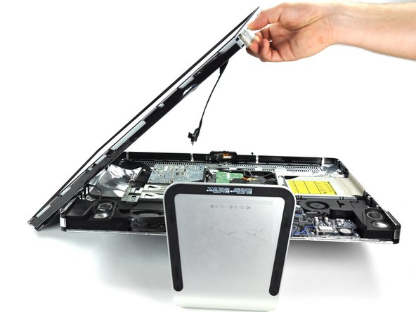

Lift the right side of the display panel a few inches up from the iMac.

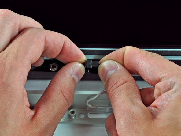

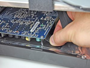

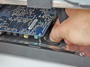

With the LCD lifted, disconnect the LCD cable by pulling down.
I was unable to disconnect the LCD cable, possibly due to fear of breaking the connector. I was able to swap drives with it connected. The iMac was placed on its rear cover on a large table, leaving plenty of workspace to rotate the LCD panel to the left side while still connected. The screen will lay at an angle on the case edge. I verified the LCD cable was clear of the case endue and not pinched.
This also avoids going near high power capacitors with your fingers.
I found it easier to disconnect the LCD cable at the LCD end after lifting the black tape.
Fully agree. Easiest is to remove cable from LCD in stead of trying to pull it off the board
Remove cable from the LCD Display not the board
Fully agree with others. It is easiest is to remove cable from LCD display instead of trying to pull it off the board. It comes off the board very easily, but it is difficult to put it back onto the board. It is easier to snap the cable bad onto the LCD Display itself.

+1 for removing the LCD cable from the screen side, not the mac side.

As others have stated, disconnecting the inverter cable from the power supply first is NOT the way to go. I ended up damaging the cable trying to get it out before I went to disconnect it from the LCD panel end instead. Much easier to do and much less prone to damaging the cable or it's insertion socket.
The guide needs to be updated and the suggestion to pull the inverter cable downward from the power supply removed. It is not a good idea and will cost you at least a few days and $10 to replace the cable should something go wrong. Please update this guide.
Continue to lift the LCD from the right side.
Remove the LCD.
Much simpler to remove the LCD cable at the LCD insertion site, rather than trying to remove it as suggested in the manual. Reinsertion is also less traumatic.

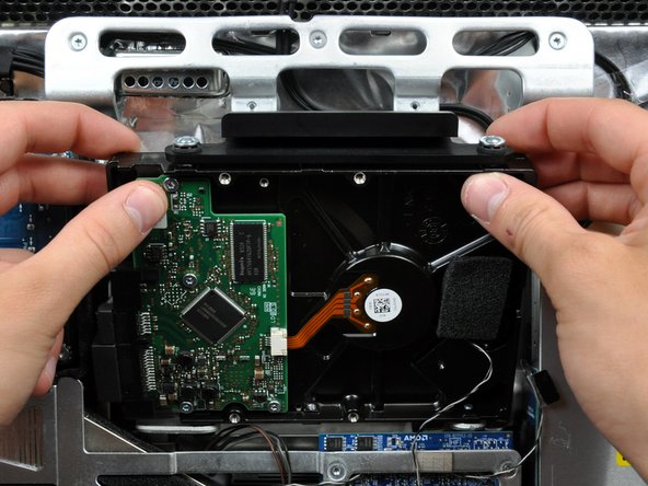

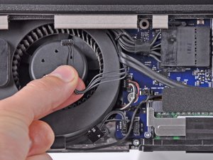

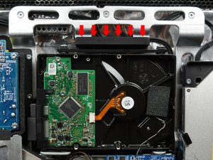

Disconnect the hard drive thermal sensor by pulling its connector upwards toward the top of your iMac.

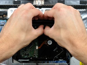

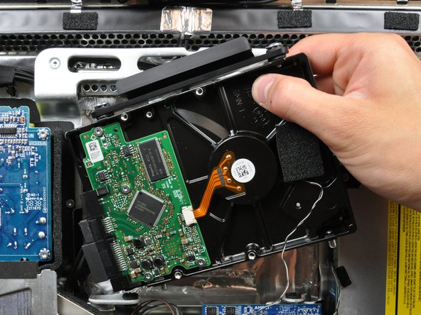

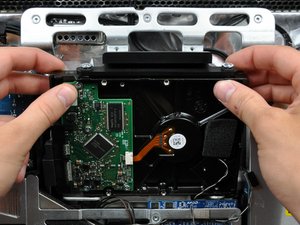

Press the hard drive bracket down toward the bottom edge of your iMac to free it from the rear case, then rotate the top of the drive toward yourself.
To avoid the pain on my finger tips in applying enough force, I used a bit of microfiber towel as padding under the sharp plastic edge and it was then easy.
I found out that the black plastic bar is a lever, which swings up outwards left side — away from the backside of the casing — and then drops off of the right side, which releases the rubberized bolts, that hold the hard drive! The hard drive then could be lifted easily out of its hinges. Mind the cables!
Rotate the hard drive toward yourself, then lift it up off its mounting pins.

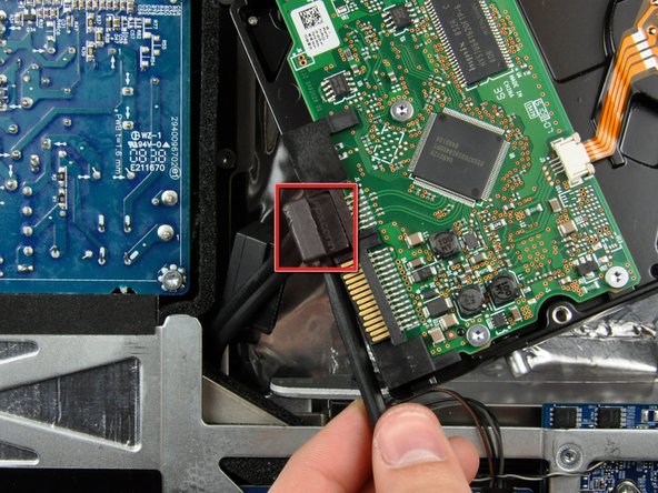

Insert the flat end of a spudger between the SATA power cable connector and the edge of the hard drive.
Twist the spudger to separate the connector from the hard drive.
Pull the SATA power connector away from the hard drive.

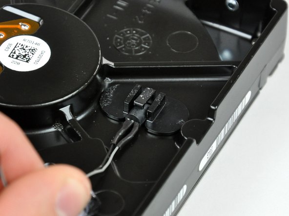

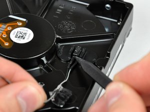

Remove the piece of foam tape covering the hard drive thermal sensor.
Use the tip of a spudger to lift the thermal sensor lock finger while pulling lightly on the thermal sensor cable.
Use the flat end of a spudger to pry the thermal sensor bracket off the face of the hard drive.

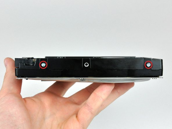

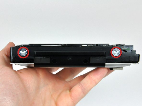

Remove the two T8 Torx screws securing the hard drive bracket to the hard drive.
Remove the two T8 Torx pins from the connector side of your hard drive.

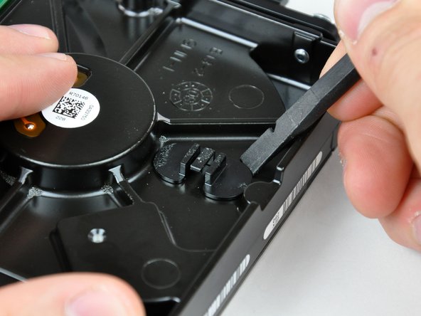

Use the flat end of a spudger to remove the piece of EMI foam from the underside of your hard drive.
I'm confused about the purpose of the EMI foam in step 25:
Quote: Use the flat end of a spudger to remove the piece of EMI foam from the underside of your hard drive.
Don't forget to transfer this to your new hard drive./Quote
Would you please elaborate about this part?

PH2 head necessary to remove screw.
