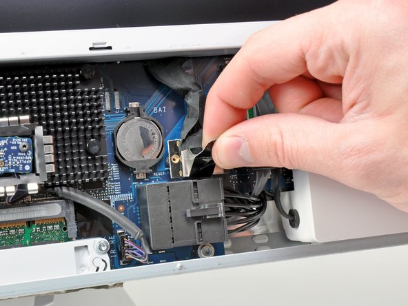

Image 1/1: The microphone connector is located near the inside of top edge of your iMac.
  • If necessary, remove the strip of tape covering the microphone cable connector.
  • The microphone connector is located near the inside of top edge of your iMac.

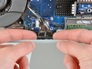

Image 1/3: Disconnect the camera cable by pulling its connector away from the socket on the camera board. Image 2/3: The camera cable connector and socket are delicate and easily bent. Remove with caution. Image 3/3: The camera cable connector and socket are delicate and easily bent. Remove with caution.
  • Disconnect the microphone cable.
  • Disconnect the camera cable by pulling its connector away from the socket on the camera board.
  • The camera cable connector and socket are delicate and easily bent. Remove with caution.
I found it easier not to remove the cables connecting camera and microphone, but rather to lean the plastic frame agains a pile of books so that it could rest almost vertical avoiding the need to disconnect those two sensitive cables.
Stefano C - Reply
I agree that for a simple, quick battery change, don't risk damaging those delicate wires. Ignore Step 6 and instead of disconnecting the mic and camera wires, keep them in place and just have a friend hold the plastic frame up while you change the battery, or prop it up as mentioned by Stefano C above.
WT Kwok - Reply

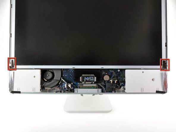

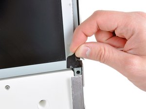

  • Peel the two highlighted EMI shield tabs off the frame of the LCD.

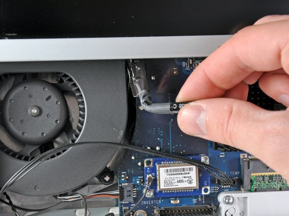

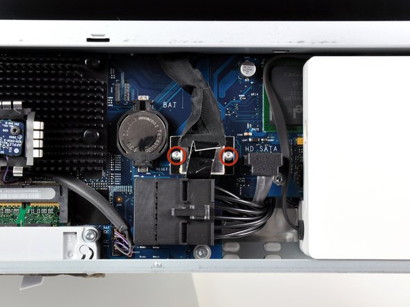

  • Remove the two T6 Torx screws securing the display data cable to the logic board.
Image 1/1:
  • Pull the black plastic tab attached to the display data cable connector to disconnect it from the logic board.
Image 1/2: De-route the inverter cable from its location next to the CPU fan. Image 2/2: De-route the inverter cable from its location next to the CPU fan.
  • Use your fingertips to pull both sides of the wide inverter cable connector out of its socket on the logic board.
  • De-route the inverter cable from its location next to the CPU fan.

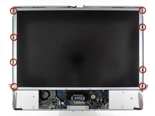

Image 1/1: Remove the eight T8 Torx screws securing the display assembly to the rear case.
  • Before attempting this step, we recommend laying your iMac stand-side down on a table to avoid the display falling down.
  • Remove the eight T8 Torx screws securing the display assembly to the rear case.
  • It is helpful to use a thin magnetized screwdriver to remove these screws.

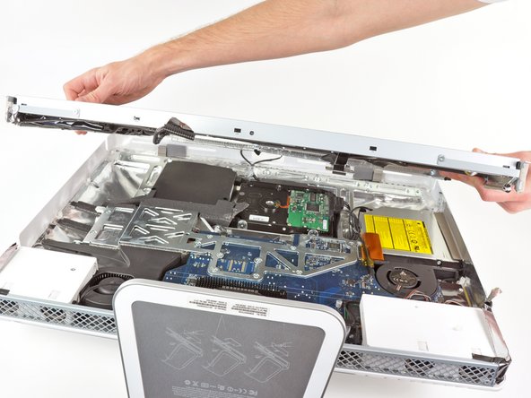

  • Remove the display assembly from the iMac.

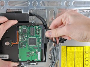

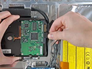

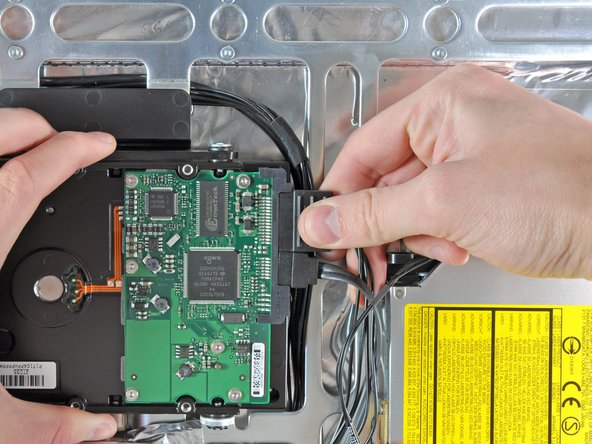

  • Disconnect the SATA data and power cables by pulling their connectors away from the hard drive.

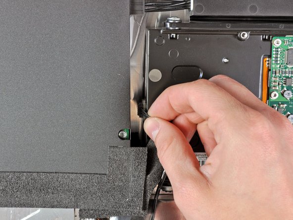

  • Disconnect the hard drive thermal sensor cable from the thermal sensor attached to the side of the hard drive.
Since you're going to transfer this to the new drive, I found it easier to disconnect the other end of the temp sensor cable, on the edge of the mobo.
maccentric - Reply

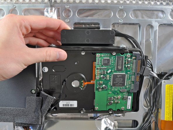

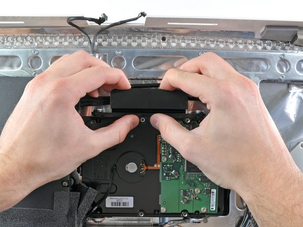

Image 1/2: Pull the top edge of the hard drive slightly away from the rear case. Image 2/2: Pull the top edge of the hard drive slightly away from the rear case.
  • Compress the plastic hard drive retainer by pushing it toward the bottom edge of the iMac.
  • Pull the top edge of the hard drive slightly away from the rear case.
I found it easier to take out the two torq screws on the plastic holder, in stead of compressing it.
eriktar - Reply

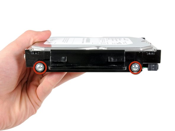

Image 1/1: Remove the hard drive bracket.
  • Remove the two T8 Torx screws securing the hard drive bracket to the side of the hard drive.
  • Remove the hard drive bracket.

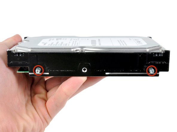

Image 1/1:
  • Remove the two T8 Torx retaining posts from the other side of the hard drive.

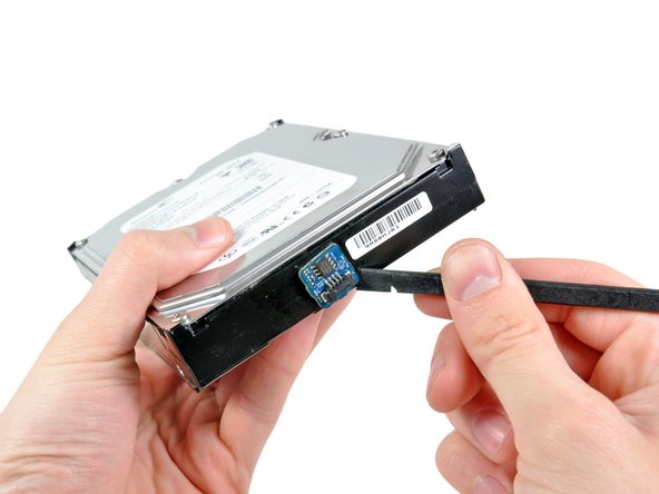

  • Use the flat end of a spudger to remove the thermal sensor from the side of the hard drive.
  • Hard drive remains.

The T8 Torx does *not* have to be security type. However it is critical to have a long, thin, dedicated T8 screwdriver, not one that is part of a kit with interchangeable tips (and thus a thick collar that won't fit into the narrow slot). I got the kit, it didn't work, returned it and got an unmagnetized T8 with 2.5" length. I then magnetized it with a strong refridge magnet (which didn't work well), so better yet after I removed the 8 screws (Step 11), I magnetized the screws themselves, which worked great.

Could the author add a few notes about how to clean off any remaining adhesive on the HD Temp. Sensor and what type of adhesive to use in re-attaching the HD Temp. Sensor to the new drive? In addition; a note on how to locate the sensor on the drive chassis, if using the original location, but on the new drive, is not possible.
