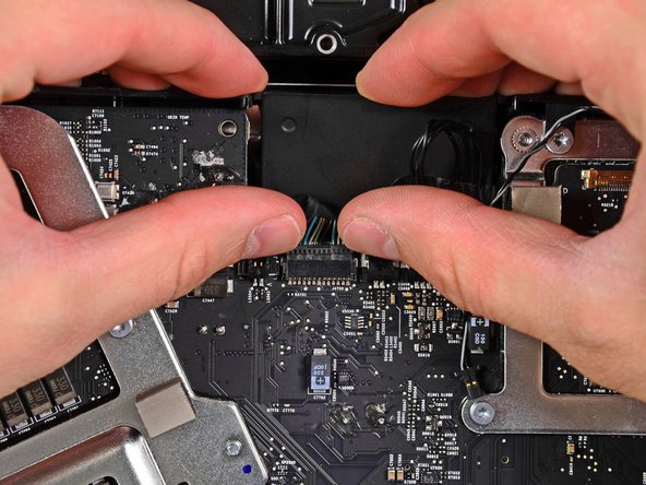

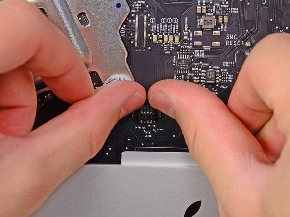

Image 1/2: Pull the display data cable straight out of its socket on the logic board. Image 2/2: Do not lift up on the display data cable, as its socket is very fragile. Pull the cable parallel to the face of the logic board.
  • The display data cable plug has a wire lock. Disengage the plug's lock by rotating the plastic tab so that it points upward. (It is not a pull tab.)
  • Pull the display data cable straight out of its socket on the logic board.
    • Do not lift up on the display data cable, as its socket is very fragile. Pull the cable parallel to the face of the logic board.
This cable is very short, I would remove it before any of the others. First time I did this, I didn't realize this and this cable just popped out of it's socket. Luckily, the board wasn't damaged.
maccentric - Reply
i damaged my (step7) cable, and my iMac screen won't work, how to fix this?
Ersan Rasubala - Reply
I did the same thing. The pins are VERY easy to bend. I replaced it with a new cable from this company.
http://www.macpalace.com/922-9497-cable-...
Waiting for it to arrive.
Michael -
I wish this step was listed as a warning before lifting the monitor and as the first cable to undo. I broke it as it popped up and out, had to trash my Mac and I am stuck with a new hard drive.
Frank1701a - Reply
I followed the directions to a T and everything worked going back together. That cable in step 7 is delicate so one must be very careful.
dustynnelson -
Same problem for me. I damaged this cable and am ordering one now.
This is a tough step so I would also suggest removing this cable first.
lyleberman - Reply
Yes, damaged mine too. It is better to take it out of the LCD and install it carefully on the logic board, then install it to the LCD.
asle -
Ok finally got the cable and was able to successfully finish the project.
That video cable is ROUGH to install.
lyleberman - Reply
The same thing happened for me. That cable was by far the shortest and a slight pull of the display up caused the connector to come free. Luckily it wasn't damaged by this. It was pretty unclear to me how that connector fit in as well. It slides in and out parallel to the surface of the mother board, up towards the top of the iMac to unplug and down towards the bottom to plug in. I agree, if I were to do this repair again that is the first interior cable I would disconnect. Maybe a closeup of the cable plugged in and unplugged to show exactly how it engages and disengages would be good as well.
danieljseta - Reply
It is fine to remove the cable from the logic board when when you remove the screen. But when when assembling back together I found it better to take the LVDS cable out of the LCD and install it carefully on the logic board. Then connect it to the top of the LCD. Also the connector to the LCD is much more solid and not so easy to bend.
asle - Reply
This is by far the best way round to do this as trying to refit the cable to the logic board is a complete nightmare.
Russ -
I agree with asle, manipulating the display end of the cable would be easier - at least it cannot be any harder then manipulating the motherboard end.
Jerry -
well I did all t these steps and now the iMac won't turn on at all. I guess the big cable is not connected to the board as it used to... Mac is out of warranty so it's going out the door. RIP
Gilbert Palau - Reply
this thing is super fragile. i had to order a new one. i'd recommend removing the other end at the top of the display.
m Burm - Reply

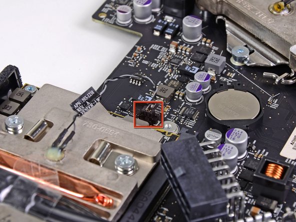

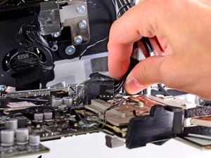

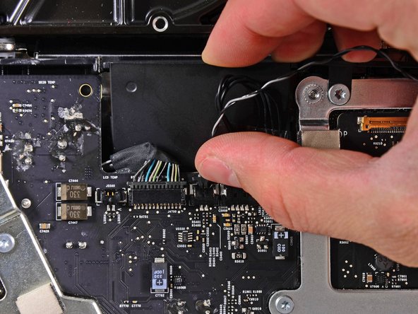

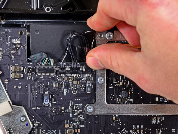

Image 1/2: If your fan is spinning full speed after completion, check this connection or the hard drive's thermal sensor cable. Image 2/2: If your fan is spinning full speed after completion, check this connection or the hard drive's thermal sensor cable.
  • Disconnect the LCD thermal sensor cable connector from its socket on the logic board.
  • If your fan is spinning full speed after completion, check this connection or the hard drive's thermal sensor cable.
Be very careful - this connector very difficult to disconnect, and you have a high risk of pulling the cable pins out of the connect. If you have disconnected the 3 other cables, you can have a helper rotate the screen out of the way while you remove the hard drive.
Brian Tsai - Reply

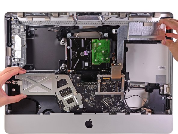

  • Carefully pull the display toward the top edge of your iMac and lift it out of the outer case, minding any cables that may get caught.

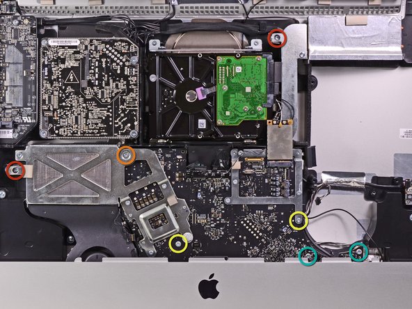

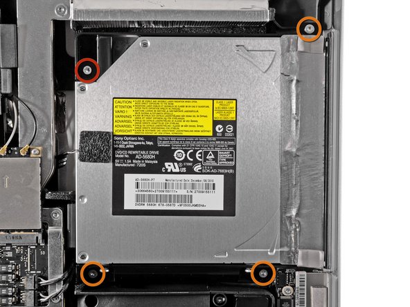

Image 1/1: One 9.3 mm T10 Torx screw with a large head
  • Remove the following four screws:
    • One 9.3 mm T10 Torx screw with a large head
    • Three 9.3 mm T10 Torx screws with a normal sized head

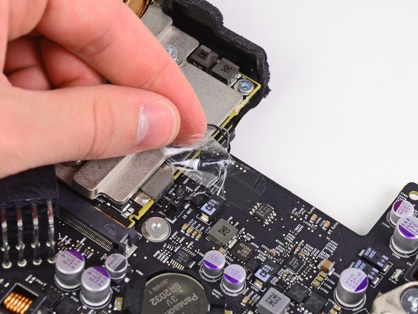

Image 1/2: Image 2/2:
  • Pull the optical drive thermal sensor connector toward the top edge of the iMac to disconnect it from its socket on the logic board.
No need to do this! Just gently pull up the felt-pad sticky on top of the thermal sensor (looks like a tiny circuit board), then (again gently) peel the thermal sensor off the ODD. Leave it hanging while you remove the ODD and replace it with the SSD, then just put the thermal sensor covered by the protective felt-pad back onto the SSD enclosure.
cdansmith1 - Reply
I agree with cdansmith1, above.
I had removed the sensor completely. Booted up and the fan was like a jet engine - 4200rpm! I opened up the mac again to check the LCD thermal sensor cable was connected properly (as warned in Step 8). It was.
So, I simply used the spudger to peel off the felt sticky pad from and then the optical drive sensor too from the drive I'd taken out. Stuck the sensor onto the SSD using the same sticky pad, plugged it back into the original socket. Bingo. Booted up and everything was back to normal.
Monkeyrebirth - Reply

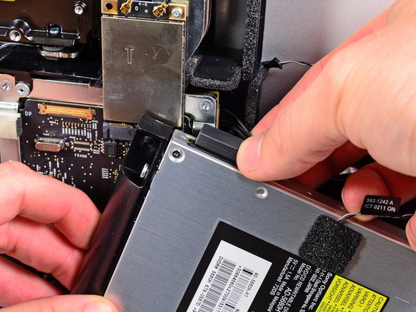

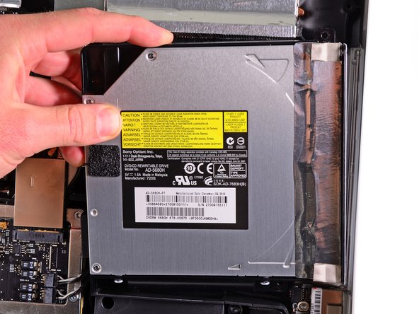

Image 1/2: Carefully pull the optical drive off its mounting pins on the right side of the outer case to gain clearance for disconnecting the optical drive cable. Image 2/2: Allow the optical drive to hang down as you de-route the optical drive thermal sensor connector from behind the GPU heat sink.
  • Lift the inner edge of the optical drive and maneuver its connector past the GPU frame attached to the logic board.
  • Carefully pull the optical drive off its mounting pins on the right side of the outer case to gain clearance for disconnecting the optical drive cable.
  • Allow the optical drive to hang down as you de-route the optical drive thermal sensor connector from behind the GPU heat sink.
Image 1/1: Remove the optical drive from the iMac.
  • Disconnect the optical drive cable by pulling its connector away from the optical drive.
  • Remove the optical drive from the iMac.
  • Do not forget to also move the thermal sensor from the optical drive to the enclosure when you install the second hard drive.

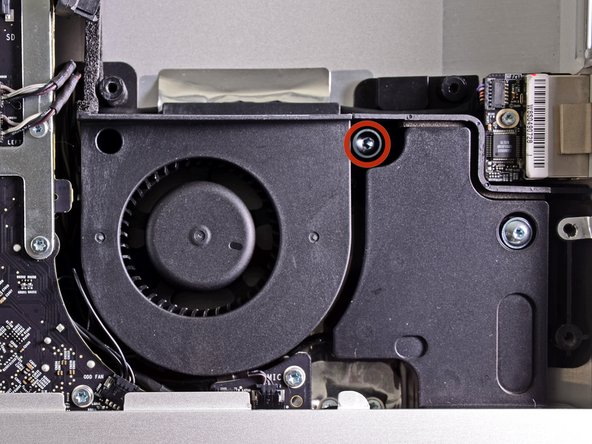

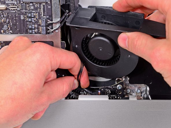

  • Remove the single 13 mm T10 Torx screw securing the optical drive fan to the outer case.
Image 1/1:
  • Pull the optical drive fan off the pins attached to the outer case.
Image 1/1: Remove the optical drive fan from the iMac.
  • Pull the optical drive fan connector out of its socket on the logic board.
  • Remove the optical drive fan from the iMac.

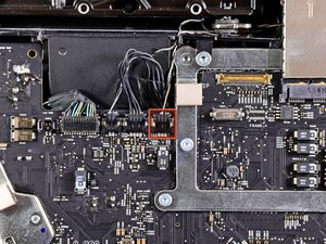

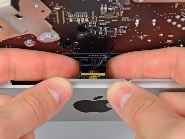

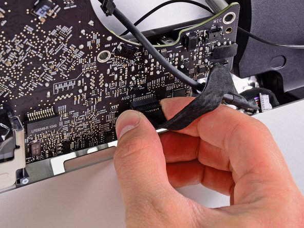

Image 1/1: SD Board and microphone
  • In the proceeding steps, you will disconnect the following cables:
    • SD Board and microphone
    • Left/Right Speaker

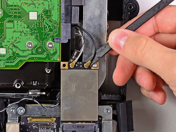

    • Wi-Fi Antenna
    • Bluetooth/Ambient Light Sensor/Camera/Left Temperature Sensor, Hard Drive Temperature Sensor and Hard Drive Fan
    • CPU Fan/Ambient Temperature and Power Button

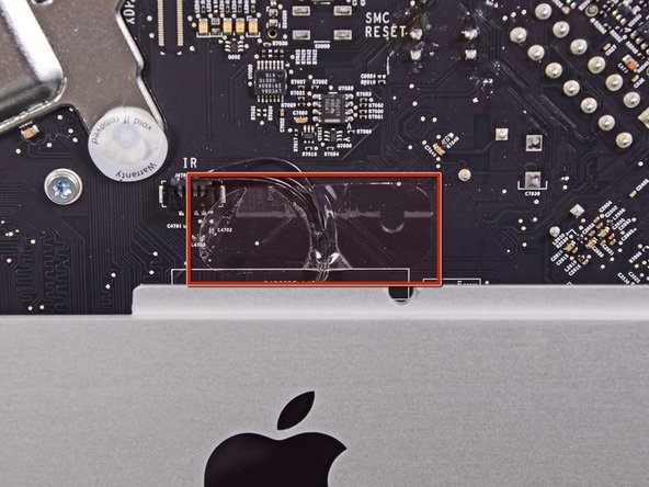

    • IR Sensor

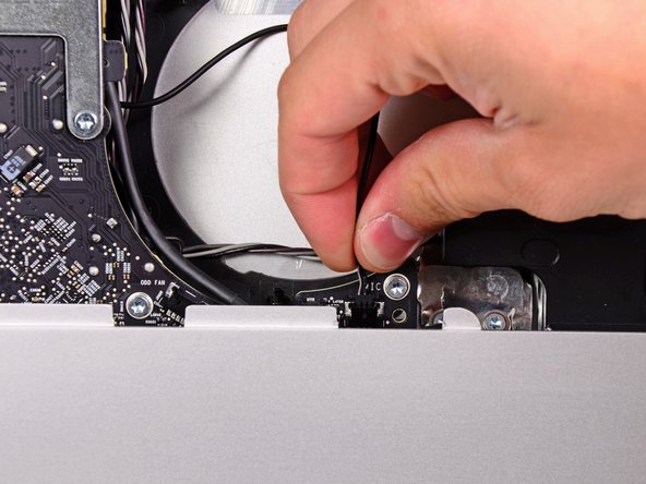

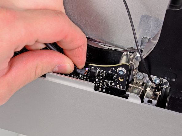

Image 1/1:

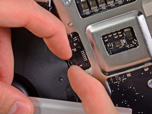

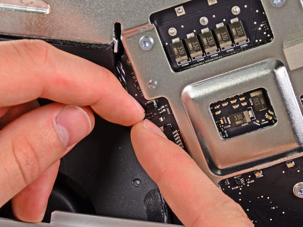

  • Pull the microphone cable connector toward the top edge of the iMac to disconnect it from the logic board.
Image 1/1:

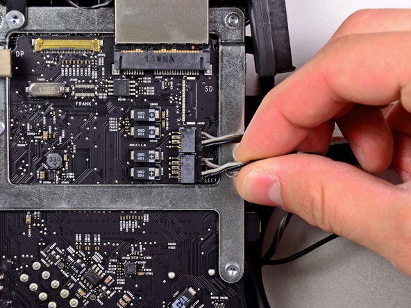

  • Pull the SD board cable out of its socket on the logic board.

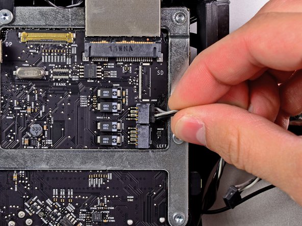

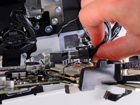

  • Disconnect the left speaker and right speaker cables by pulling their connectors toward the right side of the iMac.

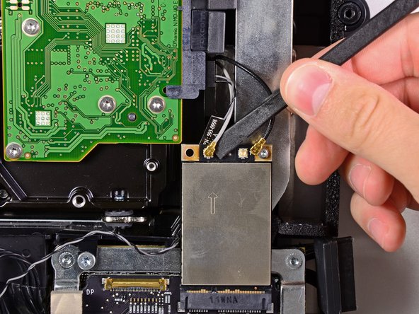

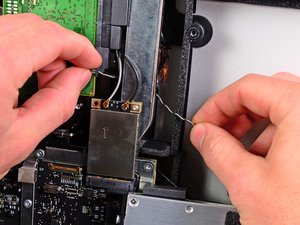

Image 1/2: The gray antenna attaches to the socket on the left and the black antenna attaches to the socket on the right. Image 2/2: The gray antenna attaches to the socket on the left and the black antenna attaches to the socket on the right.
  • Use the flat end of a spudger to pry both AirPort antenna connectors up from their sockets on the AirPort board.
  • The gray antenna attaches to the socket on the left and the black antenna attaches to the socket on the right.

  • Disconnect the hard drive fan by pulling its connector toward the top edge of the iMac.
Image 1/1:
  • Pull the hard drive thermal sensor cable out of its socket and toward the top edge of the iMac to disconnect it from the logic board.
Image 1/1:
  • Use your thumbnails on both sides of the Bluetooth/ambient light sensor/camera/left temperature connector to push it toward the top edge of the iMac and out of its socket on the logic board.
Image 1/3: Pull the power button connector toward the bottom left corner of the iMac to disconnect it from its socket on the logic board. Image 2/3: Pull the power button connector toward the bottom left corner of the iMac to disconnect it from its socket on the logic board. Image 3/3: Pull the power button connector toward the bottom left corner of the iMac to disconnect it from its socket on the logic board.

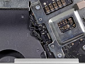

  • Pull the CPU fan/ambient temperature sensor connector toward the bottom left edge of the iMac and out of its socket on the logic board.
  • Pull the power button connector toward the bottom left corner of the iMac to disconnect it from its socket on the logic board.

  • Remove the piece of tape covering the IR sensor cable.
Image 1/1:
  • Use your thumbs to push the IR sensor connector out of its socket and toward the top edge of the iMac.

Image 1/2: One 9.3 mm T10 coarse-threaded screw Image 2/2: One 25 mm T10 coarse-threaded screw
    • One 9.3 mm T10 coarse-threaded screw
    • One 25 mm T10 coarse-threaded screw
    • Two 22 mm fine-threaded screws

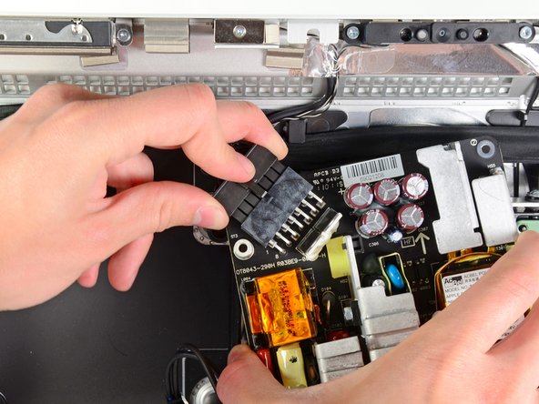

  • Pull the upper right and lower left corners of the power supply away from the rear case to dislodge the mounting posts attached to the power supply's corners.

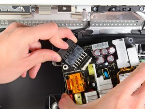

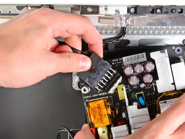

Image 1/2: Disconnect the DC-out cable by depressing the locking mechanism on the connector while you pull the connector away from its socket on the power supply. Image 2/2: Once the locking mechanism has cleared the socket, pull the DC-in connector away from the power supply.
  • Carefully lift the power supply out of the outer case and rotate it to expose the cable lock as shown, minding the DC-out and AC-in cables still attaching it to the iMac.
  • Disconnect the DC-out cable by depressing the locking mechanism on the connector while you pull the connector away from its socket on the power supply.
  • Once the locking mechanism has cleared the socket, pull the DC-in connector away from the power supply.
Image 1/1: Remove the power supply from the outer case.
  • Disconnect the AC-In cable by depressing the locking mechanism while pulling the connector away from its socket.
  • Remove the power supply from the outer case.

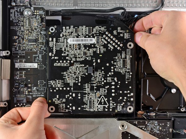

Image 1/1:
  • Remove the plastic wall that is installed directly to the right of the LED driver board.
Image 1/1:

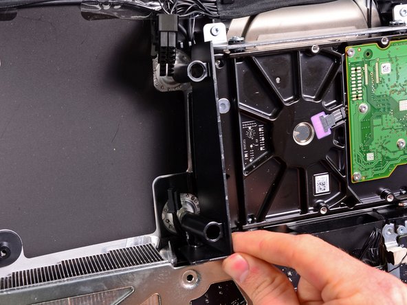

  • Remove the plastic pressure wall installed next to the hard drive.
  • Slightly pull the logic board away from the back of the outer case, then lift it upward to clear the lower front face of the outer case.

  • Disconnect the audio port cable by pulling its connector away from the front face of the logic board.

  • Depress the locking mechanism and carefully pull the DC-In cable out of its socket on the back of the logic board.

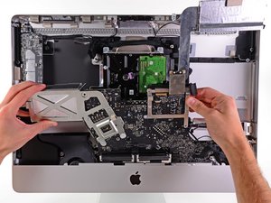

Image 1/1: Remove the logic board, minding any cables that may get caught.
  • Being careful not to damage the socket on the logic board, gently pull the hard drive SATA data cable straight out of its socket on the logic board.
  • Remove the logic board, minding any cables that may get caught.
  • When reinstalling the logic board, plug in a mini display port cable and a USB cable into the outer USB port before tightening the logic board screws to ensure proper alignment.

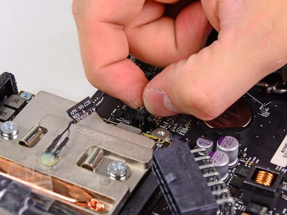

  • Remove the strip of tape securing the GPU thermal sensor cable to the logic board.
Image 1/1: One 4.2 mm T10 Torx screw
  • Remove the following three screws:
    • One 4.2 mm T10 Torx screw
    • Two 5 mm T8 Torx screws

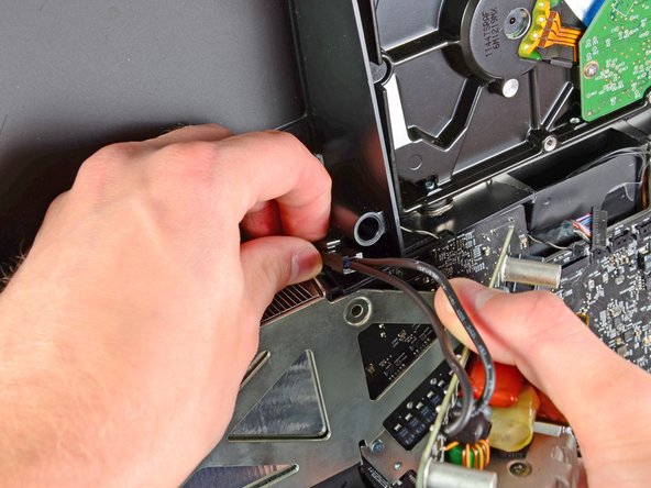

Image 1/2: Do not pull the connector out by its cables. Image 2/2: Do not pull the connector out by its cables.

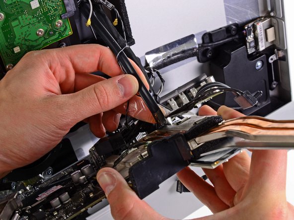

  • Grab the GPU thermal sensor cable connector and pull it straight up and out of its socket on the logic board.
  • Do not pull the connector out by its cables.
Image 1/1:

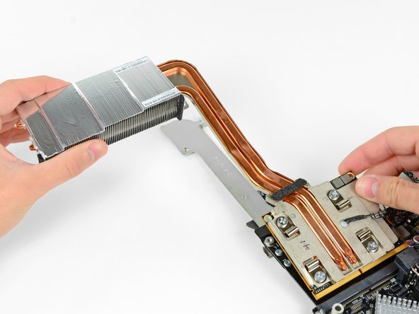

  • Lift the GPU heat sink slightly and pull the GPU board out of its socket on the logic board.
Image 1/2: It may be necessary to use a #1 screwdriver to hold the sockets on the GPU heat sink stationary as you loosen the T8 Torx screws. Image 2/2: It may be necessary to use a #1 screwdriver to hold the sockets on the GPU heat sink stationary as you loosen the T8 Torx screws.
  • Remove the four 6.5 mm T8 Torx screws securing the GPU heat sink to the GPU.
  • It may be necessary to use a #1 screwdriver to hold the sockets on the GPU heat sink stationary as you loosen the T8 Torx screws.
I think this are also 6.5 mm T10 (!) Torx screws.
Max - Reply
Image 1/1:
  • Remove the clamping bracket from the back of the GPU.
Image 1/3: Make sure to apply a new layer of thermal paste to the face of the GPU (the area boxed in red) before reattaching the heat sink. Our [guide|744|thermal paste guide] makes it easy. Image 2/3: Before installing new thermal paste and mounting a new GPU to the GPU heat sink, use the flat end of a spudger to push the VRAM thermal goop closer together so it will better contact the VRAM when the GPU is installed. Image 3/3: Before installing new thermal paste and mounting a new GPU to the GPU heat sink, use the flat end of a spudger to push the VRAM thermal goop closer together so it will better contact the VRAM when the GPU is installed.
  • Remove the GPU from the GPU heat sink.
  • Make sure to apply a new layer of thermal paste to the face of the GPU (the area boxed in red) before reattaching the heat sink. Our thermal paste guide makes it easy.
  • Before installing new thermal paste and mounting a new GPU to the GPU heat sink, use the flat end of a spudger to push the VRAM thermal goop closer together so it will better contact the VRAM when the GPU is installed.
