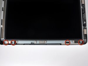

Image 1/3: The last two pictures are detail shots of each side of the display. Image 2/3: The last two pictures are detail shots of each side of the display. Image 3/3: The last two pictures are detail shots of each side of the display.

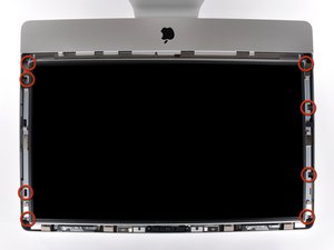

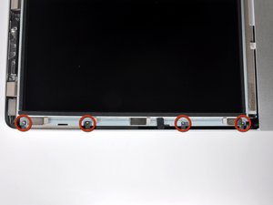

  • Remove the eight 8 mm T10 Torx screws securing the display to the outer case.
  • The last two pictures are detail shots of each side of the display.

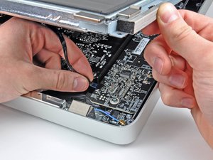

  • Pull the vertical sync ribbon cable out of its socket on the LED driver board near the top left corner of your iMac.
  • The vertical sync ribbon cable has a ZIF style end, but the socket has no lock or retaining flap. Simply pull the cable away from its socket toward the optical drive side of the iMac to disconnect it from the LED driver board.
The vertical sync cable was snug initially and now is loose. I checked and the cable is intact. Has anyone had experience with making it fit better?
Rajan - Reply
Scotch tape on the upper side and sliding this in helped to secure the cable.
Rajan - Reply

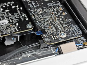

Image 1/3: Disconnect the LED backlight power cable by depressing the locking mechanism while pulling the connector away from its socket (toward the bottom edge of the iMac). Image 2/3: Disconnect the LED backlight power cable by depressing the locking mechanism while pulling the connector away from its socket (toward the bottom edge of the iMac). Image 3/3: Disconnect the LED backlight power cable by depressing the locking mechanism while pulling the connector away from its socket (toward the bottom edge of the iMac).
  • Rotate the display out of the outer case enough to disconnect the LED backlight power cable from the LED driver board.
  • Disconnect the LED backlight power cable by depressing the locking mechanism while pulling the connector away from its socket (toward the bottom edge of the iMac).

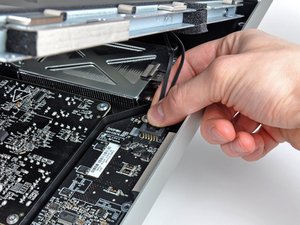

Image 1/1: Pull the display data cable connector away from its socket on the logic board.
  • Squeeze the two display data cable connector arms together to unlock it from its socket on the logic board.
  • Pull the display data cable connector away from its socket on the logic board.
in Step 7, my connector (new 21.5 iMac - Dec 2010) was not attached that way and just came of easily.
erin - Reply

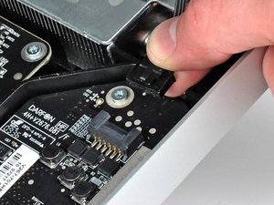

Image 1/1: If your fan is spinning full speed after completion, check this connection or the hard drive's thermal sensor cable.
  • Disconnect the LCD thermal sensor cable connector from its socket on the logic board.
  • If your fan is spinning full speed after completion, check this connection or the hard drive's thermal sensor cable.
This is important regarding the fan running full speed
http://blog.macsales.com/19617-diagnosin...
tobykirkland - Reply
