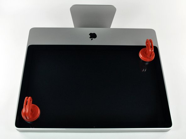

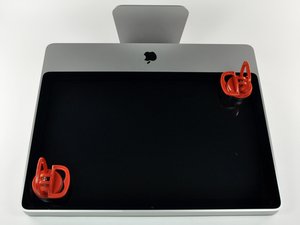

Image 1/2: Stick two suction cups to opposing corners of the glass panel. Image 2/2: To attach the [product|IF145-023|suction cups] we sell, first position the suction cup with the movable handle parallel to the face of the glass panel. While lightly holding the suction cup against the glass, raise the movable handle until it is parallel with the other handle.
  • The glass panel is fixed onto the front bezel with fourteen magnets around its perimeter.
  • Stick two suction cups to opposing corners of the glass panel.
  • To attach the suction cups we sell, first position the suction cup with the movable handle parallel to the face of the glass panel. While lightly holding the suction cup against the glass, raise the movable handle until it is parallel with the other handle.
  • If your suction cups refuse to stick, try cleaning both the glass panel and the suction cup with a mild solvent.
A good alternative to the two heavy duty suction cups is a regular household plunger.
Russell Knight - Reply
Also, 2" wide packing tape. Maybe a 6 or 8" piece, folded in the middle to give you say, a 1-2" "handle". Make a pair of these. They look like a capital T but with a short vertical part (the handle), and a wide top I the sticky wings). Get the good 3M tape, it's strong, and it peels off clean without leaving any glue from the screen.
Barry Coyle - Reply

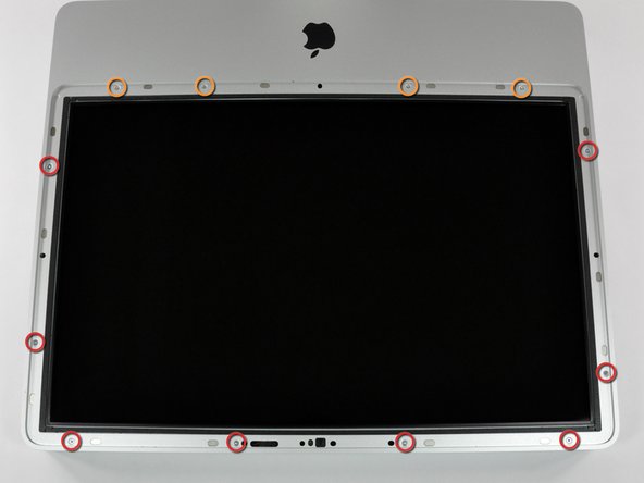

Image 1/1: Eight 13 mm T8 Torx.
  • Remove the following 12 screws securing the front bezel to the rear case:
    • Eight 13 mm T8 Torx.
    • Four 25 mm T8 Torx.
  • On the 24" iMac Intel Model A1225, the bottom center two screws are long (26mm), four on sides (two left, two right) are medium (18mm), and the remaining 6 (four top, two bottom corners) are short (14mm).
I would strongly suggest taping the screws down on a piece of paper towel or cloth in the same order you take them out, as there are different lengths in no particular order and they don't all fit into just any hole. Unless you keep track of which hole each screw belongs, there is no other way of knowing. I stress taping because I didn't tape mine down and after bumping the table I was working on they scattered, leaving me to guess.
Len - Reply
Even better, use an ice cube tray to keep the screws from each step together.
maccentric - Reply
how about using the magnets near the screws to keep their positions?
Andy - Reply
I use an 18 count egg carton (or two) and label each egg slot with a Sharpie. Works great.
airira - Reply
As a rule with iFixit repairs, for years I've been printing the guides, applying scotch magic tape near each picture (which allows me to reutilise the paper prints in the future), neatly putting the appropriate screw next to their picture and taping them down with scotch magic tape.
Even if I have to wait for spare parts, this allows me to neatly file the guide + screws in a copy safe and a binder (or in a cardboard filing box together with the rest of the parts) for later reassembly. Hardly any mistake possible...
Bart Van Dessel - Reply
I think the caption on the picture is wrong here for 24" iMacs - it says: "On the 24" iMac Intel Model A1225, the bottom center two screws are long (26mm), four on sides (two left, two right) are medium (18mm), and the remaining 6 (four top, two bottom corners) are short (14mm)." I think actually bottom centre two are long, then all the rest are medium apart from the two either side of the CD/DVD drive
HBloomfield - Reply
I print out the steps. Get a roll of scotch tape ready. Every screw, or set of screws I remove, I lay on some tape, and then tape them to the number on the directions. Then you have each screw labeled, with direction, and in order, or reassembly. Just working backwards in the directions.
Barry Coyle - Reply

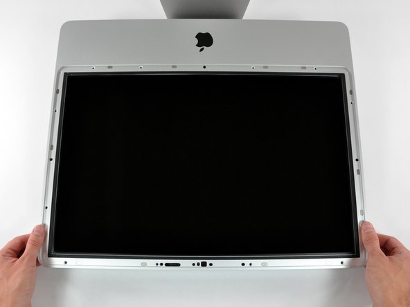

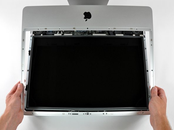

Image 1/2: Gently lift the front bezel from its top edge off the rear case. Image 2/2: Once the top edge of the front bezel has cleared the rear case, rotate the front bezel toward the stand and lift it off the rear case.
  • The front bezel is still attached to the iMac by the microphone cable.
  • Gently lift the front bezel from its top edge off the rear case.
  • Once the top edge of the front bezel has cleared the rear case, rotate the front bezel toward the stand and lift it off the rear case.
  • Rotate the front bezel away from the rest of the device and lay it above the top edge of the iMac.
  • When reinstalling the front bezel, start at the lower edge and make sure it is flush with the rear case before lowering the top edge onto the iMac.
Contrary to the pictures, to lift the front bezel off, start at top of the computer screen lifting up while apply a little bit of pressure to the foam in the upper corners of the screen. This will give you the leverage needed to get the bezel to lift up. Be careful to not pull to fast, as the camera cable is still attached.
armand - Reply

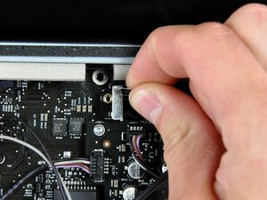

Image 1/1: (located at the top of the logic board on the 24")
  • Pull the LCD temperature sensor connector straight up off its socket on the logic board.
  • (located at the top of the logic board on the 24")

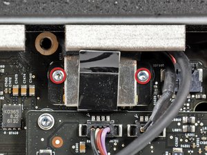

Image 1/2: Use the attached black tab to pull the display data cable connector straight away from the logic board. Image 2/2: Use the attached black tab to pull the display data cable connector straight away from the logic board.
  • Remove the two T6 Torx screws securing the display data cable to the logic board.
  • Use the attached black tab to pull the display data cable connector straight away from the logic board.
I found this to be the most frustrating thing to remove out of everything under the hood. I had to have my wife use her skinny, smaller fingers to jimmy it up, but the tape kept pulling up and separating from the connector. I was worried that I was pulling in the wrong direction (what do I know about logic boards?) and that the tab was going to come off as it is slick tape. She eventually got it, but she did have to use some force. If you don't have a set of skinny fingers, just be patient and use a little force. I think the instructions should tell you to pull straight UP on the black tab, rather than 'away from the logic board', for those of us that don't really understand the technical components/guts of a computer. Honestly, my wife knows less than I do, but she could have done this as easily as me.

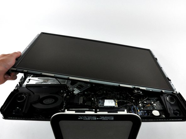

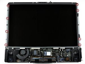

Image 1/2: Lift the display panel from its left edge and rotate it toward the right edge of the iMac. Image 2/2: Lift the display panel from its left edge and rotate it toward the right edge of the iMac.
  • Remove the eight T8 Torx screws securing the display panel to the rear case.
  • Lift the display panel from its left edge and rotate it toward the right edge of the iMac.
Some extra tools I found to be invaluable in this whole process was canned air (used for keyboards and office dust), a microfiber cloth (preferably the one that came with your iMac if you still have it, but you can get these almost anywhere these days)and one of those soft foam monitor covers to put over the monitor while your friend is holding it up (a soft sheet or towel might work too). If your computer is a few years old like mine, there will be a considerable amount of dust that you will want to clear out (and will fly everywhere anyway). Once you cleared that out and replace the hard drive, wait until you've got the bezel and screws back on before using the canned air and microfiber cloth to make sure all dust and lint is clear of the monitor. This is where the second person will come in handy again. They can wipe while you spray. Get your glass top with suction cups still attached ready and wipe that with the cloth and air as well. While your friend does one last wipe of the glass and then the monitor, put the glass on as soon as possible so no more lint or dust falls onto the monitor. I did this and the monitor looks as beautiful and clear as the day I bought the iMac. It is truly a brilliant and beautiful design by Apple and LG.
Len - Reply
In this step, as I lifted the display, there was also a small cord in the front, near the fan, that was connected from the display to the inside panel. As I lifted, it unplugged. Anyone know what this is and where it goes when I put it all back together? Pic of the cord I'm referring to: http://i68.tinypic.com/keubkg.jpg
shauhncy - Reply

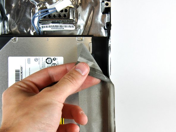

Image 1/2: Image 2/2:

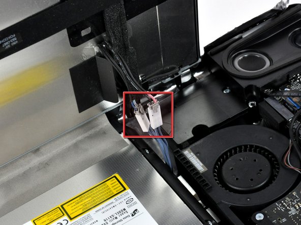

  • Peel the strip of EMI tape off the edge of the rear case.

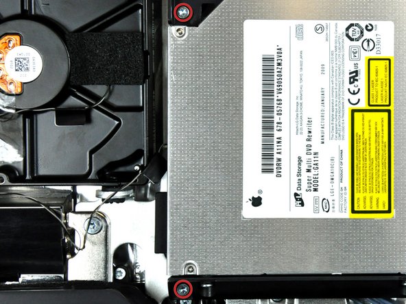

Image 1/1:
  • Remove the two T10 Torx screws securing the optical drive to the rear case.

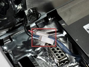

  • If necessary, remove the piece of tape holding the thermal sensor wires to the hard drive.
Image 1/1: When removing this connector, it is helpful use your thumbnails to push the ears on either side of the connector toward the top of your iMac.
  • Pull the optical drive thermal sensor connector straight away from its socket on the logic board.
  • When removing this connector, it is helpful use your thumbnails to push the ears on either side of the connector toward the top of your iMac.

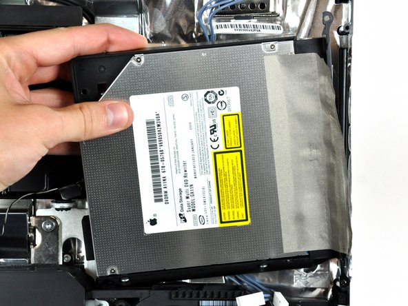

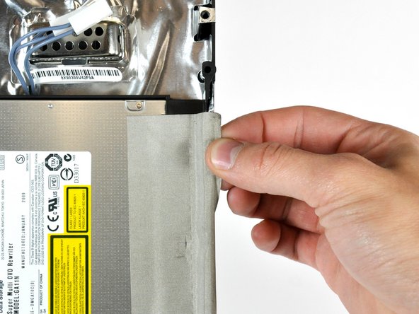

Image 1/1:
  • Lift the left edge of the optical drive slightly and pull it away from the right side of the rear case.

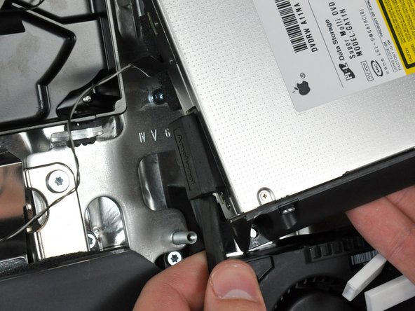

Image 1/1: Twist the spudger to slightly separate the optical drive connector from the optical drive, then use your fingers to pull the connector away from the drive.
  • Insert a spudger between the optical drive connector and the optical drive.
  • Twist the spudger to slightly separate the optical drive connector from the optical drive, then use your fingers to pull the connector away from the drive.

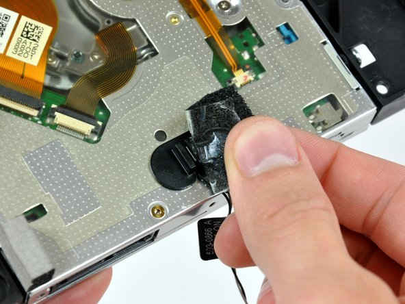

Image 1/1:
  • Remove the piece of foam tape covering the optical drive thermal sensor.

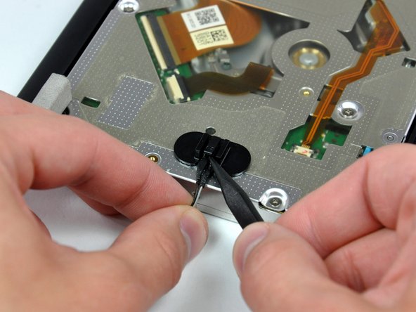

Image 1/1: If your thermal sensor is stuck to the optical drive, use the flat end of a spudger to pry the thermal sensor bracket off the drive.
  • To remove the optical drive thermal sensor, use the tip of a spudger to lift the center finger of the thermal sensor bracket while applying slight tension to the thermal sensor cable.
  • If your thermal sensor is stuck to the optical drive, use the flat end of a spudger to pry the thermal sensor bracket off the drive.
  • If the adhesive on the bracket refuses to stick, apply some double stick tape to the underside of both flat bracket ears.
