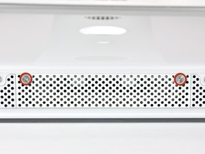

  1. iMac Intel 20" EMC 2105 and 2118 Hard Drive Replacement, Access Door: step 1, image 1 of 2 iMac Intel 20" EMC 2105 and 2118 Hard Drive Replacement, Access Door: step 1, image 2 of 2

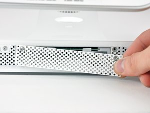

    • Loosen the two Phillips screws securing the access door to your iMac.
    • Both screws remain captive within the access door.
    • Remove the access door.
    • Before beginning the repair, unplug the computer and press and hold the power switch for 20-30 seconds, to discharge internal capacitors.

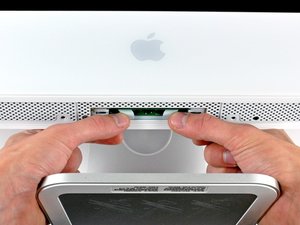

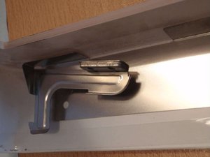

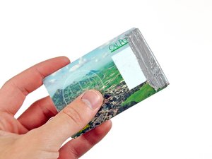

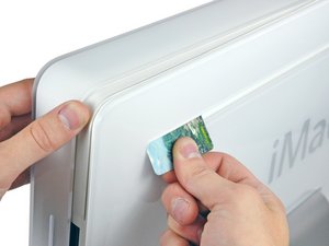

    • Re-orient your iMac so it sits upright on the stand.
    • Insert a plastic card up into the corner of the air vent slot near the top of the rear case.
    • Push the card toward the top of the iMac to release the front bezel latch.
    • Pull the front bezel away from the rear case.
    • Repeat this process for the other side of the front bezel.
    • It may be necessary to apply several layers of duct tape to the top of the access card to aid in releasing the latches. Or use two cards for the additional thickness.
    • If the bezel refuses to release, try lifting the lower edge of the front bezel slightly away from the rear case (detailed in the next few steps) and repeat the latch release process.

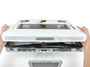

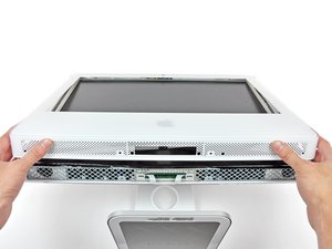

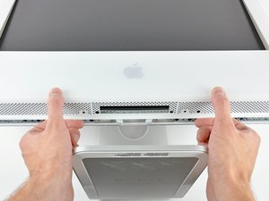

    • Lay your iMac stand-side down on a flat surface.
    • To lift the front bezel off the iMac, simultaneously:
    • Use your thumbs to press in the RAM arms and hold the iMac down.
    • Use your index fingers to pull the small bridge of material on the front bezel toward yourself.
    • Pull the front bezel up with your index fingers.
    • Once the small bridge of material has cleared the RAM arms, lift the front bezel by its lower edge just enough to clear the bottom edge of the rear case.
  5. iMac Intel 20" EMC 2105 and 2118 Hard Drive Replacement: step 5, image 1 of 2 iMac Intel 20" EMC 2105 and 2118 Hard Drive Replacement: step 5, image 2 of 2
    • Lift the front bezel off the rear case and rotate it away from the bottom edge of the iMac, minding the camera and microphone cables still attached to its upper edge.

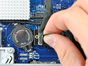

  7. iMac Intel 20" EMC 2105 and 2118 Hard Drive Replacement: step 7, image 1 of 3 iMac Intel 20" EMC 2105 and 2118 Hard Drive Replacement: step 7, image 2 of 3 iMac Intel 20" EMC 2105 and 2118 Hard Drive Replacement: step 7, image 3 of 3
    • Disconnect the microphone cable.
    • Disconnect the camera cable by pulling its connector away from the socket on the camera board.
    • The camera cable connector and socket are delicate and easily bent. Remove with caution.

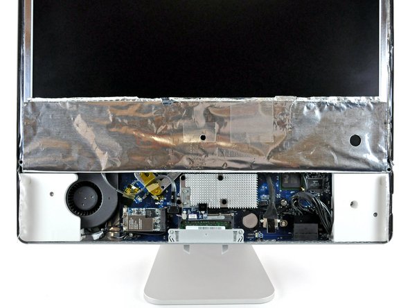

  8. iMac Intel 20" EMC 2105 and 2118 Hard Drive Replacement, Lower EMI Shield: step 8, image 1 of 1
    • Peel up the lower EMI shield from the rear case.
    • It is only necessary to peel the shield up from three sides. Leave it attached to the display.
    • If you happen to rip the EMI shield, use a piece of foil tape to cover the tear.
  9. iMac Intel 20" EMC 2105 and 2118 Hard Drive Replacement: step 9, image 1 of 1
    • Tape the EMI shield to the face of the display to keep it out of the way.

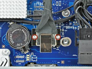

    • Remove the two 5 mm T6 Torx screws securing the display data cable connector to the logic board.
    • Pull the display data cable connector up off the logic board by its black pull tab.

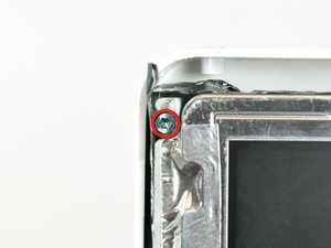

    • Allow the lower EMI shield to hang down from the display.

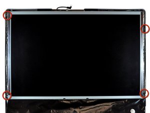

    • Remove the four 7.5 mm T10 Torx screws securing the display to the rear case.
    • The screws are recessed, so a thin magnetic screwdriver aids in removal. Most bit drivers are too short to reach these screws.

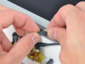

  14. iMac Intel 20" EMC 2105 and 2118 Hard Drive Replacement: step 14, image 1 of 2 iMac Intel 20" EMC 2105 and 2118 Hard Drive Replacement: step 14, image 2 of 2
    • Disconnect both inverter cables from the inverter board.
    • These connectors are seated very tightly in their sockets. It is helpful to use your fingernails or the tip of a spudger to push the ears on either side of the connectors to dislodge them from their sockets. A small pair of hemostats helps a lot.
  15. iMac Intel 20" EMC 2105 and 2118 Hard Drive Replacement: step 15, image 1 of 1
    • Disconnect the two inverter cables at the top edge of the inverter using the method explained in the previous step.

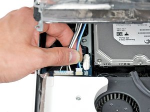

    • Disconnect the hard drive thermal sensor from the top edge of the logic board.
    • Pull the connector parallel to the face of the logic board.

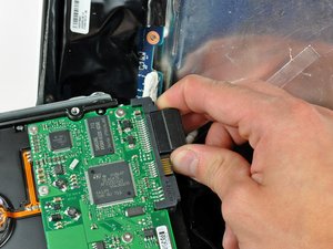

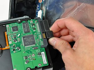

    • Pull both the SATA power and data cable connectors away from the hard drive.
    • Be careful when de-routing the hard drive thermal sensor cable from under the heat sink framework.

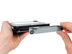

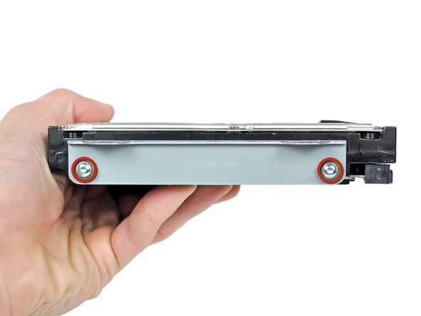

    • Remove the two 12 mm shouldered T8 Torx screws holding the hard drive bracket to the connector side of the hard drive.
    • After removing these two screws, the bracket will fall away from the hard drive.

A small feedback from my iman. (Late 2006, early 2007 20" display 2.16 intel core 2 duo):
Just changed my hdd and everything worked out fine. Two things are important as I found out that they differed from this guide:
1. In order to release the front bezel latches the card must be not be inserted vertically as shown in the pictures but with a slight angle using the direction from inside towards the upper corner of the bezel. I saw this in the following youtube video:
http://youtu.be/fOQ3joWnU-s
2. The torx requested to release the display screws is not a No 6 but a smaller one. Probably a No. 4, Ι am not sure exactly as I did not have one so I used a normal small screwdriver instead.
I hope I helped, the rest of the guide was very accurate and quite easy to follow.
Peppitos - Reply
