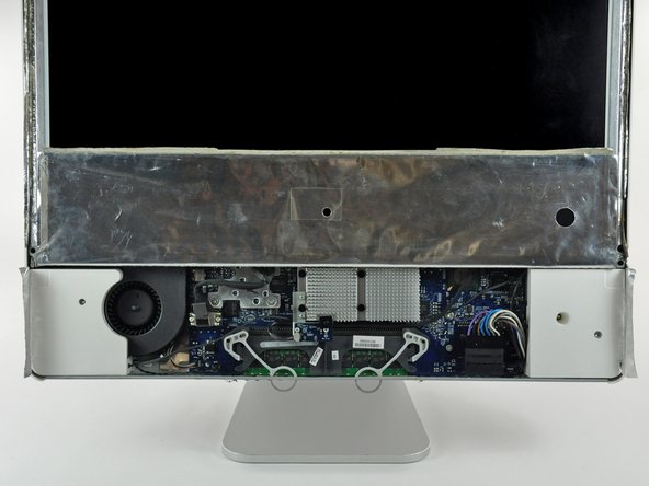

2 Edit Step 7  ¶
Image 1/1: Lift the front bezel from its lower edge and rotate it away from the rest of your iMac, minding the RAM arms that may get caught.
2 Edit Step 7  ¶
  • Lay your iMac stand-side down on a table.
  • Lift the front bezel from its lower edge and rotate it away from the rest of your iMac, minding the RAM arms that may get caught.
  • Lay the front bezel above the rest of the iMac.

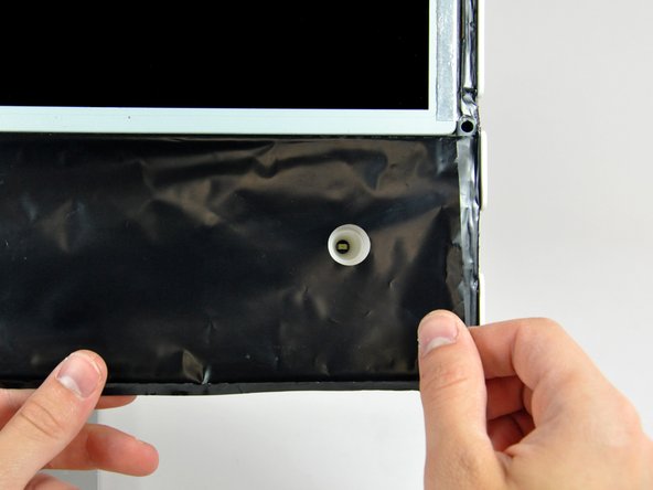

Edit Step 10 Lower EMI Shield  ¶
Image 1/1: It is not necessary to peel the lower EMI shield off the display.
  • Peel the lower EMI shield off the lower edge of the iMac and off the two vertical 4" sections on either side of the iMac.
  • It is not necessary to peel the lower EMI shield off the display.

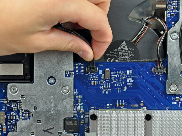

  • Disconnect the hard drive thermal sensor from the logic board by pulling its connector toward the top edge of your iMac.

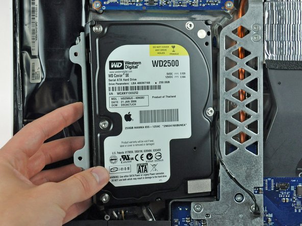

Image 1/1: When reinstalling your hard drive, make sure not to push the rubber grommets through the chassis with the hard drive mounting pins as retrieving them may require removing the logic board.
Edit Step 21  ¶
  • Lift the left edge of the hard drive slightly, then pull it toward the left edge of the iMac.
  • When reinstalling your hard drive, make sure not to push the rubber grommets through the chassis with the hard drive mounting pins as retrieving them may require removing the logic board.

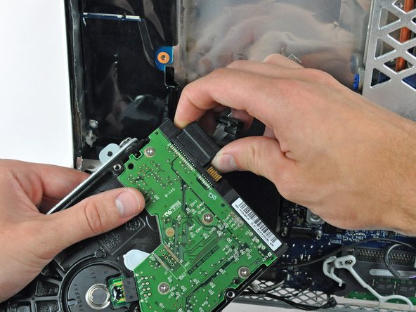

Image 1/1: Disconnect the SATA data cable by pulling its connector away from the hard drive.
Edit Step 22  ¶
  • Rotate the hard drive out of the rear case.
  • Disconnect the SATA data cable by pulling its connector away from the hard drive.

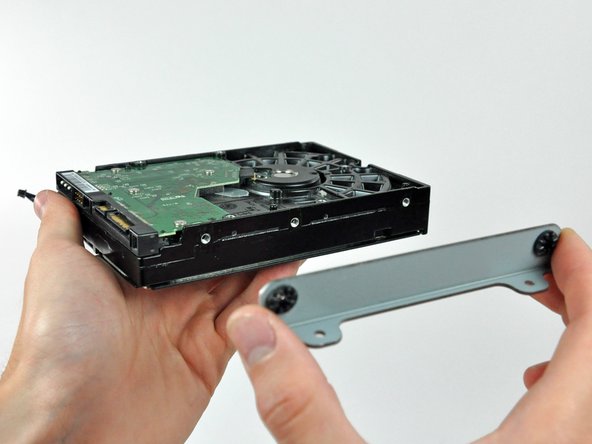

Image 1/2: Remove the hard drive bracket.
Edit Step 24 Hard Drive  ¶

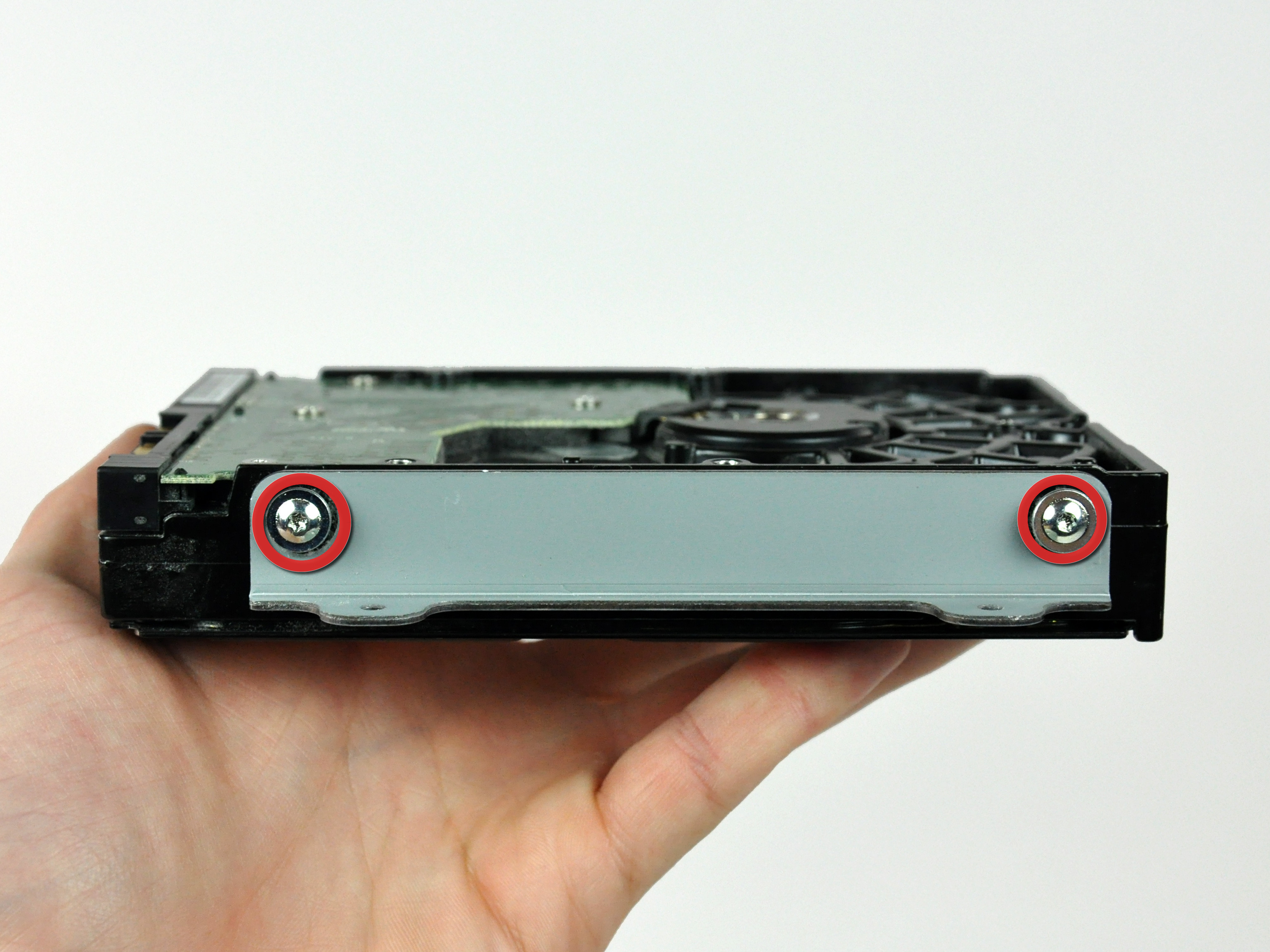

  • Remove the two T8 Torx screws securing the hard drive bracket to the connector side of the hard drive.
  • Remove the hard drive bracket.

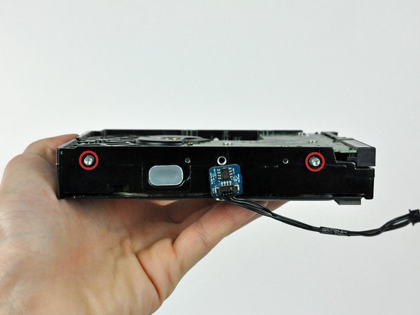

  • Remove the two T8 Torx pins from the side of the hard drive.
Edit Step 26  ¶
Image 1/1:
Edit Step 26  ¶

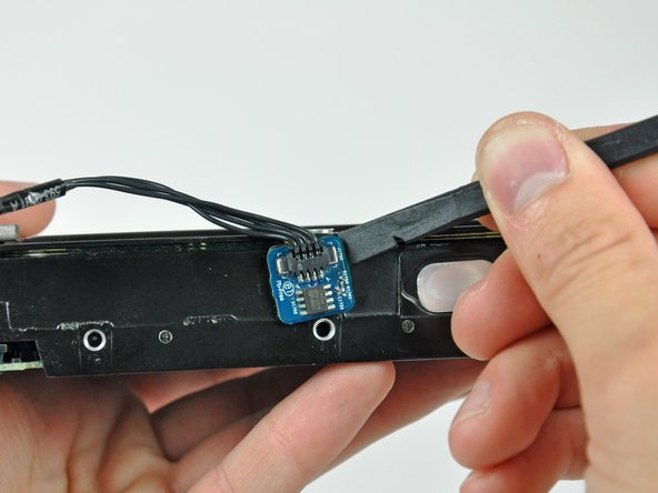

  • Use the flat end of a spudger to pry the hard drive thermal sensor off the adhesive securing it to the hard drive.
