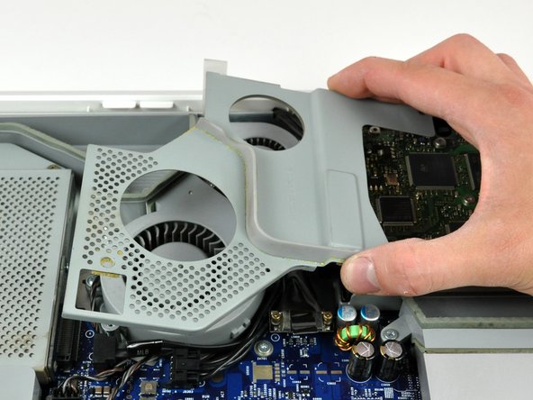

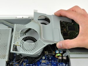

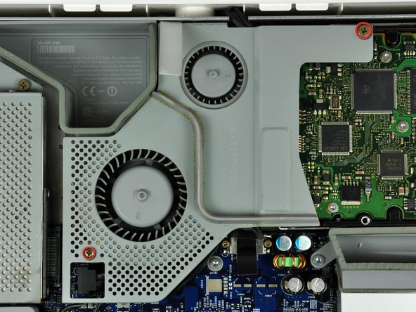

Image 1/2: The shouldered screw belongs in the lower left corner of the fan cover.
  • Remove the two Phillips screws securing the fan cover to the midplane.
  • The shouldered screw belongs in the lower left corner of the fan cover.
  • Lift the fan cover up off midplane.

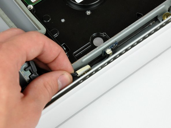

Image 1/1: During reassembly, plug in the hard drive thermal sensor before lowering your new hard drive into the midplane.
  • Disconnect the hard drive thermal sensor cable from the hard drive thermal sensor.
  • During reassembly, plug in the hard drive thermal sensor before lowering your new hard drive into the midplane.

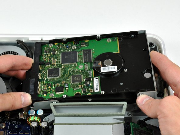

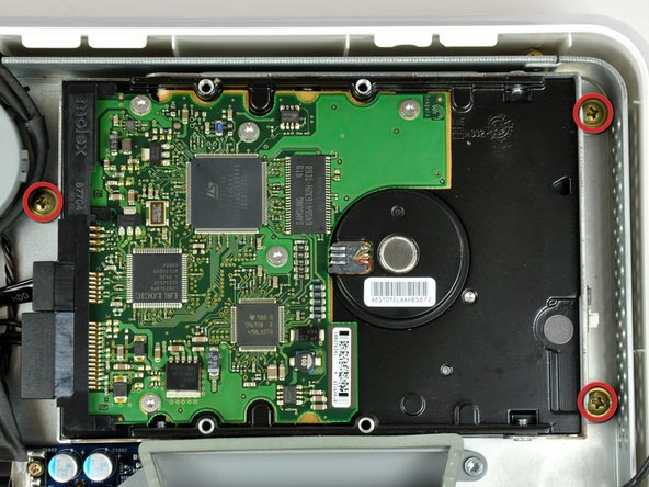

Image 1/2: Lift the hard drive from its right edge and maneuver it out of the midplane.
  • Remove the three Phillips screws securing the hard drive to the midplane.
  • Lift the hard drive from its right edge and maneuver it out of the midplane.
  • The hard drive is still connected to the motherboard.

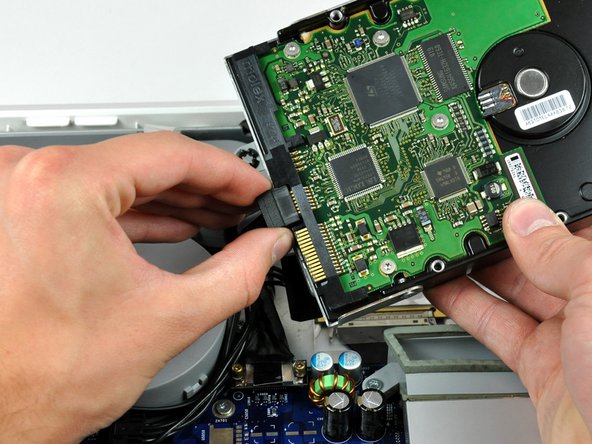

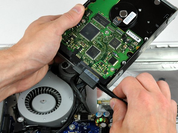

Image 1/2: Twist the spudger counter-clockwise to slightly separate the SATA power cable connector from its socket on the hard drive.
  • Insert the flat end of a spudger between the SATA power cable connector and the body of the hard drive.
  • Twist the spudger counter-clockwise to slightly separate the SATA power cable connector from its socket on the hard drive.
  • Pull the SATA power cable connector away from the hard drive.
Image 1/1:
  • Pull the SATA data cable connector away from the hard drive.

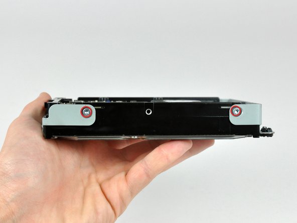

  • Remove the two T10 Torx screws from both sides of the hard drive (four screws total).

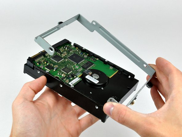

Image 1/1: Hard drive remains.
  • Lift the hard drive bracket off the hard drive.
  • Hard drive remains.
  • If you are installing a new hard drive, we have an OS X install guide to get you up and running.
