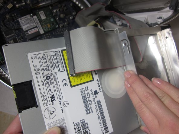

  13. iMac G4 17 800 MHz EMC 1936 Optical Drive Replacement, Optical Drive: step 13, image 1 of 1
    • Remove the four T-10 6mm screws at the sides of the drive.
  14. iMac G4 17 800 MHz EMC 1936 Optical Drive Replacement: step 14, image 1 of 1
    • Slide the optical drive out of the carrier
