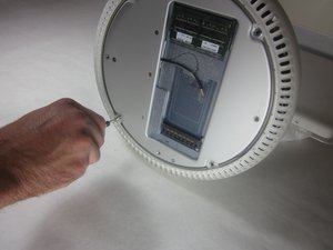

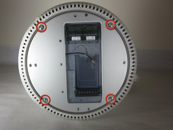

  • Unplug all the cables from the computer, including the power cable. Lay the computer face-down, supporting the neck and base with a soft cloth under the screen.
Image 1/1:
  • Loosen the four Phillips #0 screws.
Image 1/1:
  • Carefully remove the base access panel.

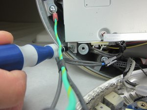

  • Remove the four 25mm T-15 screws.
Image 1/2: Be gentle with the wires still connected to the logic board  so as not to ruin the cables.
  • Open the housing plate.
  • Be gentle with the wires still connected to the logic board so as not to ruin the cables.
  • A fixed plug connector between the logic board and upper unit will cause some resistance. Pull gently but firmly.

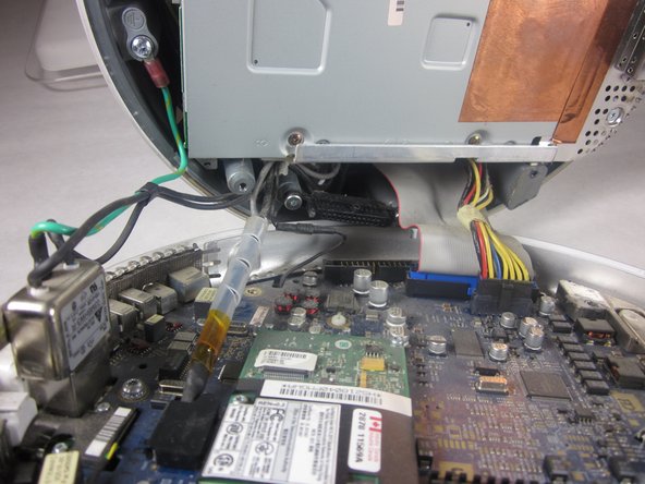

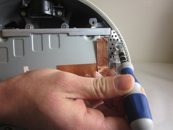

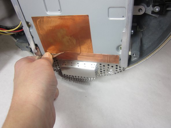

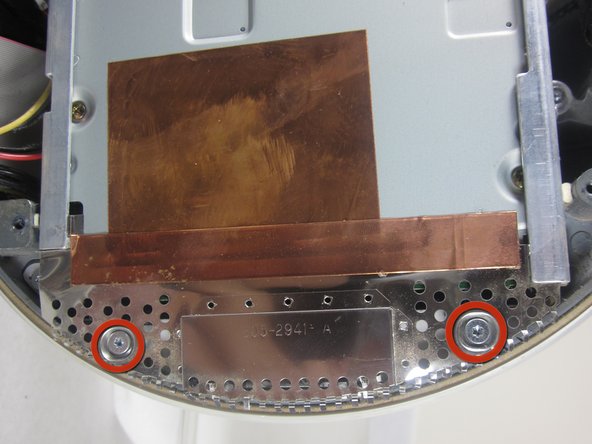

Image 1/3: Carefully remove shield and copper tape
  • Remove the 2 torx 10mm screws on the EMI shield
  • Carefully remove shield and copper tape

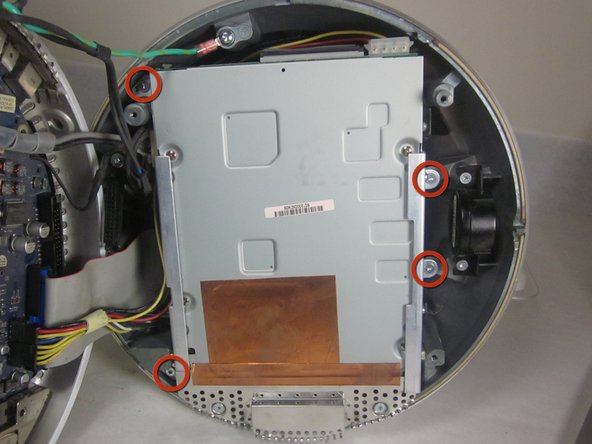

Image 1/2: The drive carrier includes optical drive and hard drive.
  • Remove the 4 10mm torx screws attatched to the drive carrier.
  • The drive carrier includes optical drive and hard drive.

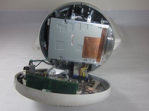

Image 1/1: Remove the carrier by lifting up and out.
  • Grasp the carrier with both hands on each side.
  • Remove the carrier by lifting up and out.
  • Pull gently but firmly. The carrier is meant to fit snugly.

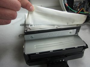

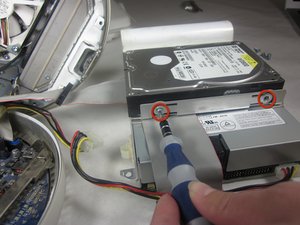

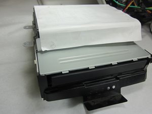

Image 1/3: Remove the 4 T-10 5mm screws connecting the hard drive and frame. (There are 2 screws on each side)
  • Peel back the white paper, revealing the screws that connect the hard drive to the carrier.
  • Remove the 4 T-10 5mm screws connecting the hard drive and frame. (There are 2 screws on each side)
Image 1/1:
  • Slide the hard drive out from the frame and optical drive.
