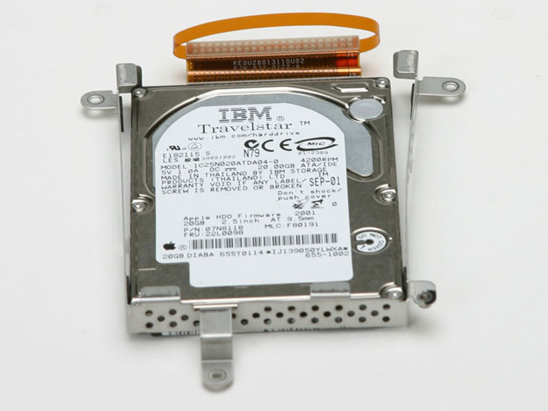

  • Remove the three 5 mm standoffs securing the hard drive to the logic board.
Image 1/1: Lift the hard drive, with metal bracket attached, from the logic board.
  • Pull the hard drive cable up from the logic board, using the plastic loop.
  • Lift the hard drive, with metal bracket attached, from the logic board.
Image 1/1: Disconnect the hard drive cable from the hard drive by applying even pressure on both sides while maintaining a firm grip on the drive itself.
  • Take the metal bracket away from the hard drive.
  • Disconnect the hard drive cable from the hard drive by applying even pressure on both sides while maintaining a firm grip on the drive itself.
  • This is a bit tricky. Try holding the drive against your body while pushing the cable away from you, or rocking the cable gently from side to side while applying even pressure, or both. If you bend the pins, do your best to straighten them, using the hard drive cable as a guide.
