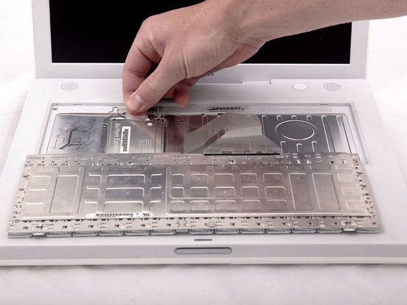

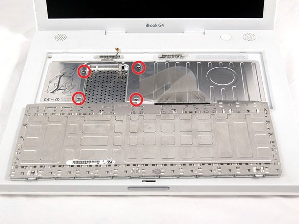

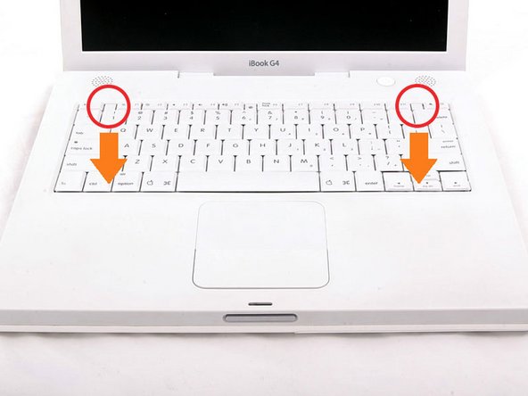

Pull the keyboard release tabs toward you and lift up on the keyboard until it pops free.

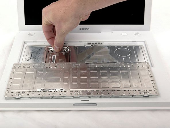

Flip the keyboard over, away from the screen, and rest it face-down on the trackpad area.

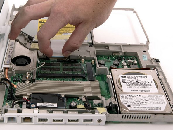

Push the wire clasp away from the AirPort card and toward the display, then rotate up to free it from the RAM shield.
Hold the AirPort card in one hand and use your other hand to remove the antenna cable.

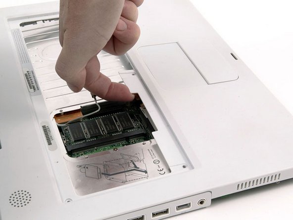

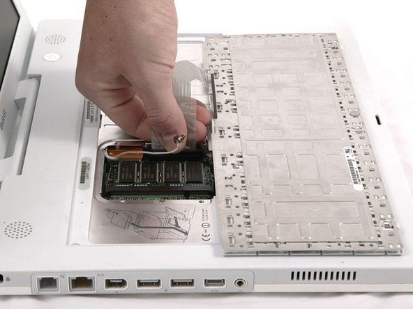

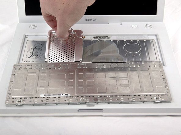

Grasp the metal bracket on top of the RAM shield and pull upward to remove the shield.
Pull the keyboard cable up from the logic board, holding the cable as close to the connector as possible.

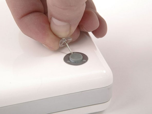

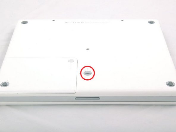

Use a pin (or anything you like) to remove the three rubber feet from the lower case.
Use a spudger or small flathead screwdriver to pry up the three metal rings that housed the rubber bumpers.
Remove the three hex screws using a T8 Torx screwdriver (or Allen screws using an Allen key if these are used).

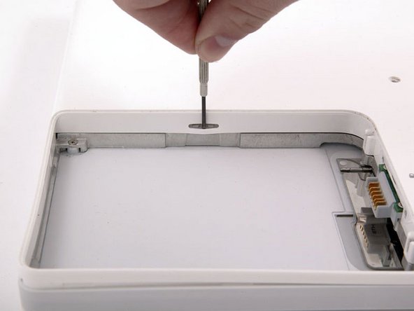

Push the thin rims of the lower case surrounding the battery compartment in, bending them past the tabs, and then lift up to free that corner of the lower case.
There is a slot on the wall of the battery compartment that locks the lower case in place. Use a small flathead screwdriver to pry out the slot's lower rim and pull up on the lower case to free the slot from the tabs holding it.

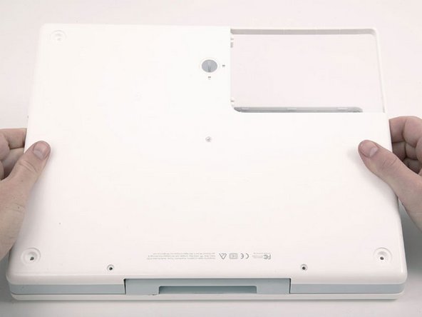

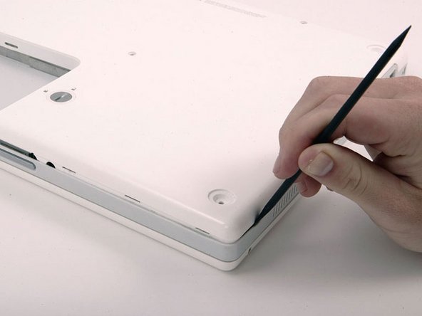

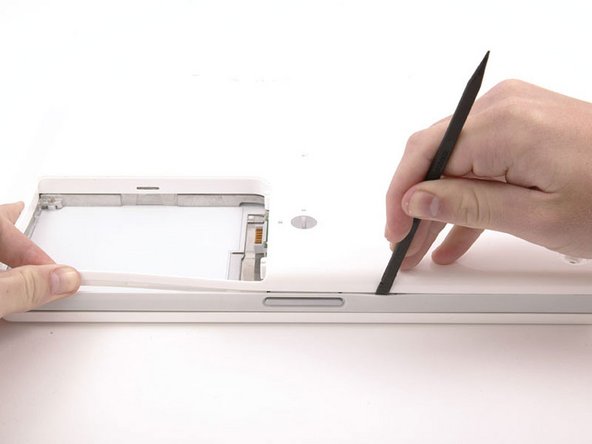

Run a spudger along the seam between the lower case and upper case on the front of the computer to free the tabs locking the lower case. Pull up on the lower case and continue to use the spudger as necessary until you hear three distinct clicks.
Continue to run the spudger around the front, right corner. There are two tabs on the port side of the computer, one near the front corner and one near the sound-out port.
There are three tabs over the optical drive that must be released before the lower case can come off. Slide the spudger into the lower case above the optical drive and run it toward the back of the computer until you hear three distinct clicks.
Once the front and sides of the lower case are free, turn the computer so that the back is facing you and pull the lower case up and toward you until the back tabs pop free (it may be helpful to jiggle the case up and down).

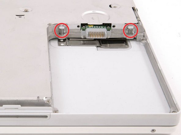

Remove the small greasy springs with white plastic caps from either side of the battery contacts.

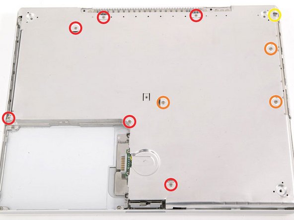

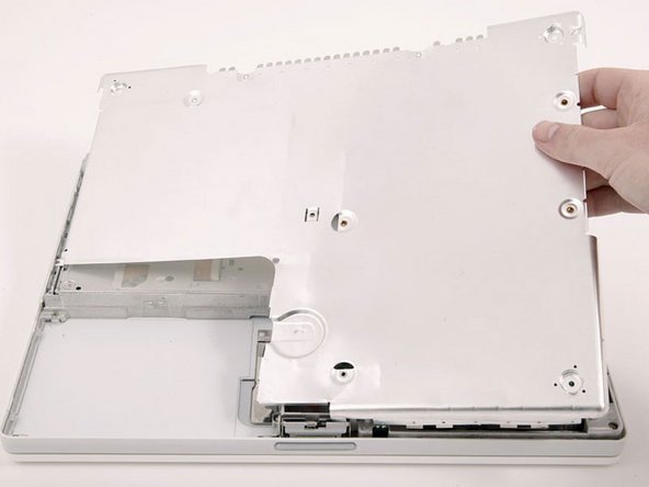

Remove the following 10 screws from the bottom shield:
Six 3 mm Phillips
Three 7.5 mm Phillips
One 14 mm Phillips

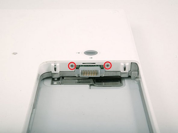

Deroute the cable from around the optical drive, removing tape as necessary, and angle the DC-In board out of its compartment.

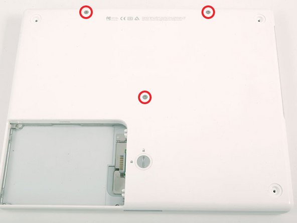

Remove the following 11 screws from the bottom of the computer:
Three 3 mm Phillips around the battery compartment. (Some models may only have two screws.)
Three 4.5 mm Phillips along the optical drive bezel. (a magnetic screwdriver may help to lift these screws out)
One 11 mm Phillips in the lower right corner. (if present)
Four 14.5 mm Phillips.

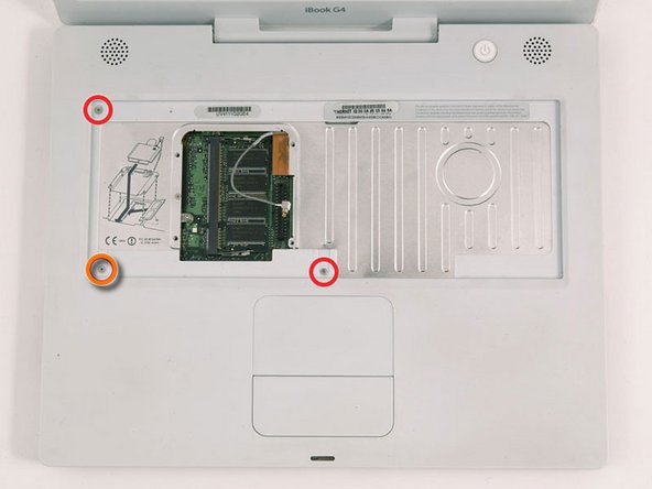

Remove the 2 Phillips screws (3mm) from the edges of the keyboard area.
Remove the 4 mm Phillips screw from the lower left corner.

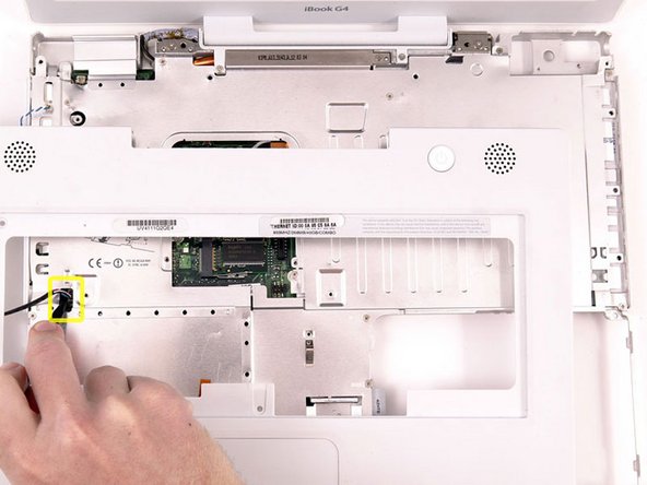

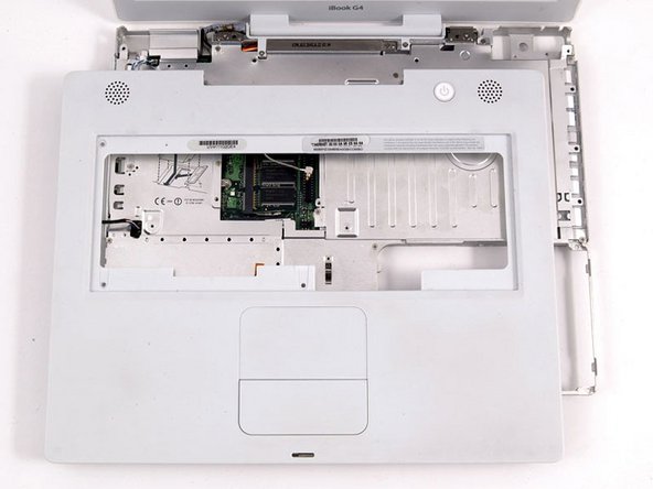

Lift the upper case and use a spudger or your finger to disconnect the trackpad connector hidden beneath the white plastic tab. Due to model variatons your trackpad connector may be different than the one pictured.
Carefully lift the upper case about half of an inch and move it so that you can access the power and speaker cables.

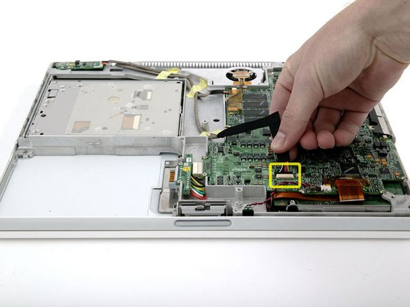

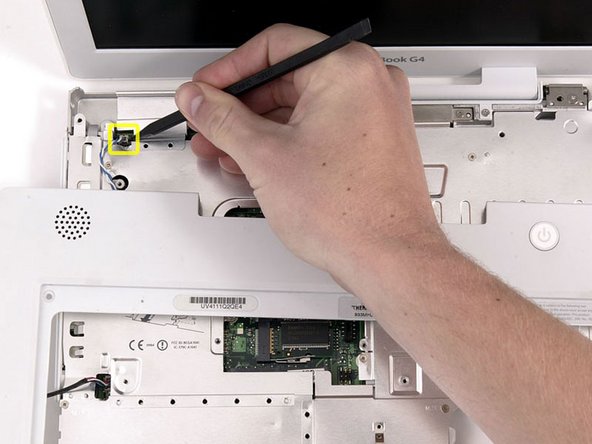

Lift the upper case enough to disconnect the blue and white power cable from the logic board. Using your fingernails or a dental pick, carefully pry the connector from its socket. Make sure you're pulling only on the connector and not on the socket.
Carefully disconnect the multicolored speaker cable from the logic board. As before, make sure you're pulling only on the connector and not on the socket.

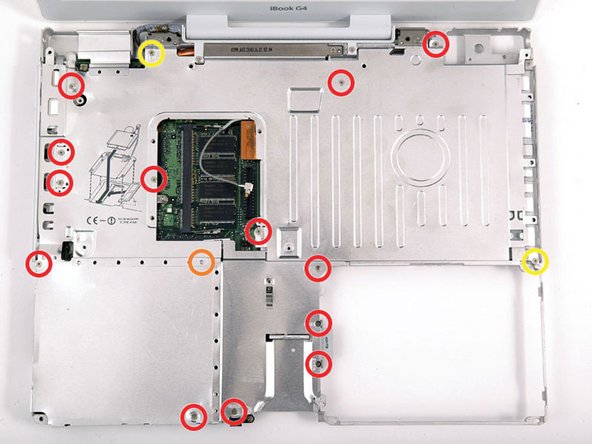

Remove the following 16 screws:
Thirteen 3 mm Phillips.
One 3 mm Phillips. (actual screw not present in image)
Two 4 mm Phillips.
Lift the top shield up from the right side, minding the upper left corner, which may catch on the metal framework.

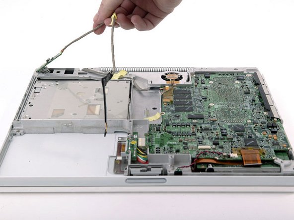

If your iBook has Bluetooth, as discussed in the previous step, you will need to slide the antenna through the lower I-shaped hole in the shield before completely removing the shield.

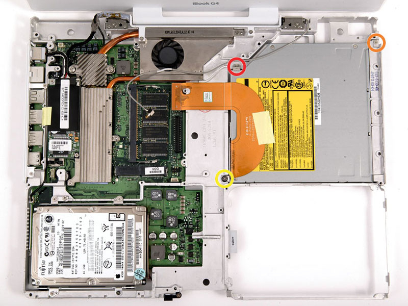

Remove the following 3 screws:
One 3 mm Phillips in the channel between the optical drive and fan.
One 6 mm Phillips from the upper end of the drive bezel.
One 6 mm Phillips with a collar from bracket extending from the lower left corner of the drive.

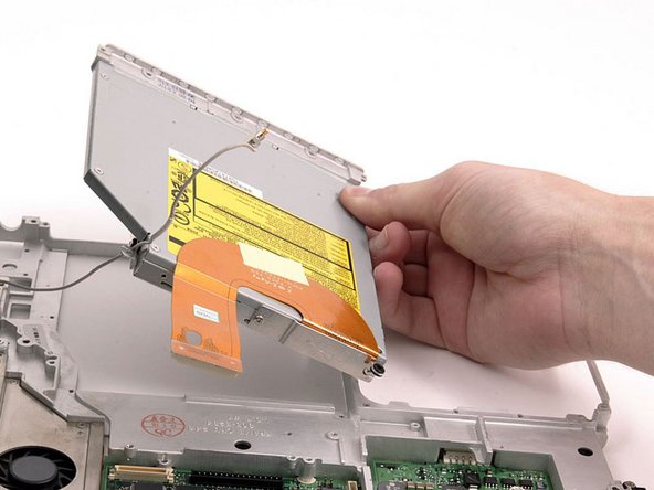

1) With your fingernails, grasp the locking bar on either side and pull up a small amount (about 1/16" or 2 mm).
2) After disengaging the locking bar, slide the cable out of the connector.

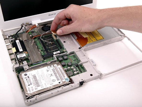

Release the optical drive ribbon clamp as described above. Slide the optical drive ribbon out of its connector.
Remove the two Phillips screws securing the metal bracket and cable to the back of the optical drive.
Peel the cable up from the top of the optical drive, removing tape as necessary, and disconnect it.

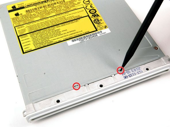

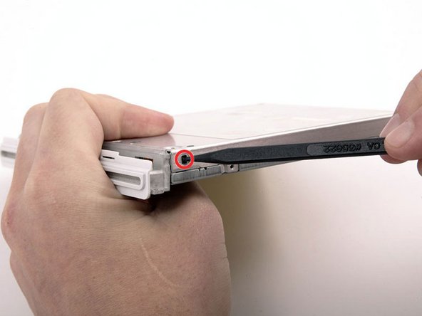

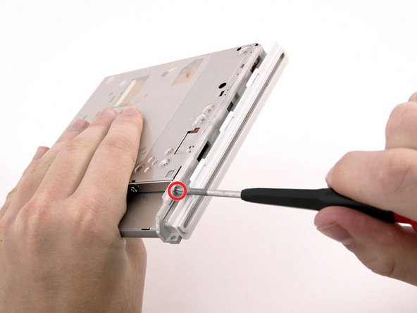

Remove the single Phillips screw securing the bezel at the front of the optical drive.
Hold the optical drive on its side and depress the remaining tab to free the bezel from the drive.

For me, this was really the toughest part! Trying to find/get a good grip on the iBook and really *forcing* that spudger around. All without scratching the display.
bccreative - Reply
Once you loosen the the front the seam is very tight. I was able to slide the spudger in the middle of the port side instead of starting at the corner.
Robert Oliver - Reply

This was the scariest part for me. I had to wiggle it a lot as it seemed to be stuck. But it did come loose.

My dc board had 2 screws. for some reason when i tried to screw them both back in only one got tight. the other one just kept twirling so i left it out. i didnt want to have a loose screw rattling around in my computer.
also had trouble laying down the wire to the dc board. it wouldnt lay flat but i was able to get it flat enough. overall it worked and the computer is now up and running!

This is the first screw of the many on this part of the tear down that really needs the Phillips #00 screwdriver.
turtlejp - Reply

My 1 GHz DC board had two Phillips, one on the far left and one next to the Z10B label.
geekspeak - Reply

On this iBook, the DC board had a small Phillips screw on it.
adamprall - Reply
Woops - never mind - neglected the screw from previous step.

The middle screw along the optical drive got sucked sideways into an opening by something magnetic and proved impossible to get out with a bit of blutack on the end of a screwdriver. In the end turning it over and giving it a smart tap worked.
tatterjack - Reply
- the 3 red screws located around the battery compartment are absent. (I never opened my
G4 before).
- the 3 orange screws along the optical drive bezel are deep located and I can't see where to
place the screwdriver. By trying I run the risk to damage the screw head.
su40 - Reply
I realized that there are no screws 3 red and3 orange, the are only 4 green ones and a yellow one.
su40 - Reply
Step 28
bottom right philips head screw removed just fine. Upper and lower left don't seem to fit any of my philips screwdrivers. What size are those screws?
jimryan - Reply
The "two 3mm" screws are actually 4mm and the 4mm (orange) is the 3mm
tjod - Reply
Step 31
I have pulled it off, now what?????
Ester - Reply
I have fixed it!! Whooohooo!!
Bought a soldering bolt and wire, and fixed it in 10 minutes myself, I'm so proud of me..... ;)
But I hope I won't have to open it again! And the 3 screws which are left.... hmmmm never mind. :D
Ester - Reply
Yup. Take off that shield first. I'm lucky my father in law is good at soldering, because I'm not, and that power switch connector fell off the moment I touched it....
Jaddle - Reply
I skipped this and the next step altogether. Instead of taking the risk of breaking the power and/or speaker sockets, I left them connected. I put a stack of big books just to the left of the iBook. I swiveled the top case off and let it lean against the books. I removed the top shield and carefully swiveled it off and to the left, so it is now leaning on the top case. I had to move the power cable out of the way, and re-orient the top case so it's resting on it's back edge while the shield was resting on it's left edge. Then I slid the iBook towards the edge of the table and disconnected the HD ribbon from below! I then proceeded with removing the HD and putting in the new one.
Hilal Malawi - Reply
When putting the rings back you will need to figure out their correct orientation. Just rotate each ring until you find the position that will make it flush with the case. There are three possible positions but only one of them is the right fit.
As the other comments make plain, you can't overemphasize that the power connector is in tight, and it is much easier to pull the connector off the board. That's what happened to me -- I'm really bad at soldering, so I will be looking for a replacement board. Oh well.
Don Solomon - Reply

these connectors can be very loose and break from the logic board. I have left this one connected until after the next step, at which point I can pull it out more carefully and easily.
-Dan "The Berkeley Mac Guy"
Dan Fries - Reply
I second Dan's method. The top shield makes it impossible to pry between the connector and its socket. The socket is so poorly affixed to the logic board that you must be very careful to apply leverage between the connect and socket.
Kent - Reply

Missing in this photo is the Bluetooth antenna present in some iBooks. It is located at the upper right corner of the battery compartment, just above the 4mm screw. You can see the bracket for the antenna in the photo. It is the two I-shaped holes just above the 4mm screw that must be removed in this step. To remove the antenna, slide it toward the LCD, and tilt it vertically back towards yourself. In the next step, where the shield is removed, you will need to slide the antenna through the lower I-shaped hole.
Sean Brannon - Reply

The shield on this iBook had a small sensor threaded through the opening directly above the battery compartment opening, on the right near the edge of it. I just carefully threaded the sensor through that hole in order to remove the shield.
adamprall - Reply
