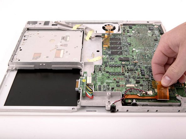

Turn the computer over and disconnect the orange hard drive cable, removing tape as necessary.
Lift the hard drive up, carefully guiding the cable through the slot in the lower case.

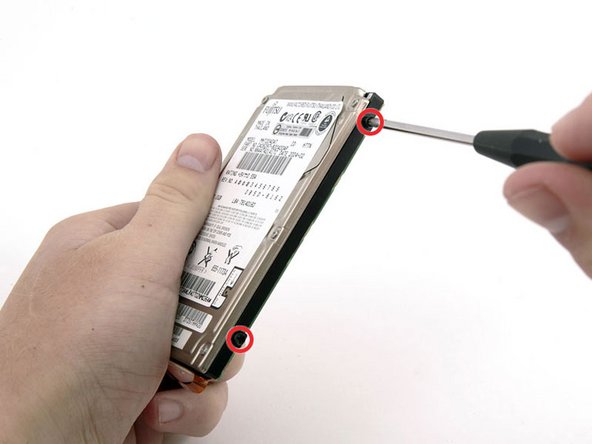

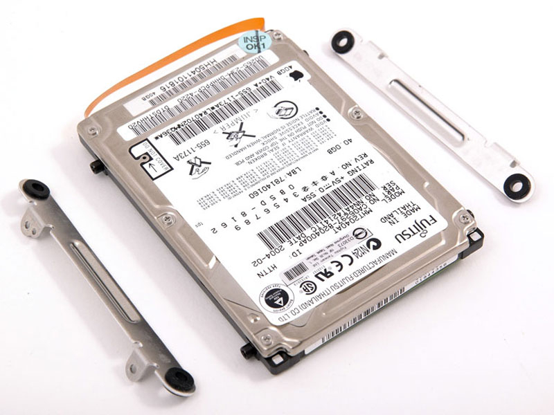

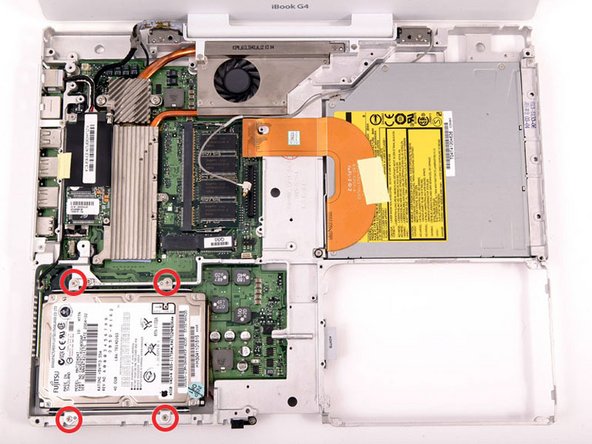

Remove the hard drive brackets from the left and right sides of the hard drive.
Remove the two black T8 Torx screws from either side of the hard drive (four screws total).

On my iBook, the hard drive was much easier to deal with than it appears in the Guide. My hard drive was connected to the board with a ZIF-type connector, held in place with a gray plastic bracket secured by two screws. After removing the bracket, I just had to ease the drive up and out. Then the gray plastic connector had to be pulled off the pins and transferred to the new drive along with the bumpers, etc.
Don Solomon - Reply
