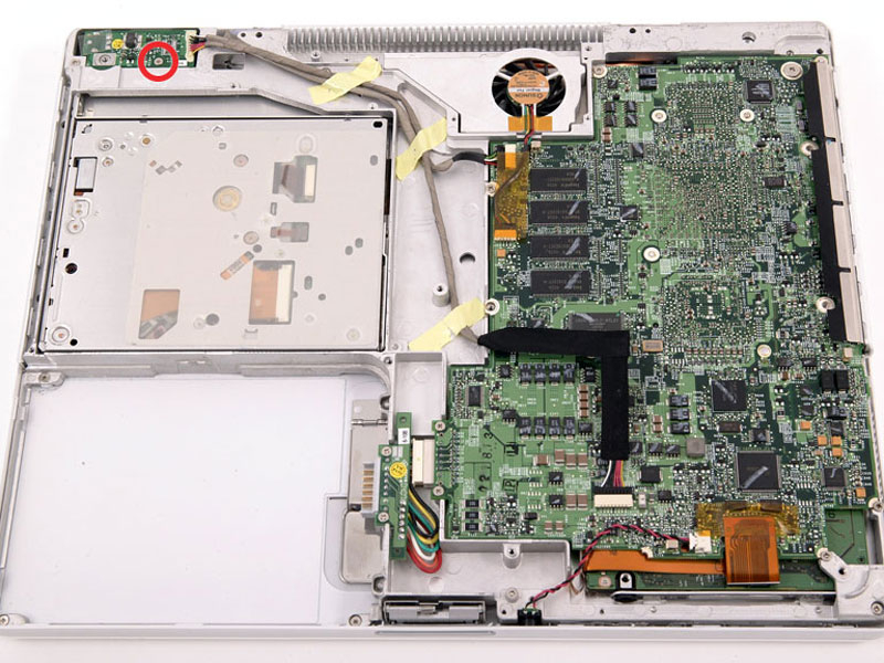

The front of the foil cover has a lip divided into four separate tabs. Use a blade to loosen each as they can be easily bent.
geekspeak - Reply
My dc board had 2 screws. for some reason when i tried to screw them both back in only one got tight. the other one just kept twirling so i left it out. i didnt want to have a loose screw rattling around in my computer.
also had trouble laying down the wire to the dc board. it wouldnt lay flat but i was able to get it flat enough. overall it worked and the computer is now up and running!

This is the first screw of the many on this part of the tear down that really needs the Phillips #00 screwdriver.
turtlejp - Reply

My 1 GHz DC board had two Phillips, one on the far left and one next to the Z10B label.
geekspeak - Reply

On this iBook, the DC board had a small Phillips screw on it.
adamprall - Reply
Woops - never mind - neglected the screw from previous step.
adamprall - Reply
