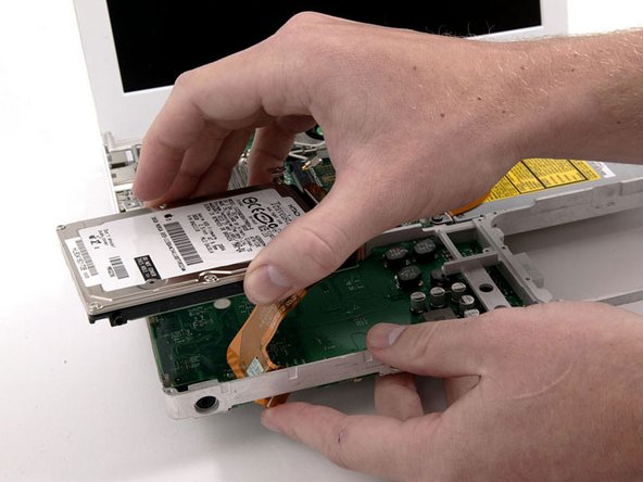

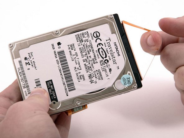

Introduction
You can install hard drives up to 9.5mm thick.

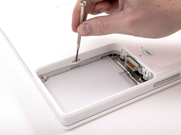

  • Use a coin to rotate the battery locking screw 90 degrees clockwise.

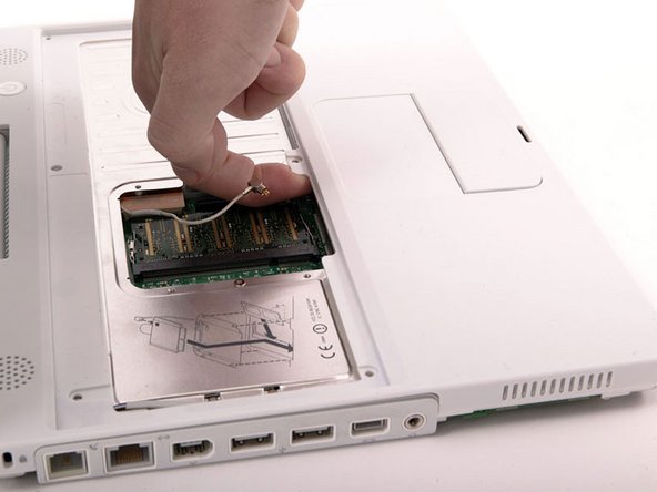

  • Hold the AirPort card in one hand and use your other hand to remove the antenna cable.
I had a hard time getting the Airport card seated properly when reconstructing. If the wire brace doesn't snap back in easily, then try reseating the card. Don't force it.
vorski - Reply

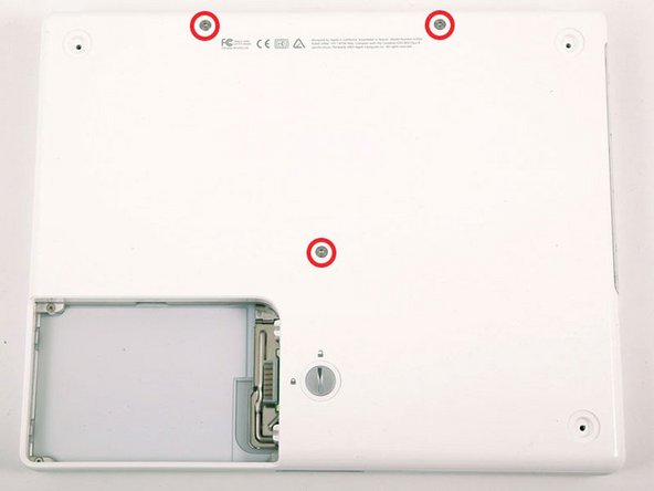

Image 1/1:

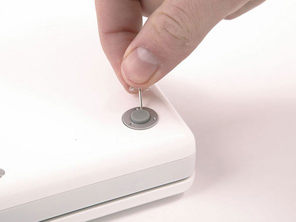

  • Use a pin (or anything you like) to remove the three rubber feet from the lower case.
Be careful that the feet don't shoot up and hit you in the eye when you pry them out!
UniAce - Reply
Each rubber foot has three large tabs occupying 3, 7, and 11 o'clock positions, while a small tab at 9 o'clock position. When you place those rubber feet back to the ring housings, make sure their small tabs aligning with the opening gaps around the rings.
Nienpo - Reply
Taking the feet off - I found a thin flathead screwdriver was much better than a pin to lever them off. Also doesn't mark the rubber. Not hard though
tangawk - Reply

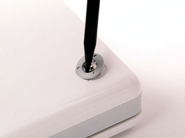

Image 1/1:
  • Remove the three newly-revealed Phillips screws.
Image 1/1:
  • Use a spudger or small flathead screwdriver to pry up the three metal rings that housed the rubber bumpers.
Align the ring so that it sits flush before trying to put the screws back in. A small tab in the case needs to align with the ring correctly.
jaeckerb - Reply
Yes, the rings have to be put back and flushed with the lower case surface. Otherwise, the rubber feet will not stand evenly.
Nienpo - Reply

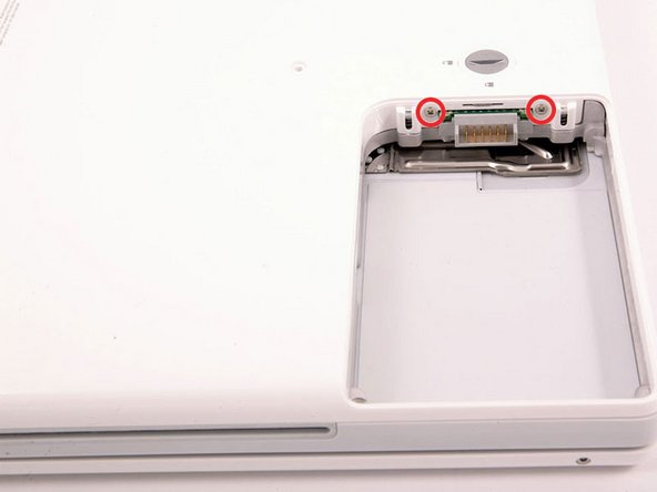

  • Remove the two Phillips screws on either side of the battery contacts.
If I am not mistaken, these two screws have slightly heavier heads than all the others, in case this is helpful info for when you reassemble.
akatodd - Reply

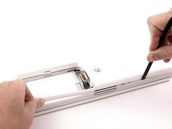

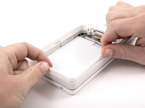

Image 1/1: Push the thin rims of the lower case surrounding the battery compartment in, bending them past the tabs, and then lift up to free that corner of the lower case.
  • Breathe deeply. Trying times are ahead, but we promise the lower case does come off.
  • Push the thin rims of the lower case surrounding the battery compartment in, bending them past the tabs, and then lift up to free that corner of the lower case.
I need patience and I need it NOW!!!!
chrisbulle - Reply
They aren't joking about these being trying times. Steps 15-20 are tough, especially if you don't have a spudger. A small flathead screwdriver works, but will scratch/nick your case.
vorski - Reply
I killed my spudger on this step, trying to twist it in the seam to lift the cover up. I got better progress using it to pry out the gey band, surrounding the laptop. That action will release the catch grooves. Still a test of patience...good luck.
karenskirka - Reply

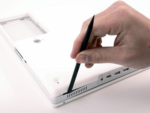

Image 1/1:
  • There is a slot on the wall of the battery compartment that locks the lower case in place. Use a small flathead screwdriver to pry out the slot's lower rim and pull up on the lower case to free the slot from the tabs holding it.
Image 1/1:
  • Run a spudger along the seam between the lower case and upper case on the front of the computer to free the tabs locking the lower case. Pull up on the lower case and continue to use the spudger as necessary until you hear three distinct clicks.
Image 1/1:
  • Continue to run the spudger around the front, right corner. There are two tabs on the port side of the computer, one near the front corner and one near the sound-out port.
I used a flathead screwdriver and an old credit card instead of a spudger. If using the screwdriver, be advised it may damage the case.
tildeksnyder - Reply
Wish I'd read the tip about the credit card! Made a few dents during this procedure as I didn't have a spudger. N.B. Plastic modeling tools are not suitable for this job!
enginemonkey - Reply
"Continue to run the spudger around the front, right corner." This is nearly impossible for me. Instead, I use a small flathead screw driver to gently open up the tab at the corner.
Nienpo - Reply

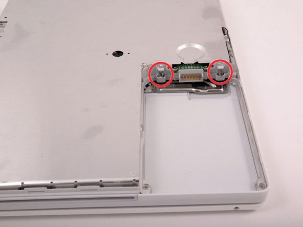

Image 1/1:
  • Remove the small greasy springs with white plastic caps from either side of the battery contacts.

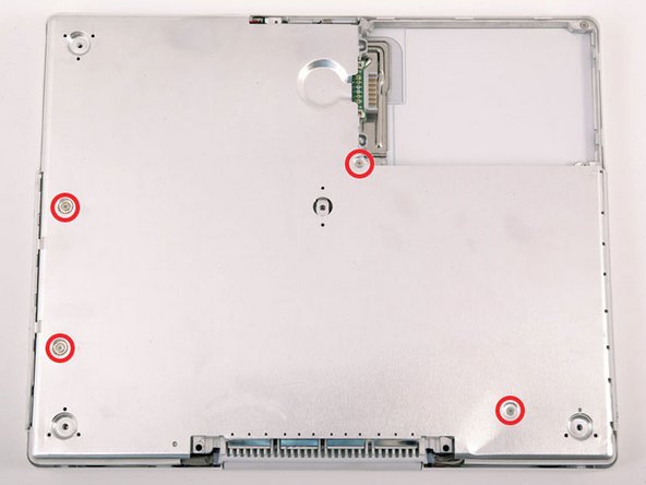

  • Remove the 4 Phillips screws from the bottom shield.
  • The two longer screws are along the computer's edge, near the ports.
I leave the bottom shield. It was not necessary for me to get it of to dismount the upper top.
Everling - Reply
on mine, there are six small extra screws to remove.
dianadipilla - Reply

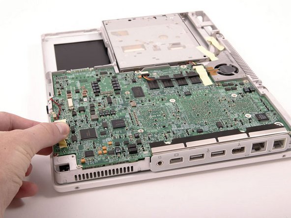

Image 1/1:
  • Disconnect the DC-In cable from the logic board.
I found that I could leave the cable attached if I was just careful with where I placed it when I turned the computer over.
horntaxnow - Reply

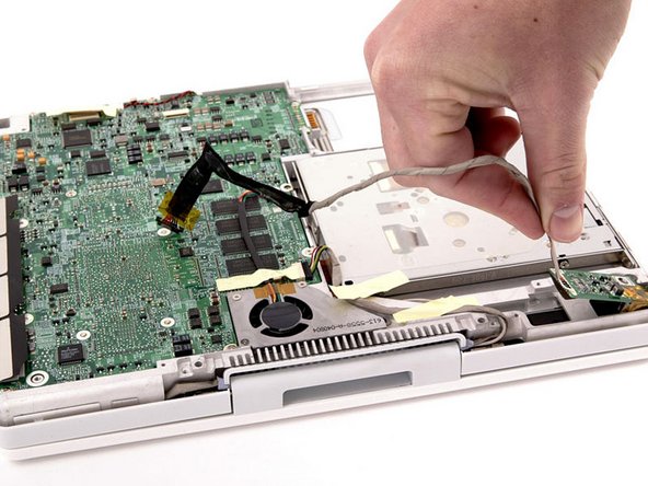

Image 1/1:
  • Deroute the cable from around the optical drive, removing tape as necessary, and angle the DC-In board out of its compartment.

Image 1/1: Turn over the computer and open it.
  • We recommend placing the computer on a slab of grey anti-static packing foam from this point on to prevent damaging the logic board.
  • Turn over the computer and open it.
  • Pry up the magnet covering a Phillips screw near the middle of the computer.
Probably a good idea to follow the advice about protecting the logic board with foam. I used bubble wrap on this step, but it probably didn't provide enough padding. When I reassembled everything and booted up (successfully!) the screen had a strong bluish tint. Can't seem to get rid of it now. Oops.
Otherwise, many thanks to ifixit and all y'alls for the helpful comments.

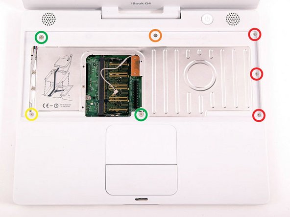

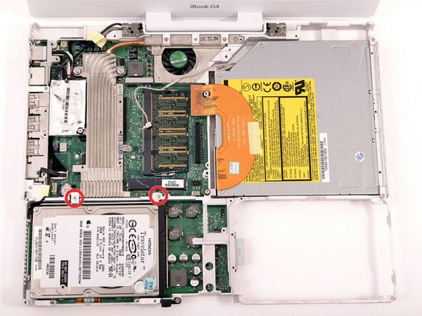

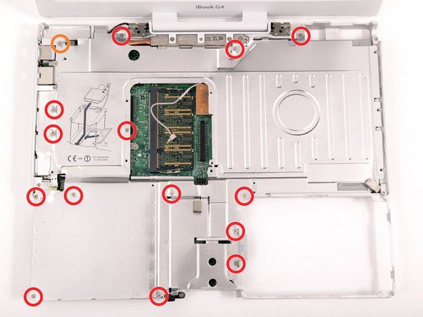

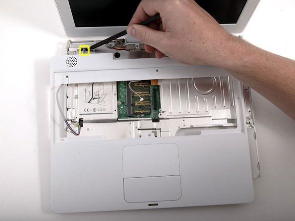

Image 1/1: Three 2 mm Phillips along the right edge.
  • Remove the following 7 screws from the edges of the keyboard area.
    • Three 2 mm Phillips along the right edge.
    • One 4.5 mm Phillips underneath where the magnet was.
    • One 6 mm Phillips with a small head in the lower left corner.
    • Two 6 mm Phillips with large heads, one in the upper left corner and one in the middle
My journey of replacing the hard drive stops at step 29. The screw marked with the yellow circle ("One 6 mm Phillips with a small head in the lower left corner") is very tight. The torque I applied wore out the screw head and it becomes the death sentence announcement of the iBook. Sad.
Nienpo - Reply
I am happy to announce that my iBook gets its 2nd life with the newly implanted hard drive. The screw marked with the yellow circle was worn out. I ordered a set of "Screw Extracting Pliers" (small) from iFixit in the hope of remedying the problem. Initially, the pliers do not have enough space to work on it because the screw sits in a narrow plastic basin. I file some of the surrounding plastic away to make room. Finally, the pliers "bites" the screw out. Yes!
The screw is put back when the iBook is assembled.
Nienpo - Reply

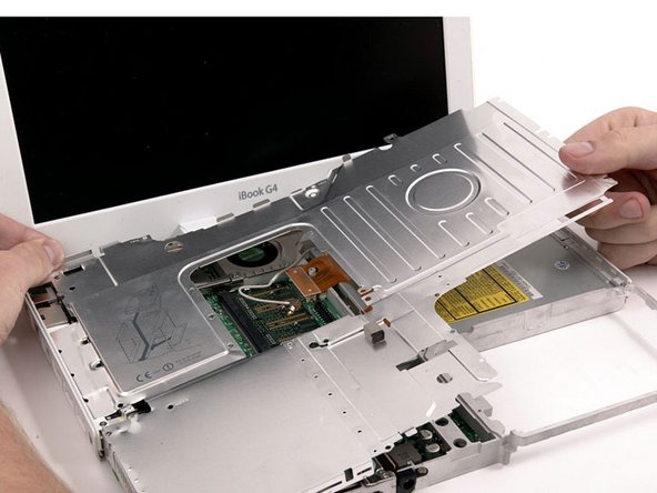

Image 1/1: Lift the upper case from the right side and use a spudger or your finger to disconnect the trackpad connector hidden beneath the white plastic tab. Due to model variatons your trackpad connector may be different from the one pictured.
  • Before you can yank the upper case off, you must disconnect the trackpad connector, the blue and white power cable, and speaker cable as described in the next steps.
  • Lift the upper case from the right side and use a spudger or your finger to disconnect the trackpad connector hidden beneath the white plastic tab. Due to model variatons your trackpad connector may be different from the one pictured.
When replacing the upper case, after you've installed your new hard drive, make sure you remember to RECONNECT the trackpad connector. I forgot to connect it when I put the computer back together, and had to take it apart a 2nd time in order to fix my mistake. Other than that I had no problems with this upgrade thanks to the detailed instructions offered here . Thanks iFixit.com!
You can see photos of my upgrade process here if you are interested: http://www.flickr.com/photos/judahs/sets...
judah - Reply

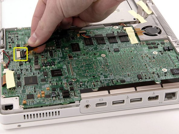

Image 1/1: Lift the upper case enough to disconnect the blue and white power cable from the logic board. Using your fingernails or a dental pick, carefully pry the connector from its socket. Make sure you're pulling only on the connector and not on the socket.
  • The connectors at the ends of the cables are attached very firmly to the sockets on the logic board. Pulling directly on the cable will either separate the cable from its connector or the socket from the logic board.
  • Lift the upper case enough to disconnect the blue and white power cable from the logic board. Using your fingernails or a dental pick, carefully pry the connector from its socket. Make sure you're pulling only on the connector and not on the socket.
just pulled up the socket accidentally. #&^&
chickenbrothel - Reply
Quote from chickenbrothel:
It helps to use two small tools here: A dental pick (or similar) to hold down the socket (keeps it from separating from the logic board) and a small flathead screwdriver. With your off hand, use the pick to make sure the socket stays put; with your good hand, use the screwdriver. DON'T pry; instead, TWIST the head of the screwdriver to gently coax the connector out of the socket.
textrix - Reply
Tweezers were also helpful here.
jackshim - Reply
I left the power button cable as it is VERY easy to break. I instead left it plugged in, and flipped the upper case and metal shield up against the screen. Worked well.
hwn - Reply
I've just done the same thing DRAT ! Is there any way to solder the tiny socket back on to the board ?
steweric - Reply
First I released the plastic top. Then I removed the touch pad connector. With that, I was able to shift the top case down a inch so the power connector was exposed. I pressed a small screw driver along the middle on the long side of the power connector and twisted back and forth so it would wedge the connector from the socket. I left the speaker(long wires) wires connected and just flipped the case off to the left.
jyee - Reply
You don't have to remove the power button connector to remove most parts! It's really dodgy and can break your logic board. When you peel up the glue on the wire for the microphone connector, lean the upper case on the display.
QEII Student IT - Reply
Wished I had read the comment BEFORE trying to pull that stupid connector out. Here is my take away: If you have an iBook 1.33 - DON'T TRY TO REMOVE THE CONNECTOR! It's impossible not to break the socket off the logic board. The connector is so firmly in the socket that you can't pull it out.
If you broke it, there is the possibility to solder it, but it's very tricky. But maybe the only chance of saving your machine. Do some google search, there are people who've done it.
uliverse - Reply

I used forceps. Quick and easy.
Desert Fox - Reply
I also pulled the power connector from the board and had to send the board to a repair shop to have the connector soldered back on. Working on tiny surface mount components is not for the faint of heart. Sierra Circuit Repair of Chico CA did a good job but it cost me $100.
gdavids57 - Reply
Quote from QEII Student IT:
Thank you very much!! Great tip, worked great,it cuts down the risk of logic board repair. I agree with the suggestion of tweezers, long thin tips help to maneuver in tight areas and are great for removing the tape holding the wires to the plastic upper case.
Oz Leap - Reply
I cloned the original drive onto a larger one, and started following these instructions.
Alas, I just "bricked" my machine as well at this step... the jack broke off the board.
Well, it served admirably for the last few years....
Painful but not critical lesson...
dannyb - Reply

Image 1/1: Tip: the multi-coloured cable may be easier and less daunting to disconnect after removing the top heat shield. Prop the top case upright while removing the shield - the connector is then much more accessible.
  • Lift the upper case off completely and disconnect the multicolored speaker cable from the logic board. As before, make sure you're pulling only on the connector and not on the socket.
  • Tip: the multi-coloured cable may be easier and less daunting to disconnect after removing the top heat shield. Prop the top case upright while removing the shield - the connector is then much more accessible.
Image 1/1: Fourteen 3 mm Phillips.
  • Remove the following 15 screws:
    • Fourteen 3 mm Phillips.
    • One 5.5 mm Phillips in the upper left corner.
    • Mind the magnet position in the lower right corner
This is very confusing. Next time I'm going to mark the spots where the little screws go with red sharpie.
chrisbulle - Reply
On my machine, the 5.5 mm Phillips in the upper left corner had a larger-diameter head than the other screws, in case this is helpful info for when you reassemble.
akatodd - Reply
screws to my left in front of pc
eric robertson - Reply
Image 1/1:
  • Lift the top shield up from the right side, minding the upper left corner, which may catch on the metal framework.

  • Turn the computer over and disconnect the orange hard drive cable, removing tape as necessary.
Don't forget to reconnect this connector. Otherwise you'll get the question marked folder blinking on your screen.
jyee - Reply

  • Lift the hard drive up, carefully guiding the cable through the slot in the lower case.

Image 1/1: This is a bit tricky. Try rocking the cable gently from side to side while applying even pressure. If you bend the pins, do your best to straighten them, using the hard drive cable as a guide.
  • Use the transparent orange loop to disconnect the large orange ribbon cable from the hard drive.
  • This is a bit tricky. Try rocking the cable gently from side to side while applying even pressure. If you bend the pins, do your best to straighten them, using the hard drive cable as a guide.
  • If you are installing a new hard drive, we have an OS X install guide to get you up and running.
