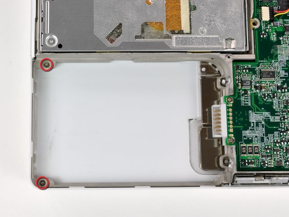

Remove the two 3 mm Phillips screws inside the left edge of the battery tray.

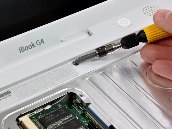

Use the flat side of a flathead screwdriver to remove the small magnet covering a screw near the middle of the computer.

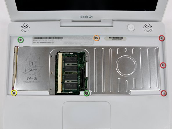

Remove the following 7 screws from the edges of the keyboard area.
Three 2 mm Phillips along the right edge.
One 4.5 mm Phillips underneath where the magnet was.
One 6 mm Phillips with a small head in the lower left corner.
Two 6 mm Phillips with large heads, one in the upper left corner and one in the middle.

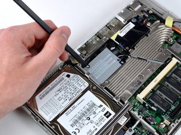

Lift the small plastic retaining bracket up and out of the computer.

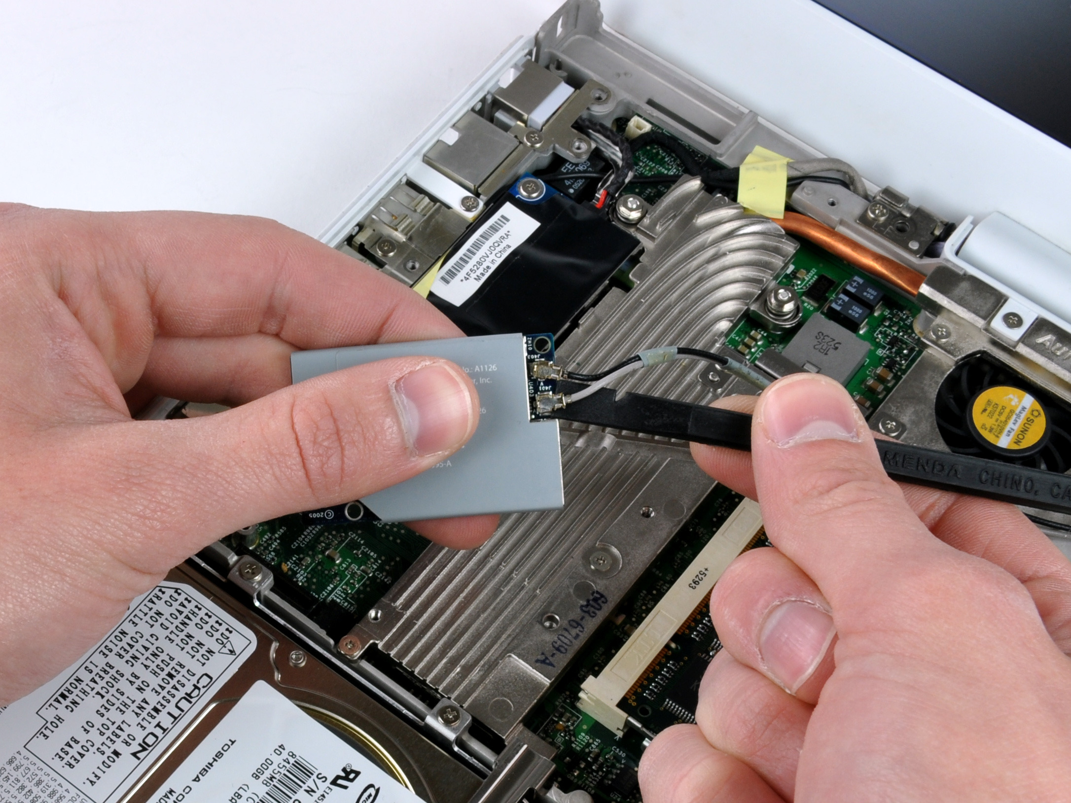

Using a spudger, pry up the AirPort/Bluetooth board from the end closest to the hard drive. Be sure to pry against the metal framework, as shown in the picture.

the airport/bluetooth cards connective socket is veeery delicate. i encountered one, when opening the book, which had been unintentionally dislocated by the previous owner. and no human is able to resolder what has been soldered by a machine robot. i have to use one or two usb sticks instead from now on, what a pity.
