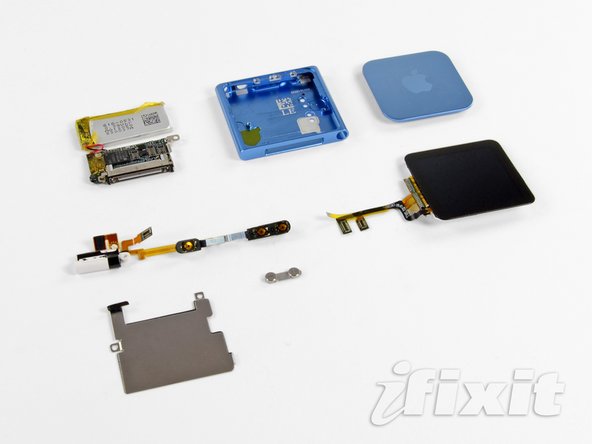

Step 12  ¶
Image 1/3: With the assembly away from the case, the volume buttons are free for removal.
Step 12  ¶
  • We begin prying the headphone jack ribbon cable assembly from the inner case. Unfortunately, what seems to be an entire bottle of glue slows our process.
  • With the assembly away from the case, the volume buttons are free for removal.
  • The glue is gone, and the last of our plastic opening tool duties are done.
Step 13  ¶
Image 1/2: All three button sensors (sleep, volume up, and volume down) are all connected to the headphone jack ribbon cable. This will make it tough to replace individual components.
Step 13  ¶
  • The ribbon cable is finally freed and we take some time to observe it.
  • All three button sensors (sleep, volume up, and volume down) are all connected to the headphone jack ribbon cable. This will make it tough to replace individual components.
