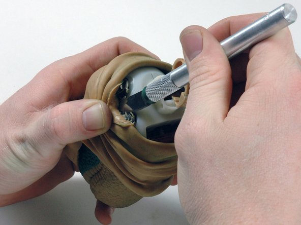

Step 4  ¶

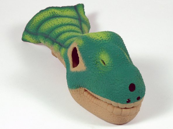

Removing the skin from the head. Ugobe used glue around each orifice to keep the skin secure, so this is trickiest part.

  • Removing the skin from the head. Ugobe used glue around each orifice to keep the skin secure, so this is trickiest part.
  • Pleo may be the most interactive toy ever made. He has:
  • One color camera
  • Two microphones
  • One IR transmitter
  • One accelerometer
  • Eight capacitance touch sensors
Step 5  ¶
Removing glue around his eye.

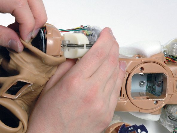

Removing the skin from his legs and torso. The skin is elastic enough that the entire body section can be removed as one piece.
Step 7  ¶
  • Removing the skin from his legs and torso. The skin is elastic enough that the entire body section can be removed as one piece.

  • Pleo's skin is loose over most of his body, but there are stiff plastic frames surrounding the ports and battery bay on his belly.

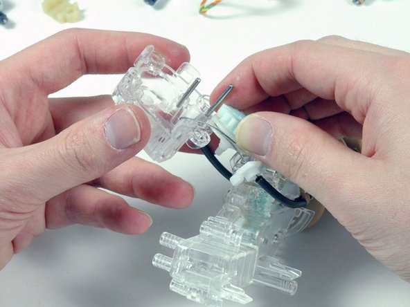

The rear torso houses the ingenious tail mechanism and rear leg drives.
Step 14  ¶
  • The rear torso houses the ingenious tail mechanism and rear leg drives.
  • To walk, Pleo has two motors driving each leg. One motor is in the torso, and the other is in the leg beneath the silver foil. Pleo uses eight motors and 36 gears just to walk around!

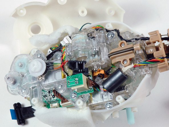

Step 19  ¶

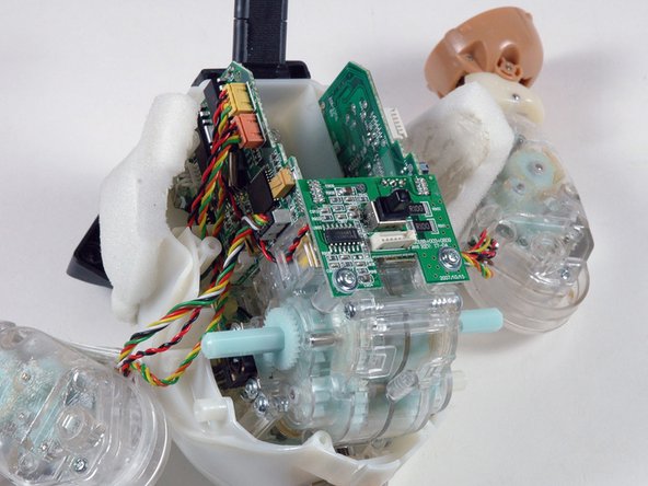

Pleo's central nerve center. There are circuit boards on three sides of the battery compartment.
Step 19  ¶
  • Pleo's central nerve center. There are circuit boards on three sides of the battery compartment.
  • The three boards visible here are soldered together, making removing these PCBs a challenge.

Looking down at the mechanism to move Pleo's neck. The neck works the same way as the tail, but has only six vertebrae.
Step 20  ¶
  • Looking down at the mechanism to move Pleo's neck. The neck works the same way as the tail, but has only six vertebrae.

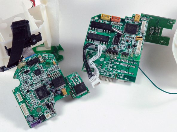

There are several major circuit boards that process Pleo's sensors and respond with motor control and speech. There are actually five boards in this image. Three of them are soldered together in his front torso.
Step 21  ¶
  • There are several major circuit boards that process Pleo's sensors and respond with motor control and speech. There are actually five boards in this image. Three of them are soldered together in his front torso.
  • There are several Fairchild Semiconductor FAN8100N motor controllers scattered throughout the robot.
  • Here, as well as on the I/O board in the torso, are 48-pin Toshiba TMP86FH47AUG 8-bit microcontrollers with the markings 06502AI41 F1015M04.

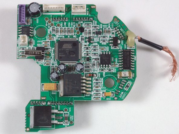

Step 22  ¶
What appears to be the main processor is an Atmel AT91SAM7S256 32-bit ARM microprocessor with 256 KB embedded flash.
Step 22  ¶
  • What appears to be the main processor is an Atmel AT91SAM7S256 32-bit ARM microprocessor with 256 KB embedded flash.
  • There is also a National Semiconductor LM2937 500mA positive voltage regulator.

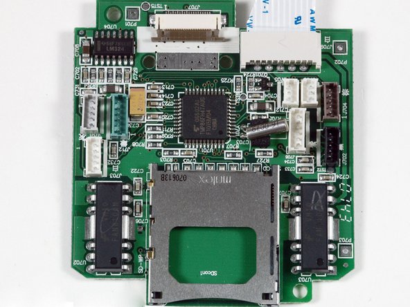

This is the I/O board in the belly with the USB port, SD memory slot and a 48-pin Toshiba TMP86FH47AUG 8-bit microcontroller.
Step 23  ¶
  • This is the I/O board in the belly with the USB port, SD memory slot and a 48-pin Toshiba TMP86FH47AUG 8-bit microcontroller.
  • If anyone has any more information about the components inside Pleo, let us know and we'd be happy to post more information here.

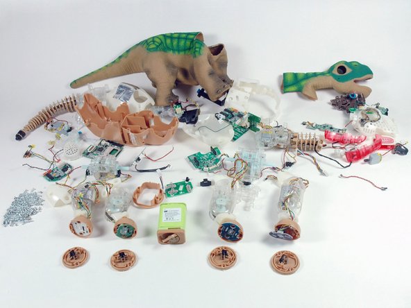

Step 24  ¶
This is Pleo. Like every life form, he is tremendously complex. We left most of the gearboxes intact, and we still have dozens of components.
Step 24  ¶
  • This is Pleo. Like every life form, he is tremendously complex. We left most of the gearboxes intact, and we still have dozens of components.
  • While we didn't break anything, we're not so sure we can put humpty-pleo back together again. We were pretty attached to him, so we may have to get another one.
