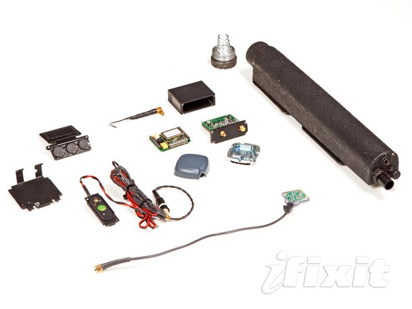

  • Tracking device Repairability Score: -10 out of 10 (10 is easiest to repair)
    • The FBI will find you if you find their tracking device.
    • You cannot choose to be not tracked by the FBI.
    • You can legally be tracked by one of these units.
    • We'll be right back, the FBI is knocking on our door.
