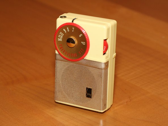

Here's a Sony TR-63 transistor radio - I forgot I had one until reminded of it by the ifixit Sony teardown promotion. If we're going to tear down Sony consumer gadgets, why not start with one of the earliest?
The TR-63 was introduced in 1957 - it was the first "pocket-sized" transistor radio ever made and the first Sony-branded product exported to North America, by the then-named Tokyo Tsushin Kogyo company (Tokyo Telecommuncations Engineering Corporation). It became a huge commercial success, over 100,000 units were sold.
It seems "pocket-sized" was a bit of a marketing gimmick at the time - although smaller than any competing product, the TR-63 was a bit too big to fit into a standard shirt pocket. So story has it that company salesmen wore custom-made shirts with slightly bigger pockets to show off the TR-63's small size. But unlike desktop radios of the day which were promoted under the idea of "a radio in every home", the TR-63 was uniquely marketed as something each person could own and carry with them. A foreshadowing of the Walkman and iPod, perhaps?
The TR-63 contains a whopping 6 transistors. By comparison, the Cell processor chip in the PS3 contains two to three hundred million transistors. That's an indication of the progress made in the electronics industry in the past 50 years.
In Japan the TR-63 sold for 13,800 yen, and the original export price was U$39.95. It was available in 4 colours (yellow, red, green and black).
Follow along with this teardown to get a look into an important piece of consumer electronics history.

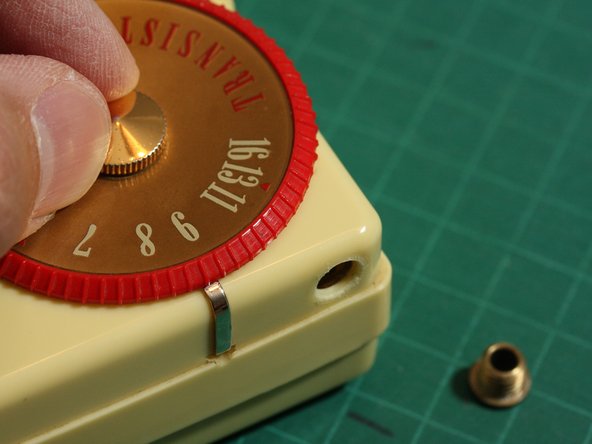

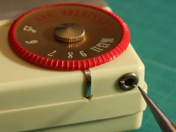

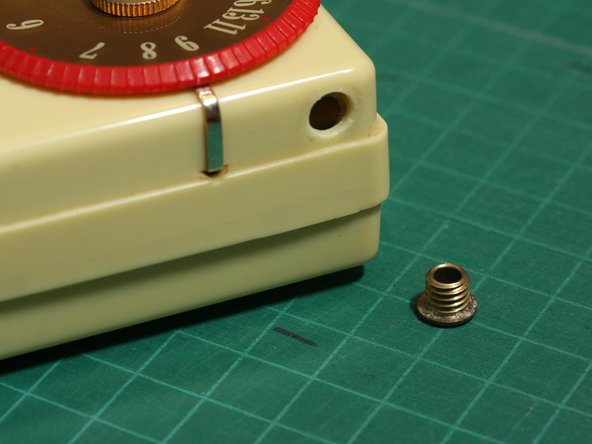

OK, enough babbling, let's get to work! This is the real Step 1... On the top of the radio you'll notice the earphone jack.
Step 2  ¶
  • OK, enough babbling, let's get to work! This is the real Step 1...
  • On the top of the radio you'll notice the earphone jack.
  • Unscrew and remove the metal jack collar using a flathead screwdriver or other flat tool.

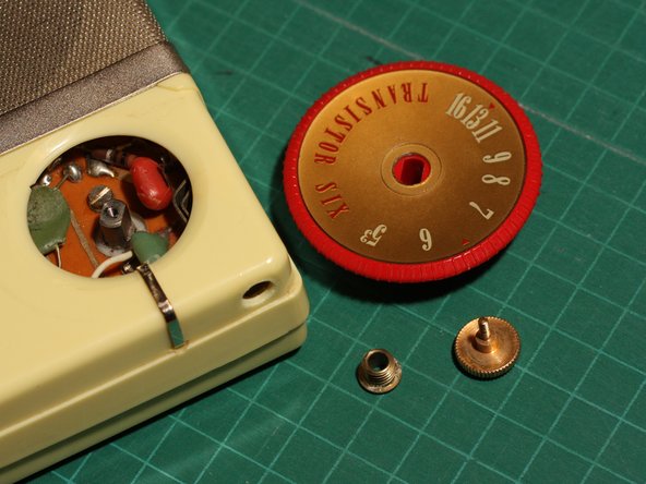

Step 3  ¶
Unscrew the large decorative screw in the center of the tuning dial by hand... ...and then you can remove the screw and lift off the tuning dial.
Step 3  ¶
  • Unscrew the large decorative screw in the center of the tuning dial by hand...
  • ...and then you can remove the screw and lift off the tuning dial.

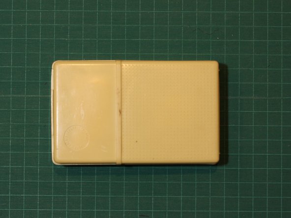

Turn the radio over with its back facing you.
Step 4  ¶
  • Turn the radio over with its back facing you.
  • It's safe to say the warranty on this radio long ago expired -- so we're going to fearlessly open it up in the following steps...
  • In these photos, the gridlines on the green background are 1 cm square, so you can get an idea of the size of the radio.

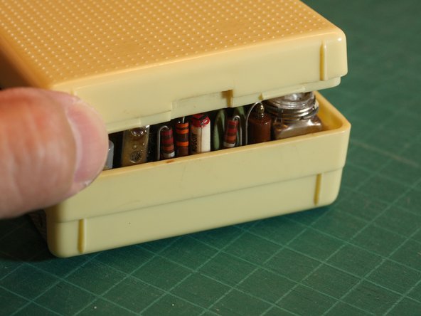

Step 5  ¶
Carefully pry open the case from the bottom edge. Boy, this is a lot easier to open than an iPod! (Spudger not required.)
Step 5  ¶
  • Carefully pry open the case from the bottom edge.
  • Boy, this is a lot easier to open than an iPod! (Spudger not required.)
  • On the inside of the back cover, you'll find the product label. Notice the official company name, Tokyo Tsushin Kyogo Ltd. I've seen photos of later versions of the TR-63 which say "Sony Corporation" there instead.
  • I'm not sure what happened to the corner of the label - perhaps after all these years in the back of my closet it was likely eaten by a grue?

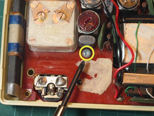

Step 7  ¶
Using a Phillips #1 screwdriver, remove the lone screw in the center holding the circuit board in place
Step 7  ¶
  • Using a Phillips #1 screwdriver, remove the lone screw in the center holding the circuit board in place
  • Fortunately the Torx screw wasn't yet invented when they built this radio...

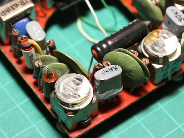

Here's the component side of the circuit board. You can see the various components in these views of the circuit board. Remember, these are all discrete components here -- no integrated circuits! But state of the art at the time, a lot of circuitry crammed into a small space. Six of the gray components with an oval cross-section (marked or stamped with "Sony") are transistors.
Step 14  ¶
  • Here's the component side of the circuit board.
  • You can see the various components in these views of the circuit board. Remember, these are all discrete components here -- no integrated circuits! But state of the art at the time, a lot of circuitry crammed into a small space.
  • Six of the gray components with an oval cross-section (marked or stamped with "Sony") are transistors.
  • The 7th similar looking gray component is a varistor. It's the one at the front left of the circuit board in the 3rd photo in this series.
  • Say, do they still teach the resistor colour code in schools these days? :)

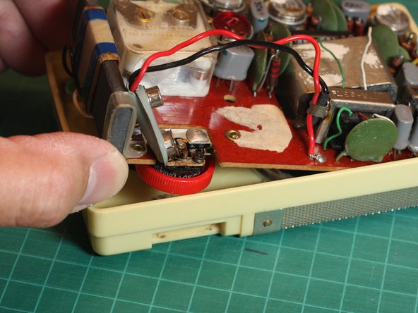

Here's a closeup of the volume dial / on-off switch
Step 15  ¶
  • Here's a closeup of the volume dial / on-off switch
  • An eccentric cam in the middle of the dial opens and closes a metal contact (marked with green square) to disconnect/connect the power to the circuits.

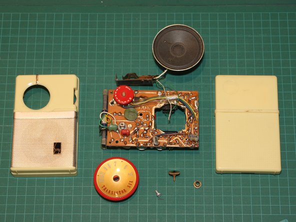

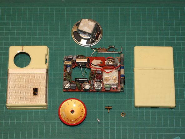

Finally, here are all the pieces of the fully disassembled TR-63 transistor radio, with both front and back views of the circuit board. That's it!
Step 17  ¶
  • Finally, here are all the pieces of the fully disassembled TR-63 transistor radio, with both front and back views of the circuit board.
  • That's it!
