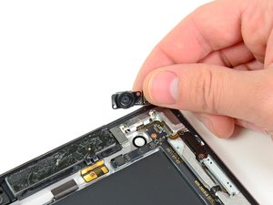

Remove the following two screws:
One 3.3 mm Phillips screw
One 2.1 mm Phillips screw
Lift the metal retainer clip straight up from its recess in the rear panel.
If the camera comes up with the retaining clip, don't worry. Just separate the camera from the clip before reinstalling, so you can be sure to get the connector in the right place.
Be sure the small thermal pad is attached to the metal retaining clip as seen in the third picture when replacing the rear camera.
