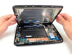

After freeing the retaining clips, lift the front panel assembly away from the rear case.
Do not try to remove the front panel assembly from the TouchPad just yet, as it is still connected to the motherboard.
