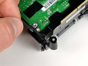

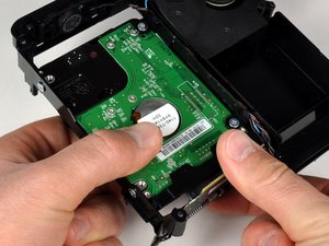

-[* black] Use the flat, blade-like end of the spudger to pry the sensor from the hard drive.
-[* icon_caution] Be careful when prying at the sensor board, as it can be quite fragile. Work a spudger evenly around the sensor board to pry it free from the adhesive.
-[* black] Using the pointed end of the spudger, work the end underneath the black tape to free the sensor from the drive.
+[* red] Hold the new drive in place and attach it to the frame using the four Phillips screws.
+[* black] Plug the interconnect board into the new drive, making sure that all wires are in their original place.
+[* black] Route the black thermal sensor wire back through the notch.
