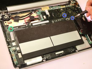

-[* black] 4. Lift the battery cable out of Mother Board
+[* black] 1. Unscrew The 2 Battery Screws (Blue Circle at the top-right corner) by using a screwdriver with a J00 tip.
+[* black] 2. Unscrew The 1 Battery Screw (Green Circle at the top-left corner) by using a screwdriver with a J00 tip.e
