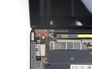

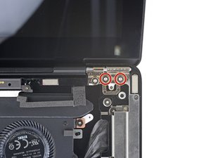

[title] Remove four hinge screws
-[* icon_caution] When removing the hinge screws, make sure to hold the screen steady as it will become more and more loose as the hinge screws are gradually removed.
-[* red] While holding the screen steady, use a T6 Torx driver to remove the four outermost 5.9 mm screws securing the screen, two on each side.
-[* orange] ***Leave the two innermost hinge screws in place for now,*** one on each side.
+[* icon_caution] When removing the hinge screws, make sure to hold the screen steady as it will become as the screws are removed.
+[* red] While holding the screen steady, use a T6 Torx driver to remove the four outermost 5.9 mm screws securing the screen (two on each side).
+[* icon_note] Both hinges should have one remaining screw. Leave this screw in place.
