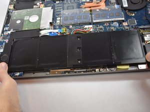

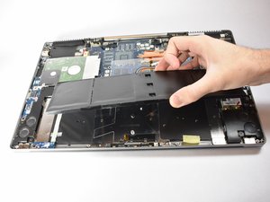

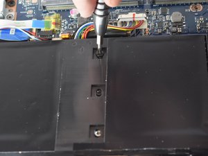

-[* violet] Remove the 3 #01 Phillips 4mm screws[in the battery]
+[* violet] Remove the 3 #01 Phillips 4mm screws
[* blue] Push the clips away from the battery
[* black] Remove the battery from the motherboard
