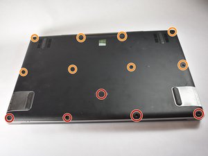

- | [* black] Remove the top and middle grips that conceal 3 additional screws. |
- | [* red] Remove the 5 6mm T9 screws. |
- | [* orange] Remove the 8 10mm T9 screws. |
+ | [* black] Remove the top and middle rubber feet under the laptop to reveal hidden screws. |
