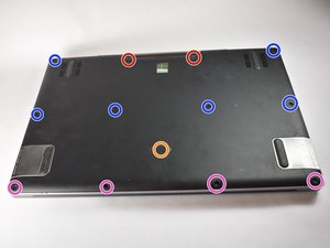

- | [* violet] Remove the 4 6mm T9 screws |
- | [* blue] Remove the 6 10mm T9 screws |

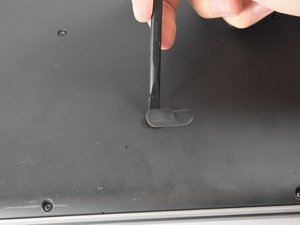

- | [* light_blue] Remove the grips concealing the three additional screws |
- | [* red] Remove the remaining 2 10mm T9 screws |
- | [* orange] Remove the remaining 6mm T9 screw |
+ | [* black] Remove the top and middle grips. |
+ | [* red] Remove the 5 6mm T9 screws. |
+ | [* orange] Remove the 8 10mm T9 screws. |
