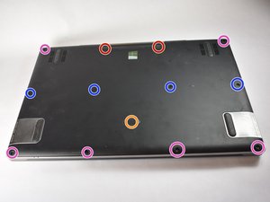

-[* violet] Remove the 4 6mm T9 screws[along the bottom of the laptop]
-[* blue] Remove the 6 10mm T9 screws[along the middle of the laptop]
-[* light_blue] Remove the grips
-[* black] Remove the remaining 2 10mm T9 screws[hidden underneath the long grip]
-[* black] Remove the remaining 6mm T9 screw[hidden underneath the short grip]
+[* violet] Remove the 4 6mm T9 screws
+[* blue] Remove the 6 10mm T9 screws
+[* light_blue] Remove the grips concealing the three additional screws
+[* red] Remove the remaining 2 10mm T9 screws
+[* orange] Remove the remaining 6mm T9 screw
