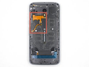

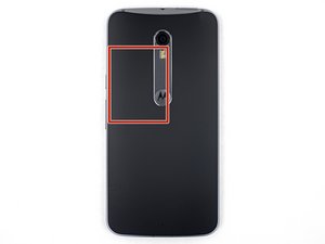

+ | [* black] In the following steps, you'll be cutting through the adhesive securing the back cover. |
+ | [* icon_note] The adhesive is laid out as seen in the first image, which shows the inside of the cover. |
+ | [* red] ***Avoid slicing in this area to avoid damaging delicate ribbon cables.*** |
