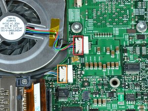

[* black] Disconnect both of the following connectors from the logic board:
- [* red] Left fan cable.
- [* orange] Inverter cable.
+ [* black] Left fan cable.
+ [* black] Inverter cable.
[* icon_caution] Be sure to pull only parallel to the face of the logic board, as pulling up on the socket will break it off the logic board.
[* icon_note] When pulling these connectors away from their sockets, it is helpful to use your fingernails to pull on the ears at each side of the connector.
