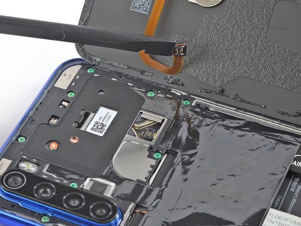

    • Do not remove the rear glass all the way yet, the fingerprint cable is still connected to the motherboard.
  7. Xiaomi Redmi Note 8T IPS LCD Screen & Digitizer Replacement: step 7, image 1 of 2 Xiaomi Redmi Note 8T IPS LCD Screen & Digitizer Replacement: step 7, image 2 of 2
    • Carefully fold the rear glass to the right side of the phone. Use the suction handle as a stand for the rear glass.
  8. Xiaomi Redmi Note 8T IPS LCD Screen & Digitizer Replacement: step 8, image 1 of 2 Xiaomi Redmi Note 8T IPS LCD Screen & Digitizer Replacement: step 8, image 2 of 2
    • Use a spudger to pry up and disconnect the fingerprint flex cable.
    • Remove the rear glass.
    • During reassembly, this is a good point to power on your phone and test all functions before sealing it up. Be sure to power your phone back down completely before you continue working.

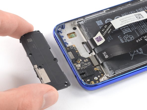

  12. Careful: step 12 is sourced from a guide that's marked as in-progress.
    Xiaomi Redmi Note 8T IPS LCD Screen & Digitizer Replacement, Xiaomi Redmi Note 8T Battery Disconnect: step 12, image 1 of 2 Xiaomi Redmi Note 8T IPS LCD Screen & Digitizer Replacement, Xiaomi Redmi Note 8T Battery Disconnect: step 12, image 2 of 2
    • Use a spudger to pry up and disconnect the battery flex cable.
  13. Xiaomi Redmi Note 8T IPS LCD Screen & Digitizer Replacement, IPS LCD Screen & Digitizer: step 13, image 1 of 2 Xiaomi Redmi Note 8T IPS LCD Screen & Digitizer Replacement, IPS LCD Screen & Digitizer: step 13, image 2 of 2
    • Use a spudger to pry up and disconnect the display flex cable.

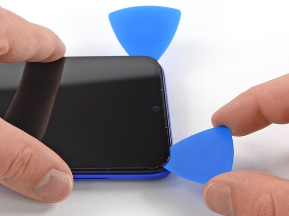

  20. Xiaomi Redmi Note 8T IPS LCD Screen & Digitizer Replacement: step 20, image 1 of 2 Xiaomi Redmi Note 8T IPS LCD Screen & Digitizer Replacement: step 20, image 2 of 2
    • Insert a second opening pick and slide it to the bottom left corner of the screen to cut the adhesive.
    • Leave the picks in their place to prevent the adhesive from resealing.

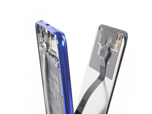

    • Try not to remove the display all the way yet, the display cable is still threaded through the frame and possible adhered on the inner side of the midframe.
  24. Xiaomi Redmi Note 8T IPS LCD Screen & Digitizer Replacement: step 24, image 1 of 3 Xiaomi Redmi Note 8T IPS LCD Screen & Digitizer Replacement: step 24, image 2 of 3 Xiaomi Redmi Note 8T IPS LCD Screen & Digitizer Replacement: step 24, image 3 of 3
    • Thread the display flex cable through the gap in the midframe and remove the display.
If possible, turn on your device and test your repair before installing new adhesive and resealing.
