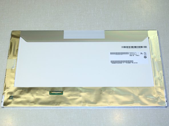

Image 1/1: The exact original model used by Lenovo is the [http://www.laptopscreen.com/English/screen-part-number/B156HW01~V.4/|AUO B156HW01 V.4]. This is a 15.6", matte, 1080p panel with wider than average viewing angles.
  • This voids your warranty!
  • The exact original model used by Lenovo is the AUO B156HW01 V.4. This is a 15.6", matte, 1080p panel with wider than average viewing angles.
  • This display has been measured by notebookcheck.net and anandtech.com and shown to be one of the best laptop displays shipping.
  • A contrast ratio over 500 is available and this display is able to show over 95% of the colors in the AdobeRGB spectrum. 1080p is a much higher resolution than the basic 1366x768 display, allowing for more work space.

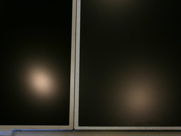

Image 1/1: The V.4 is slightly more reflective than the basic T520 display. The B156HW01 V.4 on the left makes a more focused reflection of the overhead light while the stock display (LG LP156WH4) creates a larger diffused reflection.
  • The V.4 display we will be using for this upgrade is the highest quality drop in replacement available and the exact same product that Lenovo uses. This version is a matte display with a "42% haze" AR coating.
  • The V.4 is slightly more reflective than the basic T520 display. The B156HW01 V.4 on the left makes a more focused reflection of the overhead light while the stock display (LG LP156WH4) creates a larger diffused reflection.

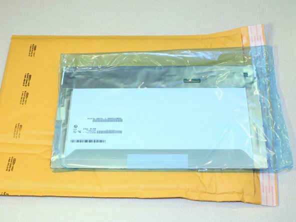

  • This is how my upgrade display arrived from laptopscreen.com
  • It was shipped from Burnaby, British Columbia on the other side of Canada and arrived in three days.

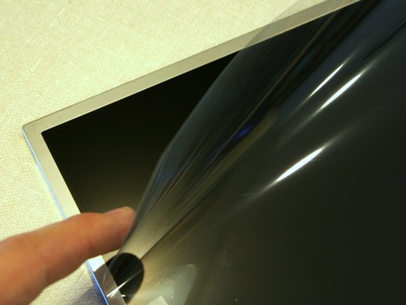

Image 1/3: A protective sheet is taped to the front of the display. Leave it on until we are almost done installing the display in the laptop. Image 2/3: A protective sheet is taped to the front of the display. Leave it on until we are almost done installing the display in the laptop. Image 3/3: A protective sheet is taped to the front of the display. Leave it on until we are almost done installing the display in the laptop.

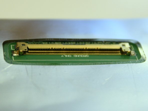

  • The display uses the same 40 pin connector as the T520 and many other laptops. It provides power for the LED backlighting and the 1080p video signal.
  • A protective sheet is taped to the front of the display. Leave it on until we are almost done installing the display in the laptop.

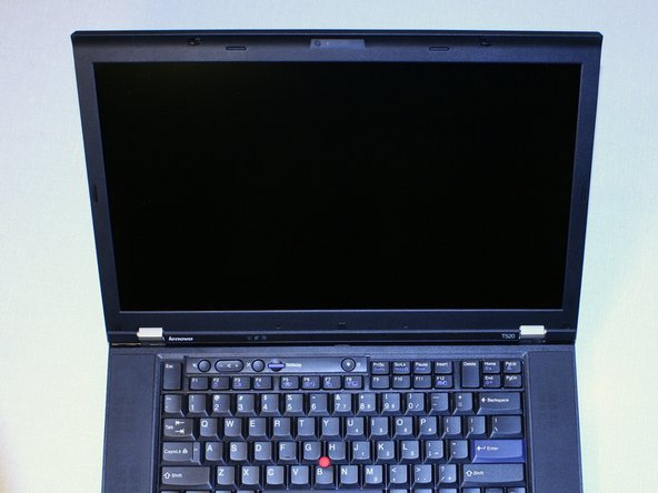

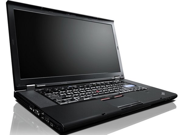

  • The victim. Any T520 will work with this upgrade. Even the most basic configurations can take advantage of a top of the line display. The Thinkpad T510, W510, T520, W520, T530 and W530 will all also work for this upgrade.

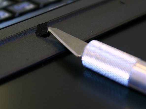

  • The first step is to remove the three covers along the bottom of the bezel and the screws underneath. The point of an exacto knife works well for this.
    • Three adhesive covers.
    • Three 6mm Phillips screws.

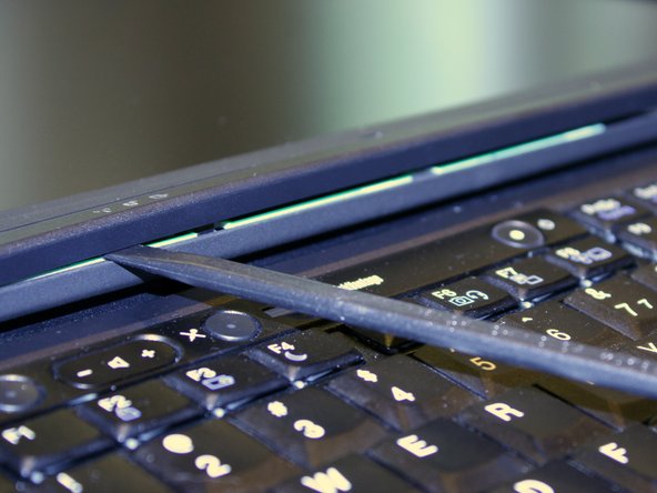

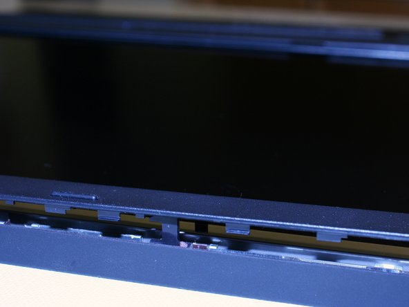

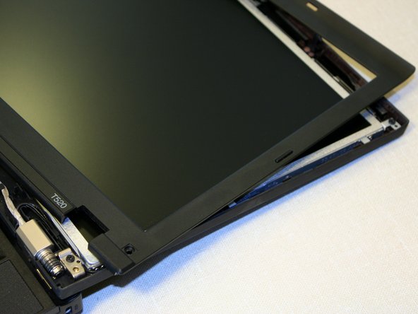

  • Starting from the bottom of the screen, release the plastic clips holding the bezel by pushing horizontally inward and prying upward with a spudger.

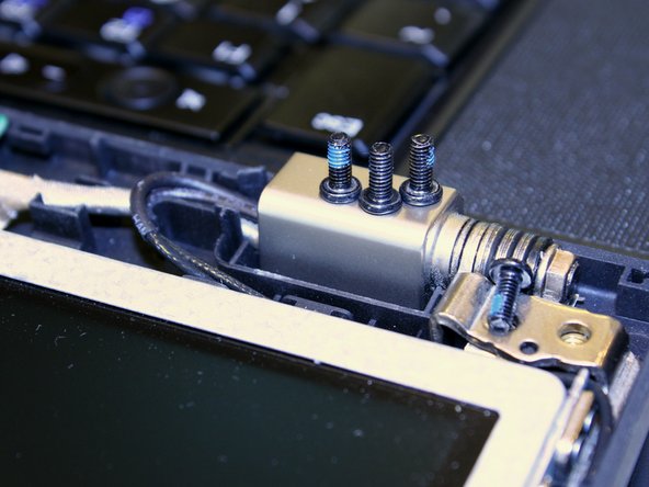

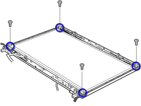

Image 1/3: Carefully rotate the hinges upward just enough to allow the removal of the four screws on the sides of the display frame. Image 2/3: Be careful of the cable for the magnetic lid close sensor. You may need to temporarily unstick the sensor from the frame or pull on the cable a bit to make it extend far enough. Image 3/3: Four 6mm Phillips screws.
  • The back of the display assembly is held to the metal frame with four screws that must be removed.
  • Carefully rotate the hinges upward just enough to allow the removal of the four screws on the sides of the display frame.
  • Be careful of the cable for the magnetic lid close sensor. You may need to temporarily unstick the sensor from the frame or pull on the cable a bit to make it extend far enough.
    • Four 6mm Phillips screws.
    • Four 3mm Phillips screws.

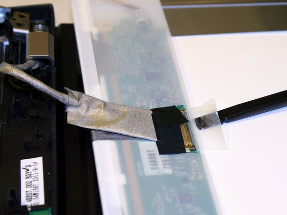

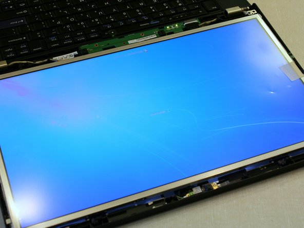

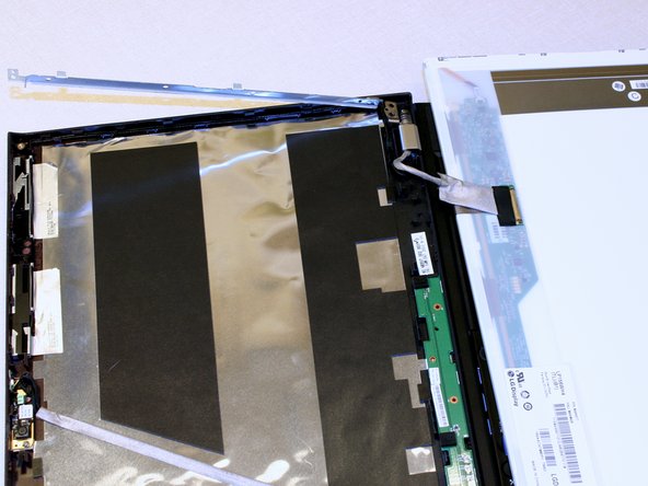

Image 1/3: Peel up the tape holding the connector but be careful not to damage the cable. Image 2/3: Remove the old display and put it somewhere safe. Someone else might find it useful for repairing a cracked display on a budget. You can use the upgrade screen's shipping package if you sell the display online. Image 3/3: Remove the old display and put it somewhere safe. Someone else might find it useful for repairing a cracked display on a budget. You can use the upgrade screen's shipping package if you sell the display online.

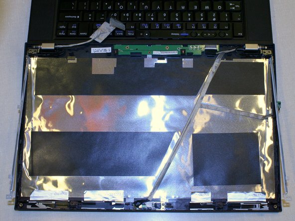

  • The old LCD is now held on only by the cable. Carefully rotate the display so that it rests on the laptop keyboard.

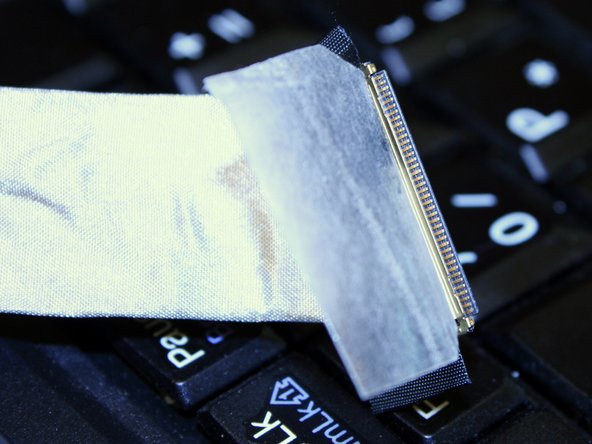

  • Peel up the tape holding the connector but be careful not to damage the cable.
  • Remove the old display and put it somewhere safe. Someone else might find it useful for repairing a cracked display on a budget. You can use the upgrade screen's shipping package if you sell the display online.

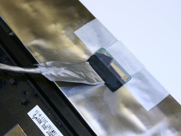

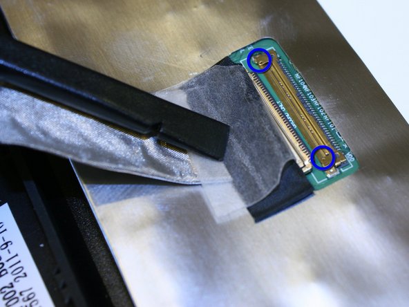

Image 1/3: Make sure both round clips are properly secured before taping the connector down. Feel free to add extra tape. Image 2/3: Tiny round clips. Image 3/3: Tiny round clips.
  • Lay the new 1080p LCD on the keyboard and insert the display connector. I found a spuger useful to push on the corners of the connector without damaging the cable.
  • Make sure both round clips are properly secured before taping the connector down. Feel free to add extra tape.
    • Tiny round clips.

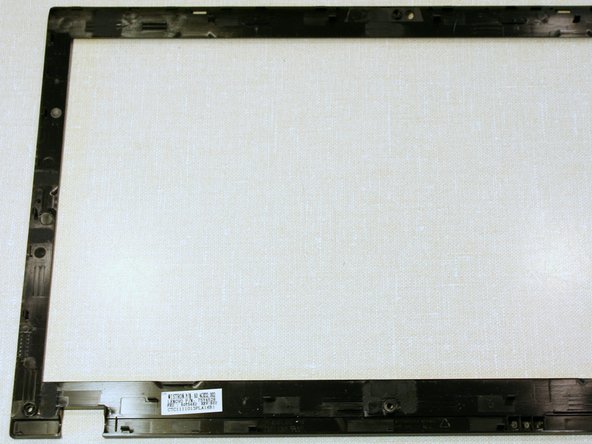

  • If everything looks ok then remove the battery and put the screws in. Remove the protective sheet from the display and put the bezel back on.

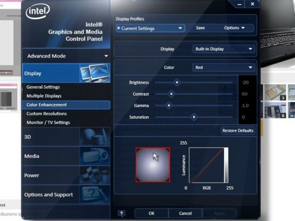

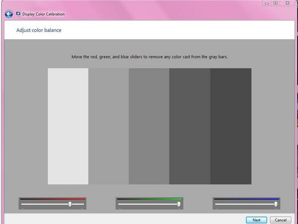

Image 1/2: Be prepared for a warmer default color temperature than is common on consumer displays. This screen is intended for professional graphics use so it is designed to match colors to how they would look when printed out and viewed under incandescent lighting. Image 2/2: Professionals working with graphics use a digital colorimeter to adjust the color accuracy of a display. This process creates what is called an ICC profile that tells programs how to display colors accurately.
  • This display is more capable than the average LCD so if it is adjusted wrong it can be very obvious.
  • Be prepared for a warmer default color temperature than is common on consumer displays. This screen is intended for professional graphics use so it is designed to match colors to how they would look when printed out and viewed under incandescent lighting.
  • Professionals working with graphics use a digital colorimeter to adjust the color accuracy of a display. This process creates what is called an ICC profile that tells programs how to display colors accurately.
  • To simply make the screen look good for viewing images and office use, Windows has a built in Display Color Calibration utility that allows adjustment of the color balance of the display. The Intel IGP software can also be used to make adjustments instead. Right click on the desktop and select Graphics Properties...
  • It is also easy to experiment with color profiles others have created for this display. Every panel will be slightly different but it is possible to find a profile that looks good on your screen. I found that the first ICC profile provided by Sager works for me.
