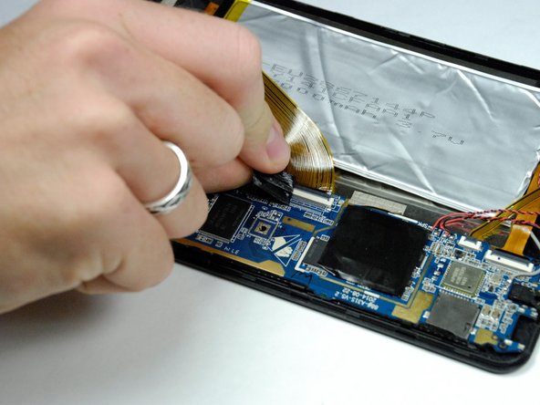

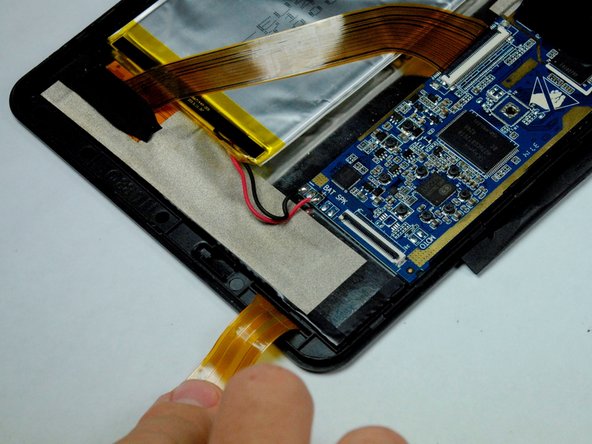

    • Remove the 4 pieces of tape covering the zero insertion force (ZIF) connectors on the motherboard.
  7. Trio Stealth G4 Motherboard Replacement: step 7, image 1 of 3 Trio Stealth G4 Motherboard Replacement: step 7, image 2 of 3 Trio Stealth G4 Motherboard Replacement: step 7, image 3 of 3

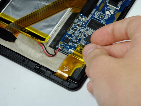

    • Use a spudger to flip up the black flaps on each of the 4 ZIF connectors.
    • Once the flaps are up, use your fingers to disconnect the end of the ribbon wires from the connectors.

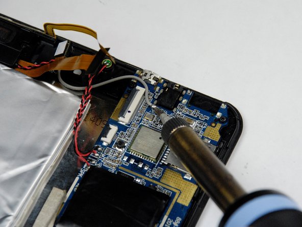

  8. Trio Stealth G4 Motherboard Replacement: step 8, image 1 of 2 Trio Stealth G4 Motherboard Replacement: step 8, image 2 of 2
    • Use the soldering iron to melt away the solder from each of the wires connecting to the motherboard.
    • Once the solder is completely removed, pull the wires away from the motherboard.

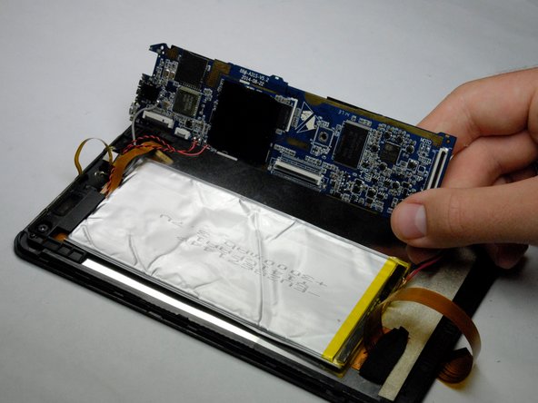

  11. Trio Stealth G4 Motherboard Replacement: step 11, image 1 of 2 Trio Stealth G4 Motherboard Replacement: step 11, image 2 of 2
    • Use a spudger to lift the motherboard from the device.
