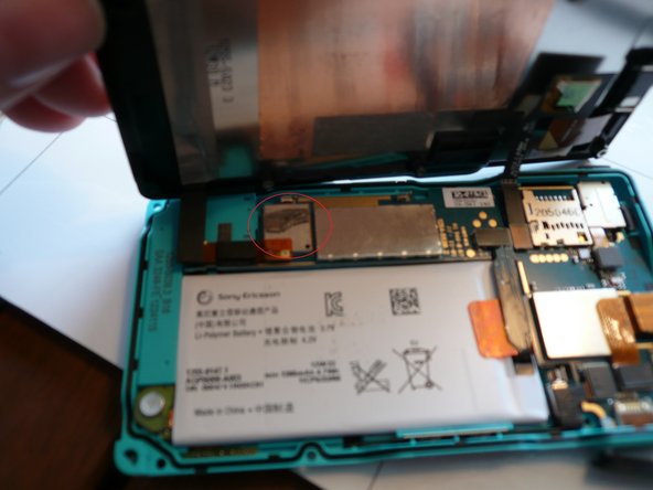

  3. Sony Xperia go Front Glass/Digitizer Replacement: step 3, image 1 of 3 Sony Xperia go Front Glass/Digitizer Replacement: step 3, image 2 of 3 Sony Xperia go Front Glass/Digitizer Replacement: step 3, image 3 of 3
    • Now the front can be seperated from the back.
    • CAUTION! there are some doublesided tape blocks situated on top of the connectors to the digitizer.
    • Use spudger to seperate these carefully from eachother.
    • Now you can open the phone sideways. Once opened, please disconnect the battery, marked on third Picture with a yellow circle.
    • Now you can disconnect digitizer cable and screen cable, marked with red circles on third picture.
    • Now you will be able to remove the front from the back of the phone.

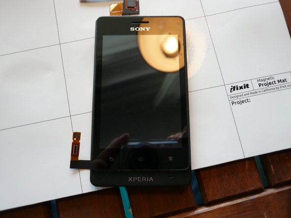

  4. Sony Xperia go Front Glass/Digitizer Replacement: step 4, image 1 of 2 Sony Xperia go Front Glass/Digitizer Replacement: step 4, image 2 of 2
    • Using a heat gun, heat around the edges and seperate the glass from the front cover. Work from bottom up.
    • Note the digitizer cable runs through a small hole behind the lcd, in the top of the phone.
    • When the glass is seperated, carefully lift the lcd a bit, to get the digitizer cable through the hole.
    • To protect the lcd from residue and fingerprints, cover it with masking tape, until you are ready to seal the glass to the cover.
    • When you have prepared new adhesive tape and the digitizer cable has been pulled through the hole to the backside of the phone.
    • Remove the masking tape from the lcd, and using some canned air, blow away dust and close the glass cover.
    • Finally reverse the disassembly and enjoy.
