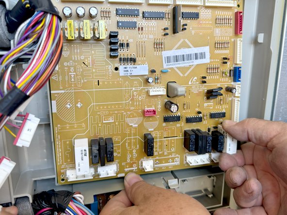

  4. Samsung Older French Door Refrigerator Main Control Board Replacement, Disconnect the control board: step 4, image 1 of 2 Samsung Older French Door Refrigerator Main Control Board Replacement, Disconnect the control board: step 4, image 2 of 2
    • When disconnecting the control board squeeze the locking tabs as shown.
    • Note the connector is shown disconnected for clarity.

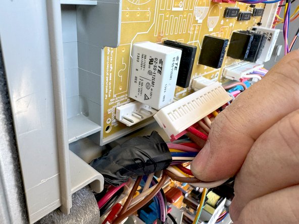

  5. Samsung Older French Door Refrigerator Main Control Board Replacement: step 5, image 1 of 3 Samsung Older French Door Refrigerator Main Control Board Replacement: step 5, image 2 of 3 Samsung Older French Door Refrigerator Main Control Board Replacement: step 5, image 3 of 3
    • To disconnect the connectors squeeze the locking tab as shown in the previous step and pull the connector straight out.
  6. Samsung Older French Door Refrigerator Main Control Board Replacement: step 6, image 1 of 3 Samsung Older French Door Refrigerator Main Control Board Replacement: step 6, image 2 of 3 Samsung Older French Door Refrigerator Main Control Board Replacement: step 6, image 3 of 3
    • Disconnect the control board bottom edge and center connectors.
    • Disconnect the control board right-hand edge connectors.
    • Disconnect the control board upper edge connectors.
  7. Samsung Older French Door Refrigerator Main Control Board Replacement, Release the control board from the refrigerator chassis: step 7, image 1 of 3 Samsung Older French Door Refrigerator Main Control Board Replacement, Release the control board from the refrigerator chassis: step 7, image 2 of 3 Samsung Older French Door Refrigerator Main Control Board Replacement, Release the control board from the refrigerator chassis: step 7, image 3 of 3
    • Press down on the tab to release the main control board.
    • Pull the lower edge outward past the tab.

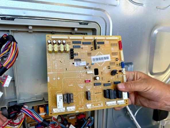

  8. Samsung Older French Door Refrigerator Main Control Board Replacement, Remove the control board: step 8, image 1 of 2 Samsung Older French Door Refrigerator Main Control Board Replacement, Remove the control board: step 8, image 2 of 2
    • Remove the control board from the chassis.
