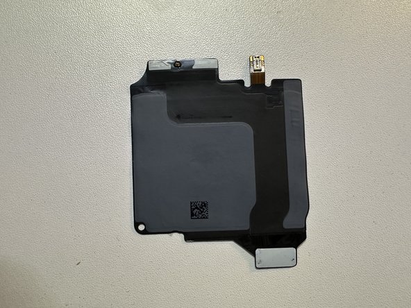

  4. Samsung Galaxy Z Flip 4 Display Replacement, Disconnect Main Battery & Charging Coil: step 4, image 1 of 3 Samsung Galaxy Z Flip 4 Display Replacement, Disconnect Main Battery & Charging Coil: step 4, image 2 of 3 Samsung Galaxy Z Flip 4 Display Replacement, Disconnect Main Battery & Charging Coil: step 4, image 3 of 3
    • Unscrew the cover that covers the main battery and wireless coil connectors.
    • Disconnect the connectors and remove the charging coil.

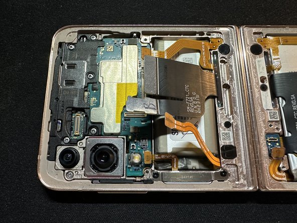

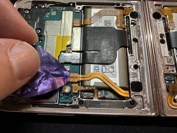

  5. Samsung Galaxy Z Flip 4 Display Replacement, Disconnect Secondary Battery: step 5, image 1 of 3 Samsung Galaxy Z Flip 4 Display Replacement, Disconnect Secondary Battery: step 5, image 2 of 3 Samsung Galaxy Z Flip 4 Display Replacement, Disconnect Secondary Battery: step 5, image 3 of 3
    • Remove the two screws holding the cover for all connectors on the motherboard.
    • Disconnect the battery and all other connectors.

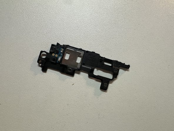

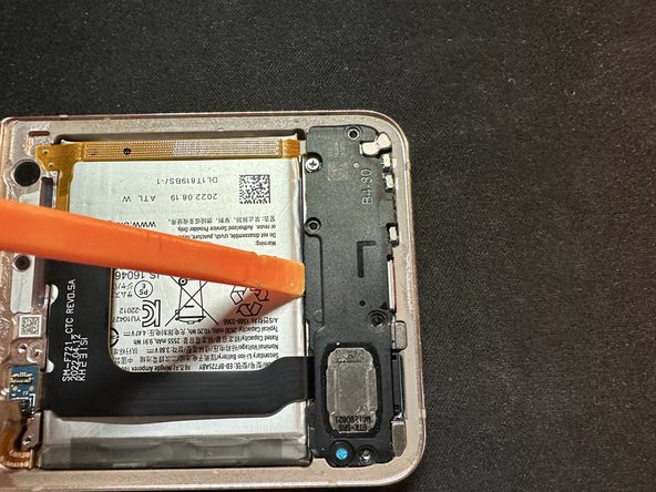

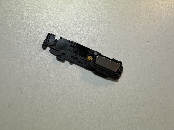

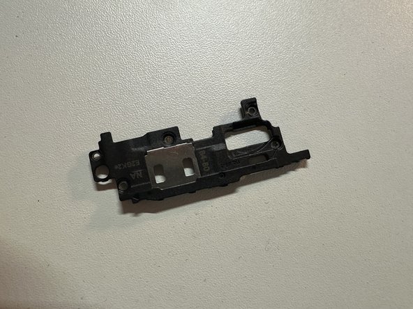

  6. Samsung Galaxy Z Flip 4 Display Replacement, Remove Speaker Assembly: step 6, image 1 of 3 Samsung Galaxy Z Flip 4 Display Replacement, Remove Speaker Assembly: step 6, image 2 of 3 Samsung Galaxy Z Flip 4 Display Replacement, Remove Speaker Assembly: step 6, image 3 of 3
    • Remove the 4 screws holding the speaker cover in place.
    • Lift it with a spudger to remove it.

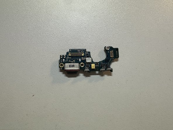

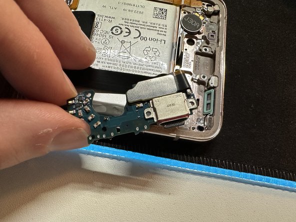

  7. Samsung Galaxy Z Flip 4 Display Replacement, Remove Charging Sub-Board: step 7, image 1 of 3 Samsung Galaxy Z Flip 4 Display Replacement, Remove Charging Sub-Board: step 7, image 2 of 3 Samsung Galaxy Z Flip 4 Display Replacement, Remove Charging Sub-Board: step 7, image 3 of 3
    • Disconnect the two cables on the top of the charging sub-board.
    • Remove the two remaining screws holding the board in place.
    • Before you can remove it, flip it over and remove the last remaining connection to the display assembly.
  8. Samsung Galaxy Z Flip 4 Display Replacement, Remove top Cover: step 8, image 1 of 3 Samsung Galaxy Z Flip 4 Display Replacement, Remove top Cover: step 8, image 2 of 3 Samsung Galaxy Z Flip 4 Display Replacement, Remove top Cover: step 8, image 3 of 3
    • Remove the 5 screws holding the top cover and remove it with a spudger.

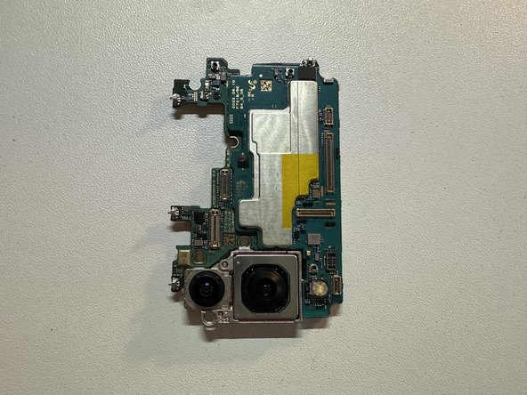

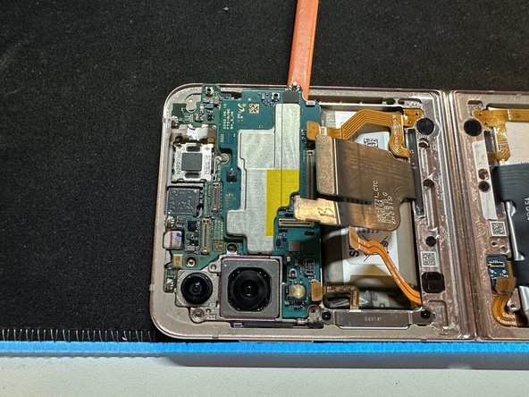

  9. Samsung Galaxy Z Flip 4 Display Replacement, Remove Logic Board: step 9, image 1 of 3 Samsung Galaxy Z Flip 4 Display Replacement, Remove Logic Board: step 9, image 2 of 3 Samsung Galaxy Z Flip 4 Display Replacement, Remove Logic Board: step 9, image 3 of 3
    • Unscrew the last screw holding in the logic board, next to the cameras.
    • Remove the SIM tray
    • Lift out the logic board with a spudger.

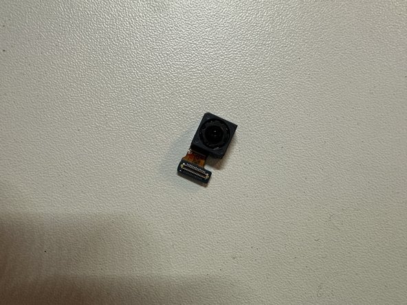

  10. Samsung Galaxy Z Flip 4 Display Replacement, Remove Front Camera: step 10, image 1 of 2 Samsung Galaxy Z Flip 4 Display Replacement, Remove Front Camera: step 10, image 2 of 2
    • This can be a little tricky since the camera is glued in.
    • Heat up the display where the front camera is located
    • Try lifting the camera out with tweezers.

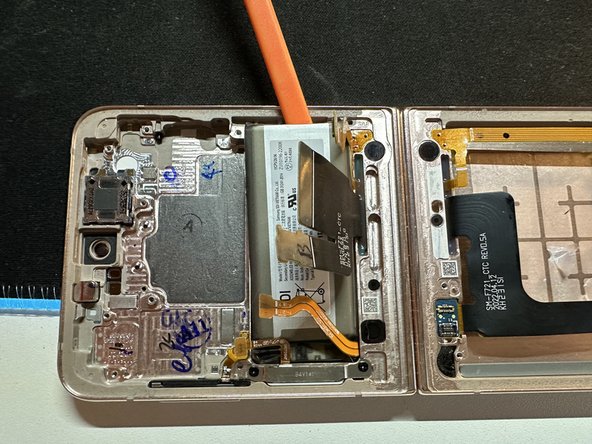

  11. Samsung Galaxy Z Flip 4 Display Replacement, Remove Batteries: step 11, image 1 of 2 Samsung Galaxy Z Flip 4 Display Replacement, Remove Batteries: step 11, image 2 of 2
    • Use isopropyl alcohol to loosen the adhesive on the battery. Pour some Isoprop into the space between the battery and the frame.
    • Wait about 30 to 60 seconds for the alcohol to work, then lift the battery with a spudger.
    • Repeat the same procedure for the secondary battery.
