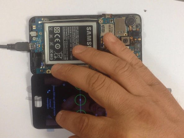

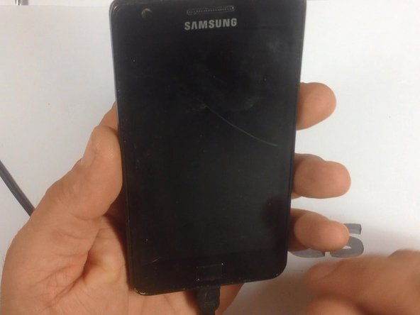

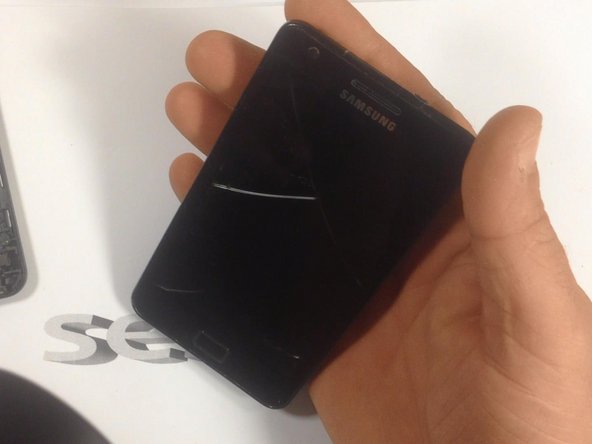

  1. We have a Samsung Galaxy S II with broken screen. We have a Samsung Galaxy S II with broken screen.
    • We have a Samsung Galaxy S II with broken screen.

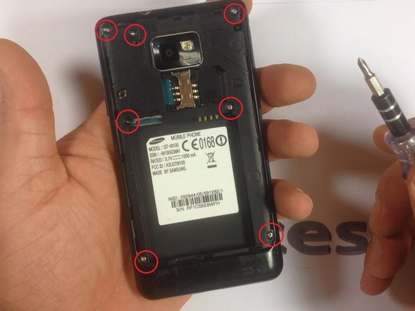

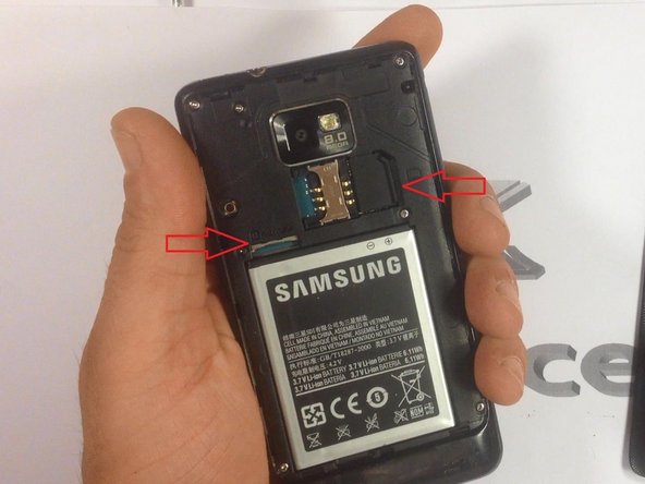

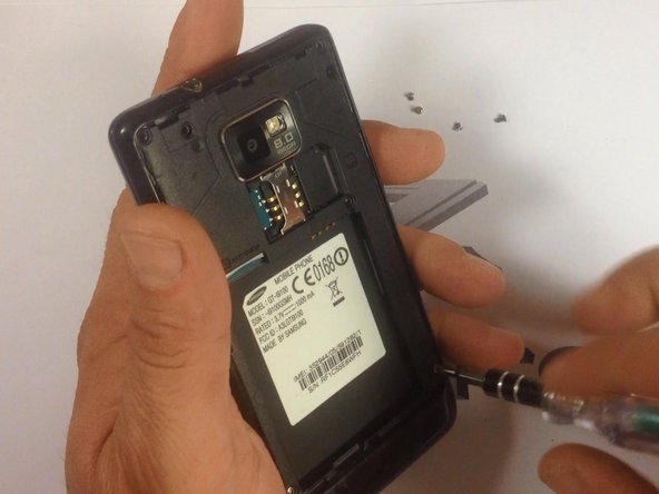

  2. Remove your battery, the SIM card and the SD card. Remove the 7 screws highlighted in red. Remove the 7 screws highlighted in red.
    • Remove your battery, the SIM card and the SD card.
    • Remove the 7 screws highlighted in red.

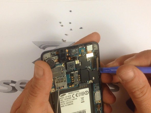

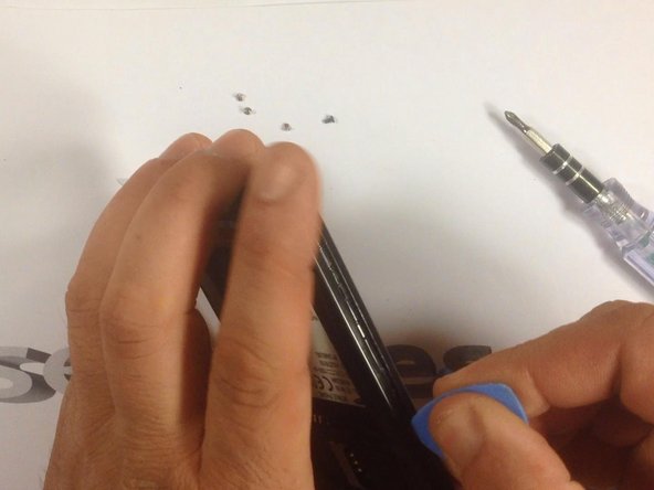

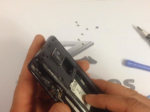

  3. Use a plastic tool to remove the rear housing. Use a plastic tool to remove the rear housing. Use a plastic tool to remove the rear housing.
    • Use a plastic tool to remove the rear housing.

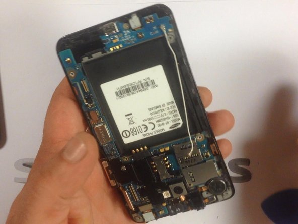

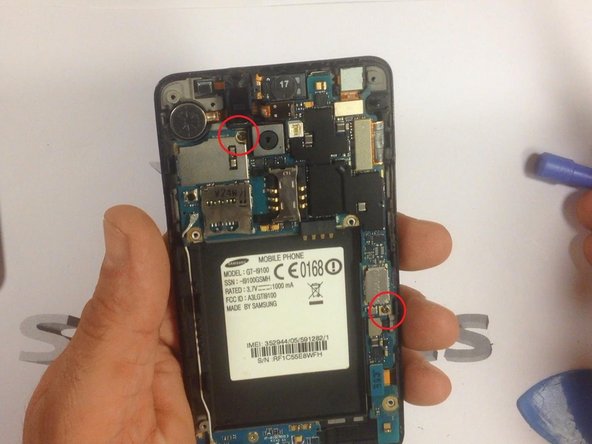

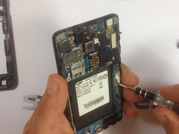

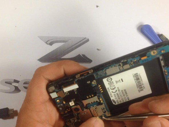

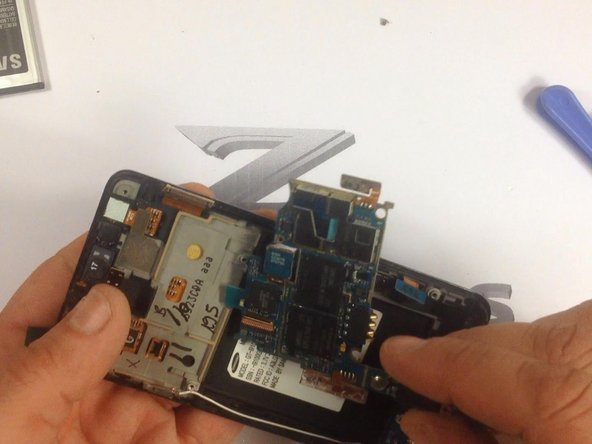

  4. The mother board is held by 2x screws. Remove them. The mother board is held by 2x screws. Remove them.
    • The mother board is held by 2x screws. Remove them.

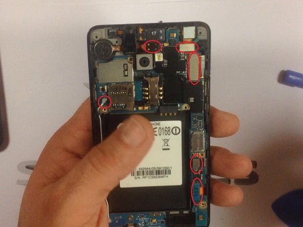

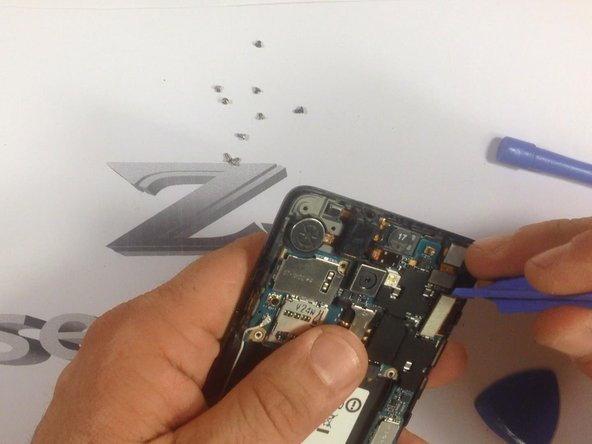

  5. Remove the cables that are highlighted in red, before continuing to the screen. Remove the cables that are highlighted in red, before continuing to the screen. Remove the cables that are highlighted in red, before continuing to the screen.
    • Remove the cables that are highlighted in red, before continuing to the screen.

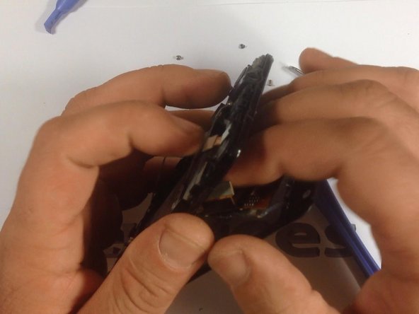

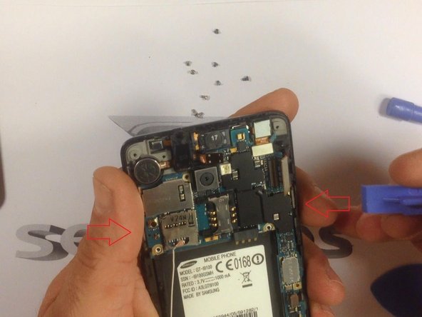

  6. Release the side buttons. The arrow will point you to where they are. Release the side buttons. The arrow will point you to where they are. Release the side buttons. The arrow will point you to where they are.
    • Release the side buttons. The arrow will point you to where they are.

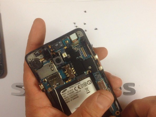

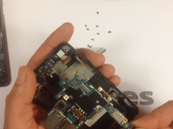

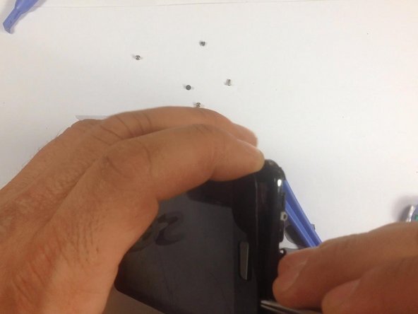

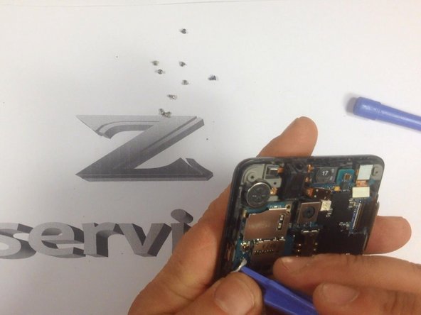

  7. Careful release the motherboard from it's housing. Careful release the motherboard from it's housing.
    • Careful release the motherboard from it's housing.

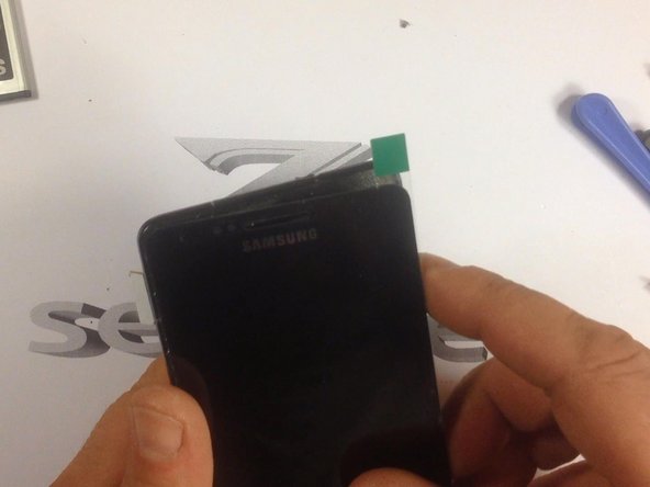

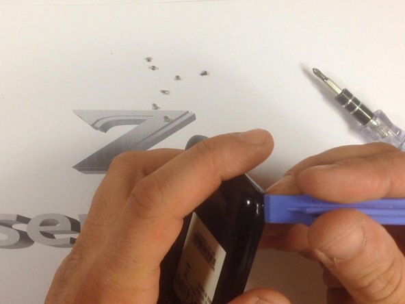

  8. At this moment if you have touch screen with LCD and frame like spare part you are ready for replacing. We will continue with disassembling LCD and Touch from the frame. Now preheat it before removing!
    • At this moment if you have touch screen with LCD and frame like spare part you are ready for replacing.
    • We will continue with disassembling LCD and Touch from the frame. Now preheat it before removing!
    • Use a hot air to soften the adhesive enough to remove the glass.

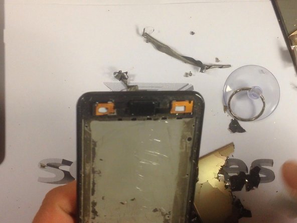

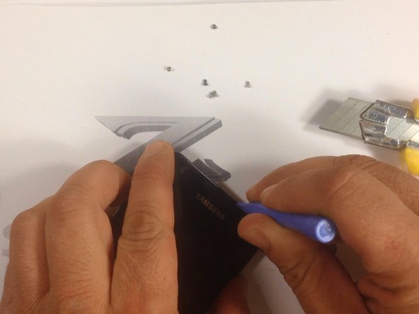

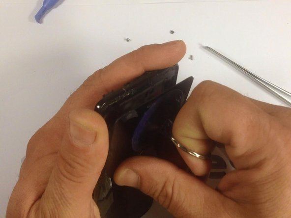

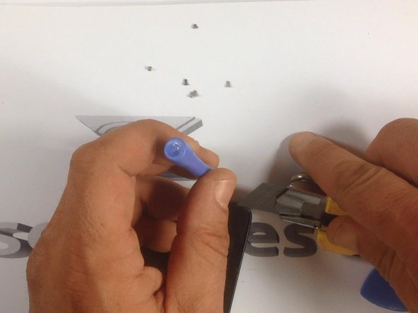

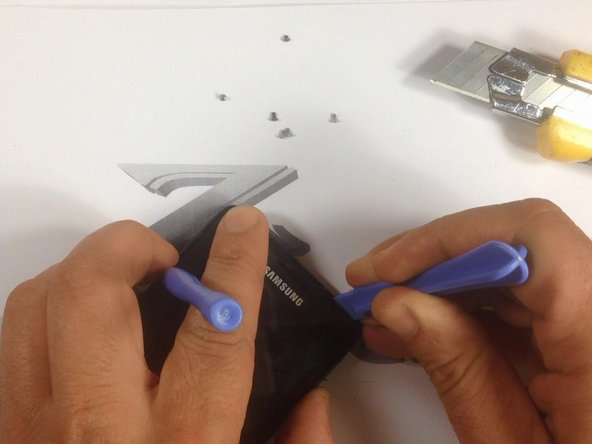

  9. With a cutter, make a room for a plastic tool, then continue with separating the Touchscreen & LCD Display from the frame. With a cutter, make a room for a plastic tool, then continue with separating the Touchscreen & LCD Display from the frame. With a cutter, make a room for a plastic tool, then continue with separating the Touchscreen & LCD Display from the frame.
    • With a cutter, make a room for a plastic tool, then continue with separating the Touchscreen & LCD Display from the frame.

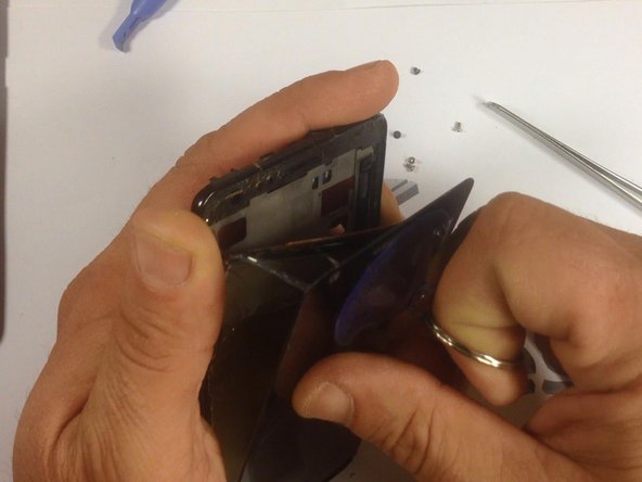

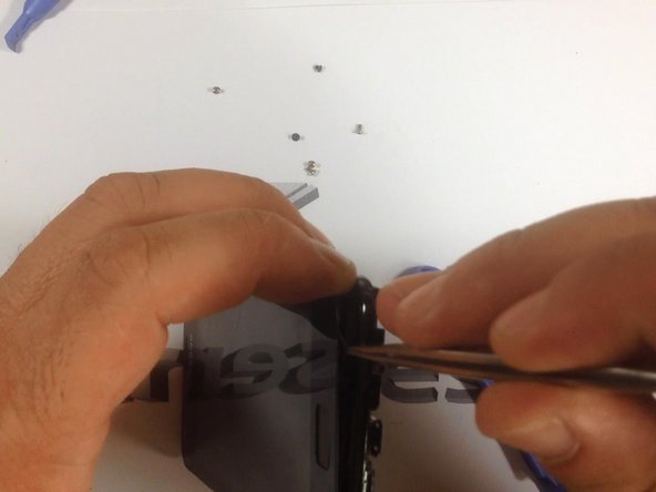

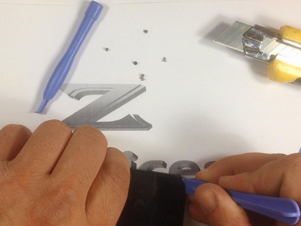

  10. Be careful with the menu buttons flex cable in the bottom side of the touchscreen. You must release it before separating the digitizer from the frame. Be careful with the menu buttons flex cable in the bottom side of the touchscreen. You must release it before separating the digitizer from the frame. Be careful with the menu buttons flex cable in the bottom side of the touchscreen. You must release it before separating the digitizer from the frame.
    • Be careful with the menu buttons flex cable in the bottom side of the touchscreen. You must release it before separating the digitizer from the frame.

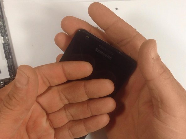

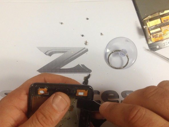

  11. Now, use a suction tool to remove the screen from it's housing. Be careful when doing this, to prevent possible injury. Now, use a suction tool to remove the screen from it's housing. Be careful when doing this, to prevent possible injury. Now, use a suction tool to remove the screen from it's housing. Be careful when doing this, to prevent possible injury.
    • Now, use a suction tool to remove the screen from it's housing. Be careful when doing this, to prevent possible injury.

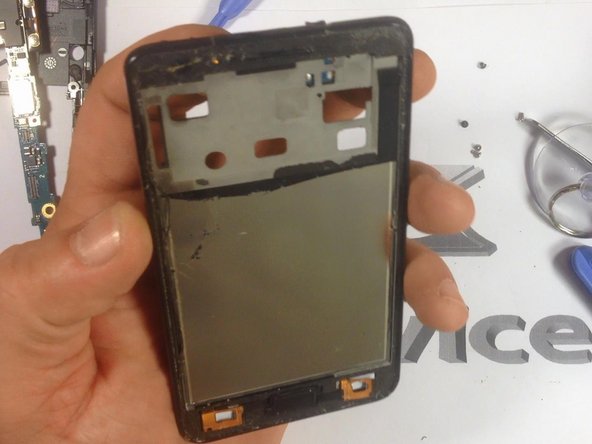

  12. Clean the frame from the remains of tape. Clean the frame from the remains of tape. Clean the frame from the remains of tape.
    • Clean the frame from the remains of tape.

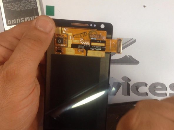

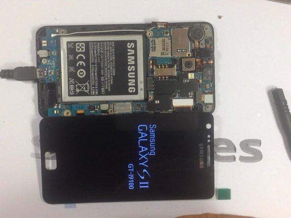

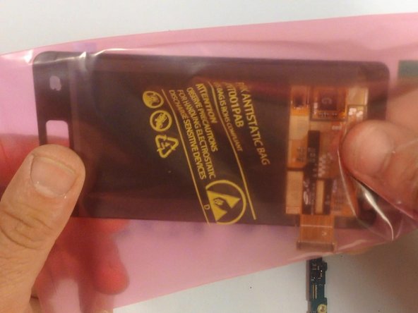

  13. Test the new spare part before reassembling. Test the new spare part before reassembling. Test the new spare part before reassembling.
    • Test the new spare part before reassembling.

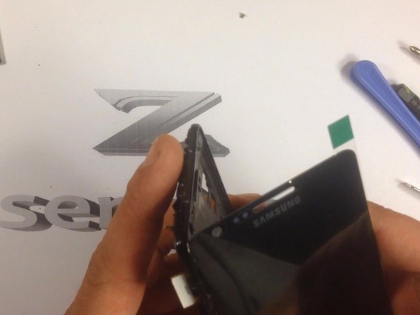

  14. Install the LCD&Digitiser on it's housing. Many times the spare parts come without adhesive tape. In this situation you'll need to install double sided adhesive tape yourself. Also you can easy find adhesive sticker exactly for the model. Many times the spare parts come without adhesive tape. In this situation you'll need to install double sided adhesive tape yourself. Also you can easy find adhesive sticker exactly for the model.
    • Install the LCD&Digitiser on it's housing.
    • Many times the spare parts come without adhesive tape. In this situation you'll need to install double sided adhesive tape yourself. Also you can easy find adhesive sticker exactly for the model.

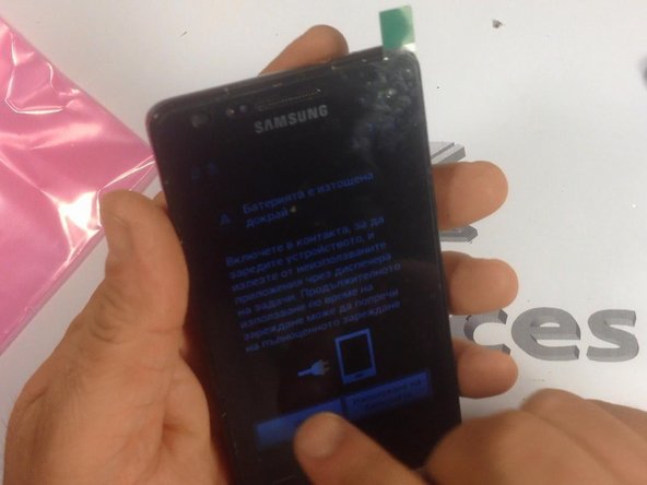

  15. To reassemble your device, follow these instructions in reverse order. To reassemble your device, follow these instructions in reverse order. To reassemble your device, follow these instructions in reverse order.
    • To reassemble your device, follow these instructions in reverse order.
