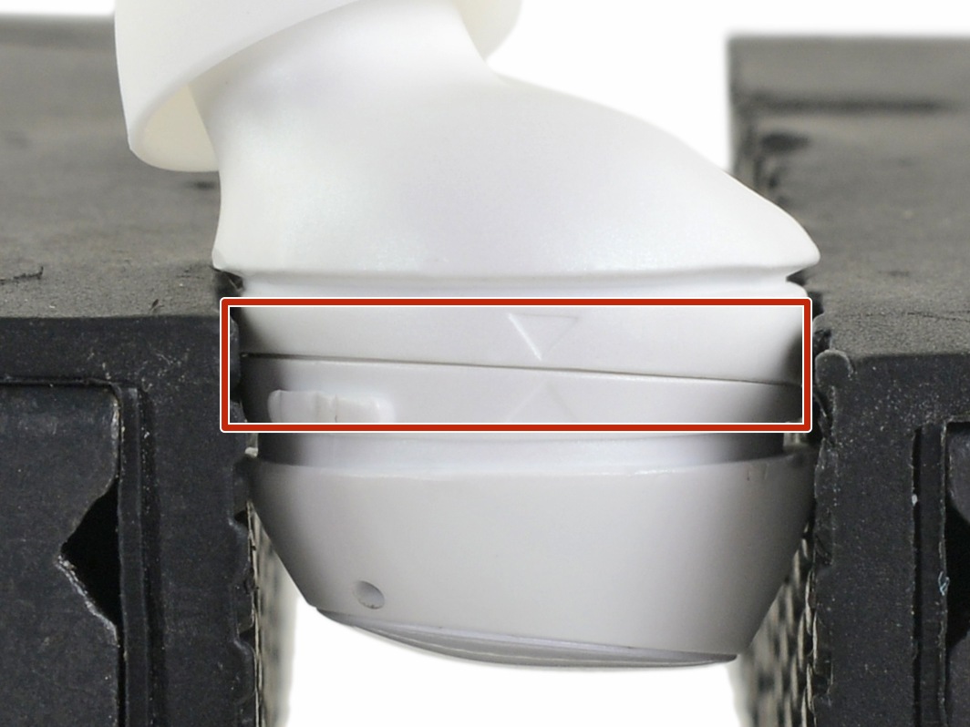

  2. Samsung Galaxy Buds Battery Replacement, Opening up the earbud: step 2, image 1 of 3 Samsung Galaxy Buds Battery Replacement, Opening up the earbud: step 2, image 2 of 3 Samsung Galaxy Buds Battery Replacement, Opening up the earbud: step 2, image 3 of 3
    • Place the bud horizontally into a rubber-guarded vice or a pair of blunt pliers.
    • Apply steady, even pressure to either side of the bud along the main housing seam (the seam between the two arrows). The pressure should break the seal.
    • Only apply enough pressure to create a small gap between the two halves of the bud. If you use pliers, put a cloth between the pliers and the buds to prevent the teeth from digging into the soft plastic.

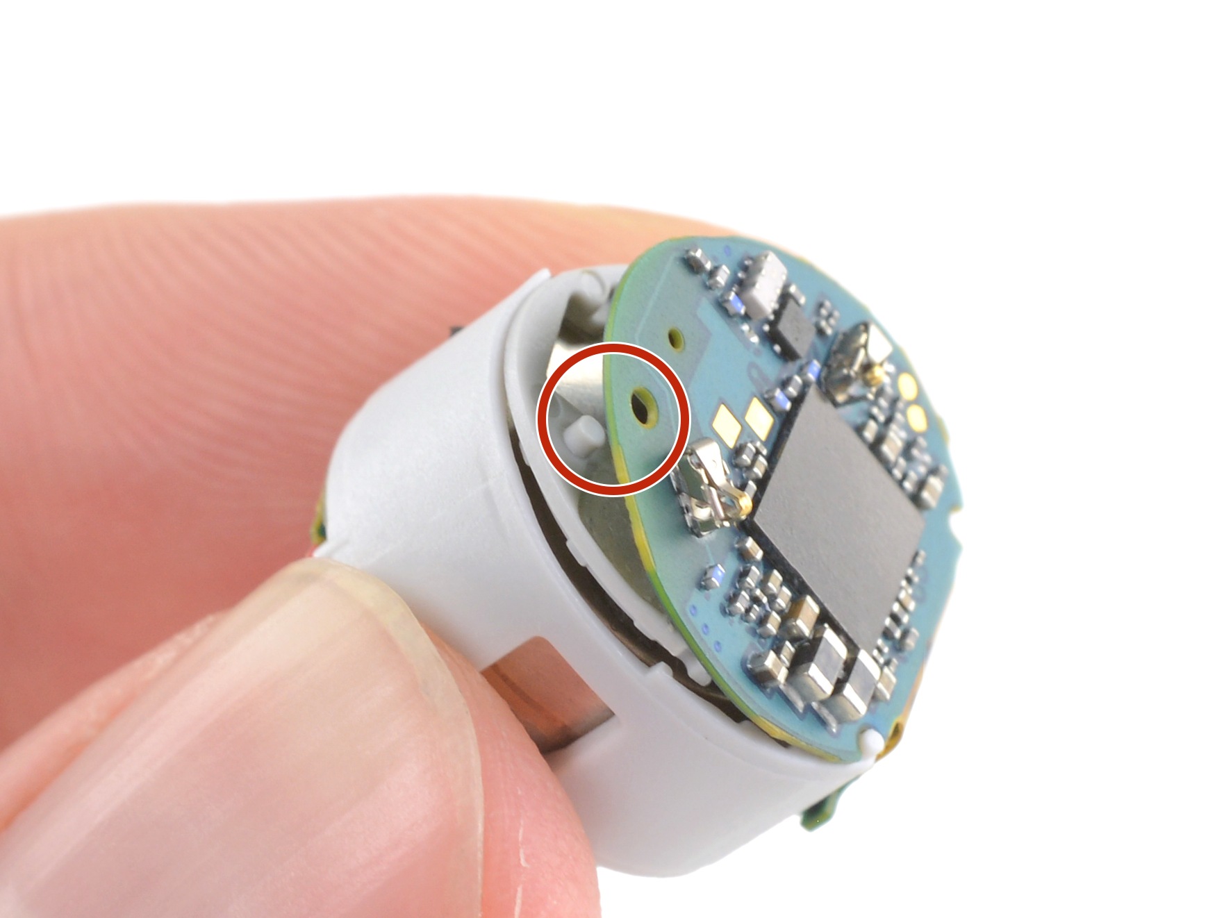

  9. Samsung Galaxy Buds Battery Replacement, Removing the battery: step 9, image 1 of 3 Samsung Galaxy Buds Battery Replacement, Removing the battery: step 9, image 2 of 3 Samsung Galaxy Buds Battery Replacement, Removing the battery: step 9, image 3 of 3
    • The bottom of the battery housing has holes, which allow you to push the battery out. The flat side of a spudger fits perfectly through the widest opening, marked here in red.
    • Insert the flat end of a spudger (or another plastic prying tool) into the bottom of the battery housing and push the battery out the other side.
